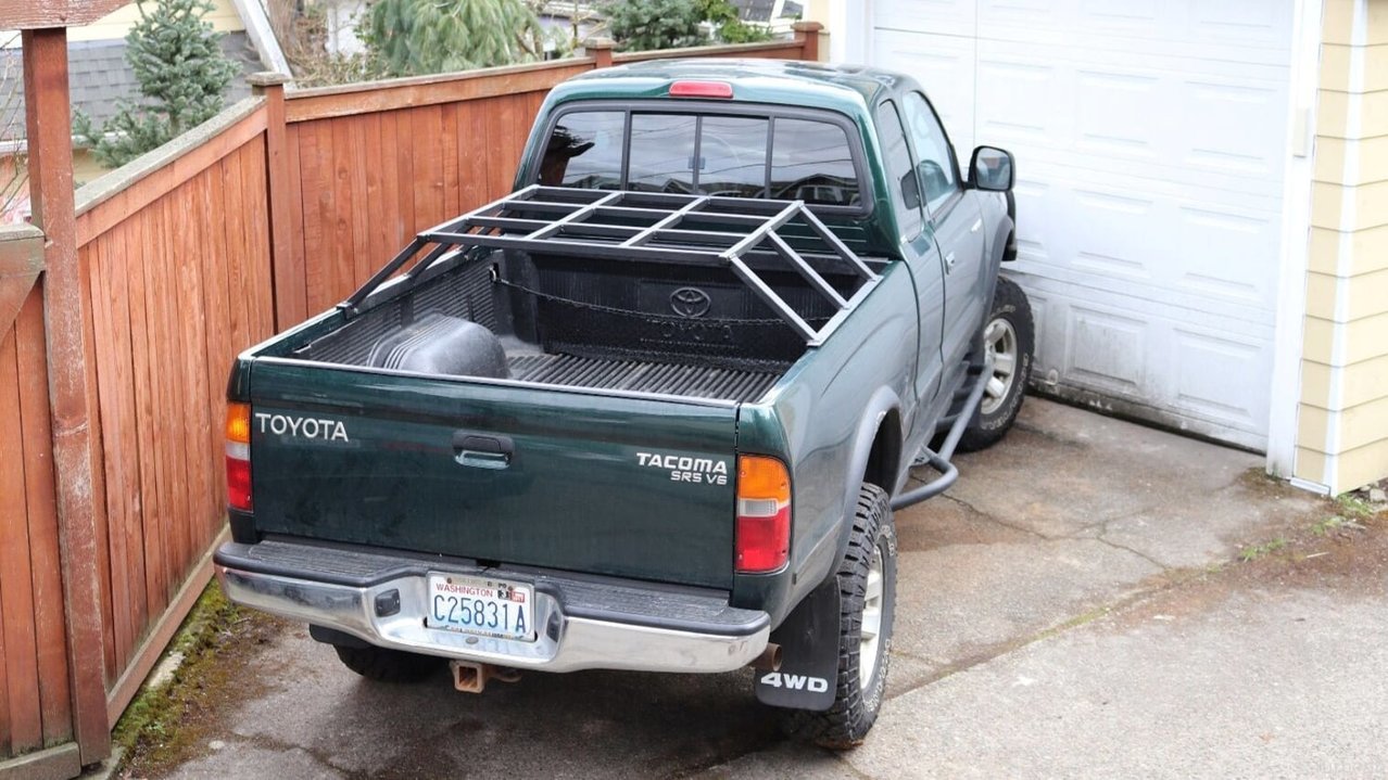

    Well, I finally jumped in and got my bed rack written up for my RTT (a CVT Mt. Shasta that I still need to write up). Was my first foray into welding so took a bit longer than it probably needed to, and of course it took me forever to actually write it up, but it turned out pretty nice. Thanks to @Box Rocket for the rack inspiration!
    Building the Bed Rack (did someone say "new tools"?)
