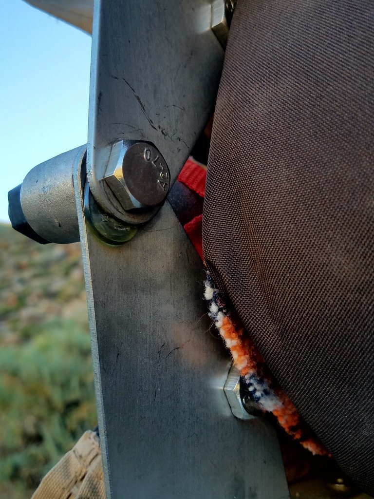

    I upgraded my Smittybilt hardware to class 10.9 bolts and genuine nylock nuts with a dab of blue locktite.
    I also replaced the flat mounting bar with something a little better designed.20170611_195250.jpg

    Did you make that new mounting bar yourself? I really hate the flat bars that came with my tent.

    Got them from mckenzirs.com, they have an entire wall full of all sorts of different tabs and what not that you can choose from. I spent the whole day trying to find something, there were so many...
    Also make sure that these bolts and nuts get replaced as well, the middle one was finger loose, then to tight from my paws from how that washer got compressed. This was the tipping point in deciding to replace all of the mounting hardware. The nylock nuts that are supplied suck ass and was the main culprit why everything wouldnt stay tight.

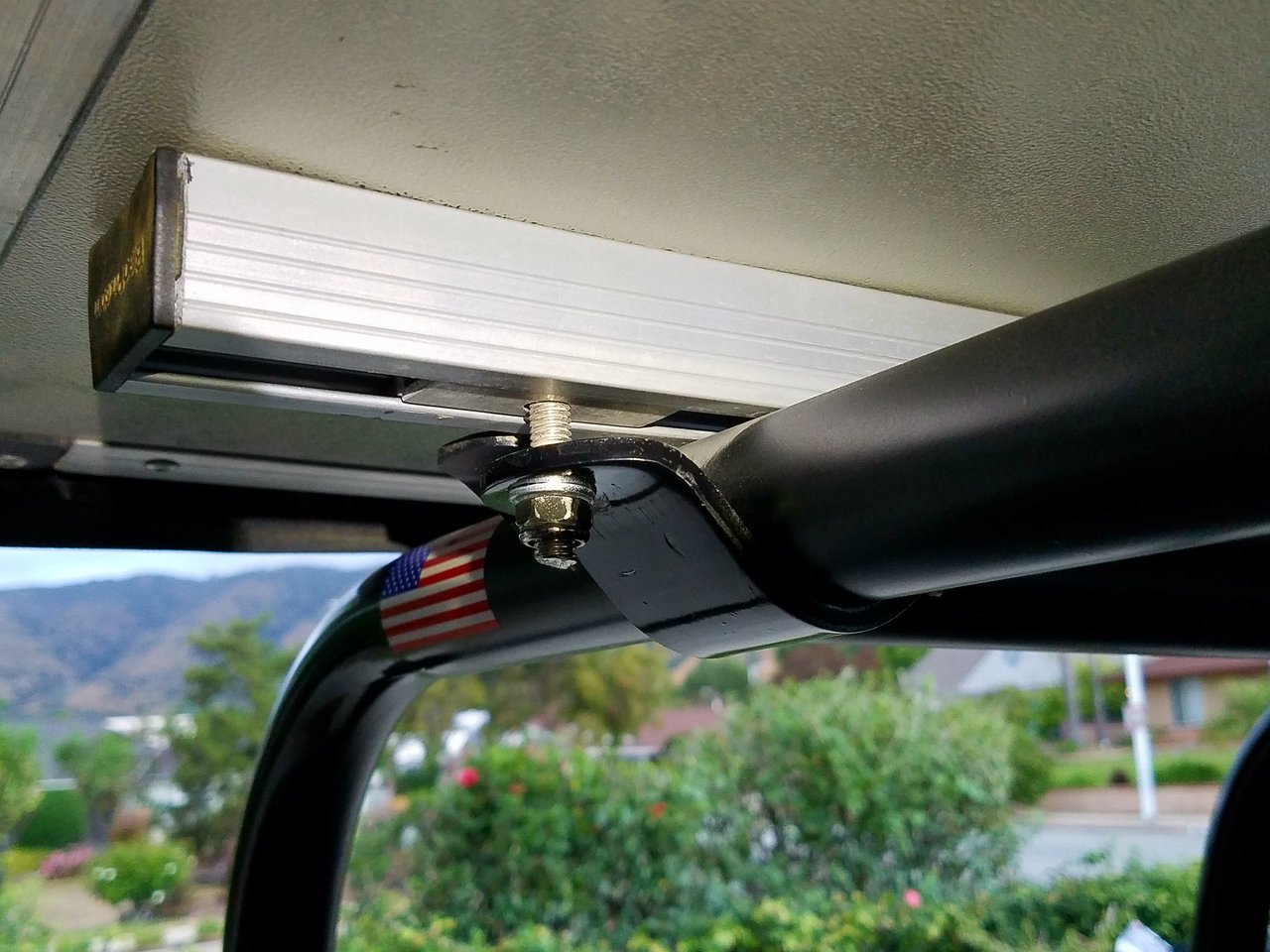

    My buddy has the HD. I know he had a lot of figuring to do about the max weight load the cap could handle. It's braced on the inside from the bottom of the cap to the bed rails I think

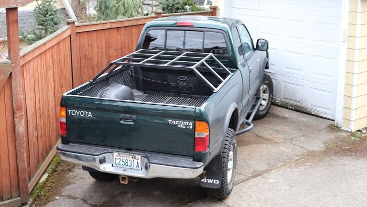

    A while back I posted about the bed rack I built for my RTT based on Box Rocket's design. At the time, several asked if I was making more, and I wasn't. Now I am. Feel free to PM if you're interested.

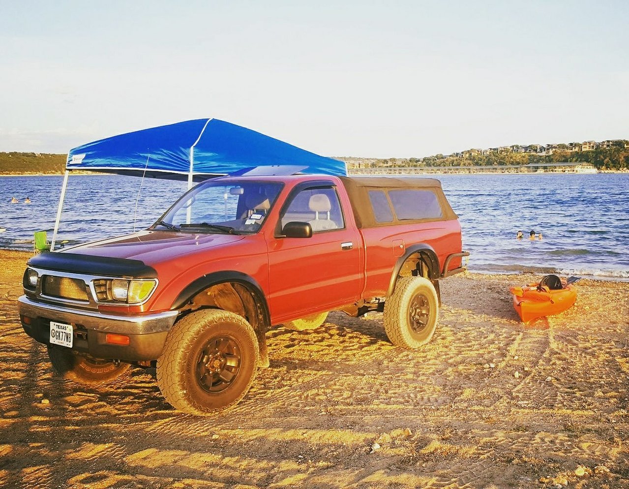

    just ordered a RTT & Annex looking to acquire or build a rack over my Soft top. Anyone who has done this before, insight would be appreciated
