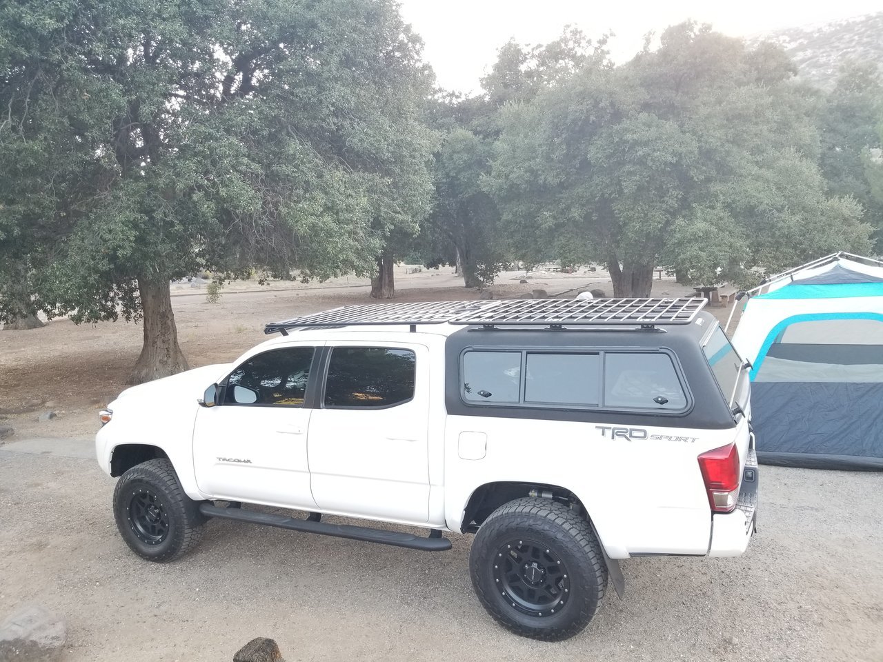

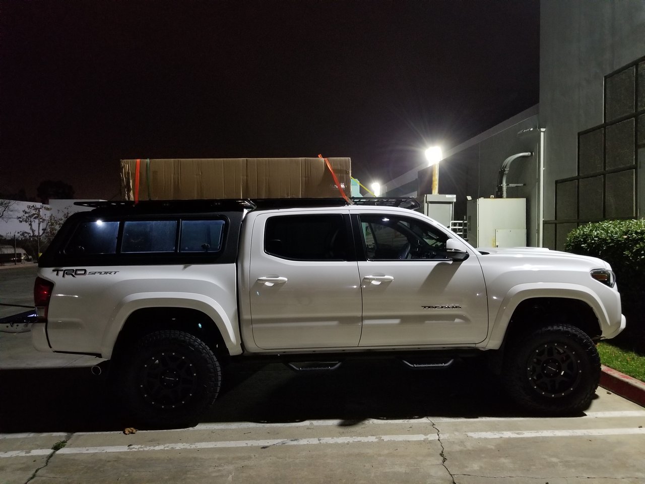

    Hey guys, new to the RTT forum and just wanted to share my first pictures and had a couple questions. One being do you guys leave your tent on your truck most of the time? Thinking it would be a PITA to take on and off. And secondly, should I mount it mostly over camper or mostly over truck roof?
    Tent: Smittybilt Overlander XL.
    Camper: ARE Overlander V series
    Roof racks: Bajarack front and rear flat racks with RTT flat plate attachments.
    And hopefully ordering soon Smittybilt annex to match tent. 20171012_170848.jpg 20171128_192215.jpg 20171128_192148.jpg

    I don't have a RTT but you shouldn't mount anything to both the bed & cab. The bed & cab flex independently from each other & if you mount anything between the two it will get damaged more than likely. It could also damage your cap.

    I have the same racks. Not sure of tent size, but I’d put it over the camper without any overhang to the cab. If you have to go over the cab a bit, make sure you have enough gap between cab rack and tent floor for body flex. Nice thing about the BajaRack on the camper is you can adjust the height if necessary to give you that gap.

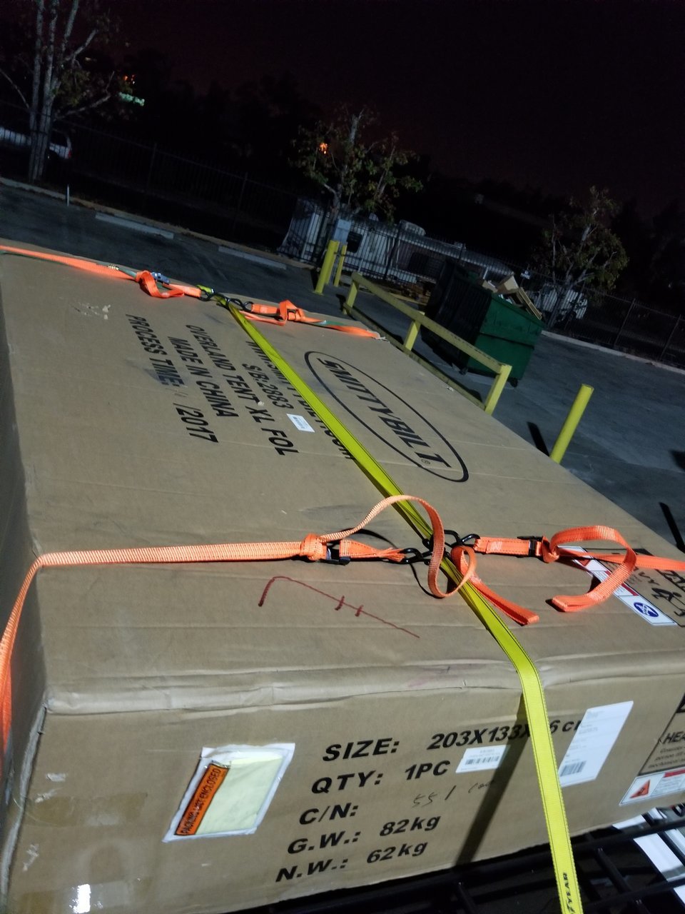

    . Good idea. Thanks for the tip. Well crap I just went out and measured the rear camper rack and then the front roof rack and there is no way this tent is going to fit one independently. Again this is a 72" length and I didn't take flex into consideration. Looks like I might have to sell this one and get a shorter one maybe?
