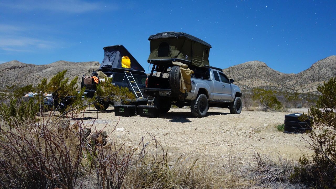

    Want to know if anyone has built a bed rack for a 4-5 man roof top tent? I have a 2015 double cab with the 5ft bed. The tent I'm looking at purchasing is 79x48 collapsed. Just wondering if anyone has built something for this set up or if I'm on my own. Thanks

    79" on a 60" bed?
    My tent is 7" longer than a long bed

    The whole reason i went with my bed rack. The roof rack and top of tent are now level

    Wait. Dual rack? I have a bed rack, and a Prinsu

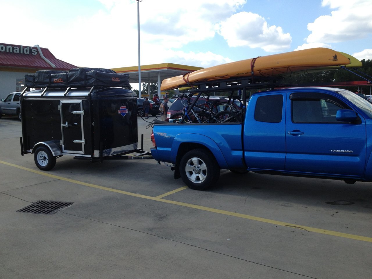

    POOLGUY
    POOLGUY Well-Known Member
    Feb 19, 2013
    #97958
    11,284
    JEFF
    ALABAMA
    2008 TRD Sport 6sp, 2015 TRD Offroad 6sp
    Dobinsons suspension
    A fab shop could build you a custom rack that will support your tent. That's what I did. I wanted a rack that fit my personal and work needs.image.jpg
