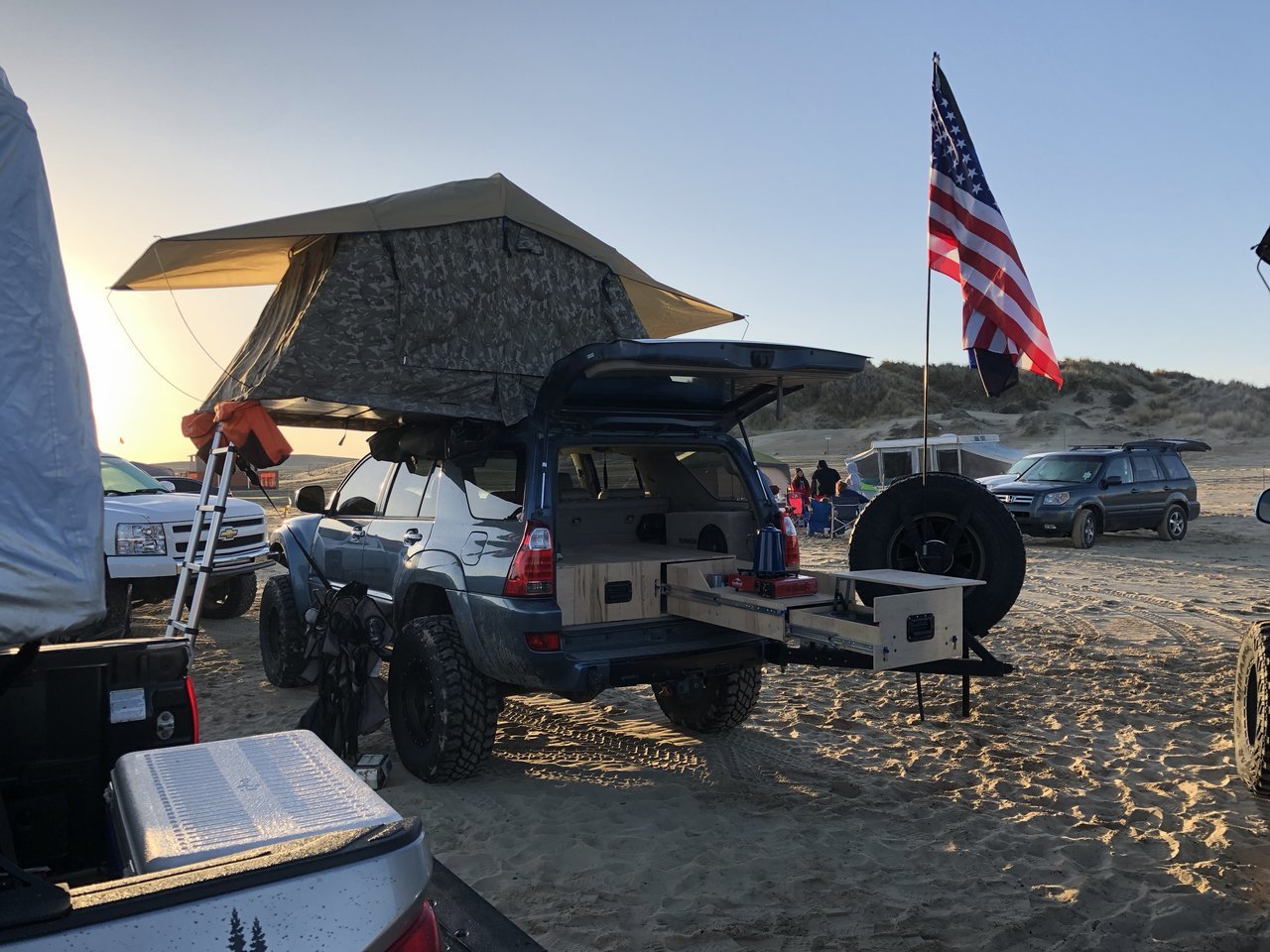

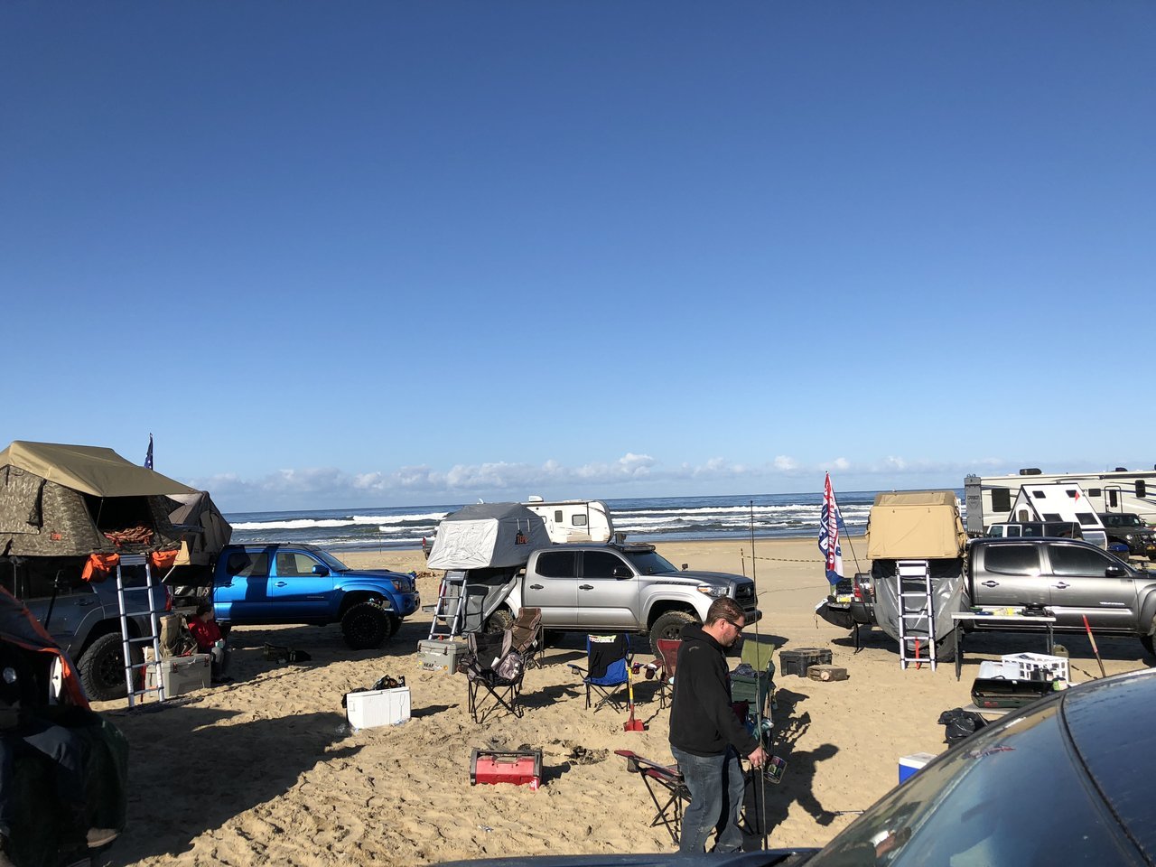

    Went out to Pismo this weekend.

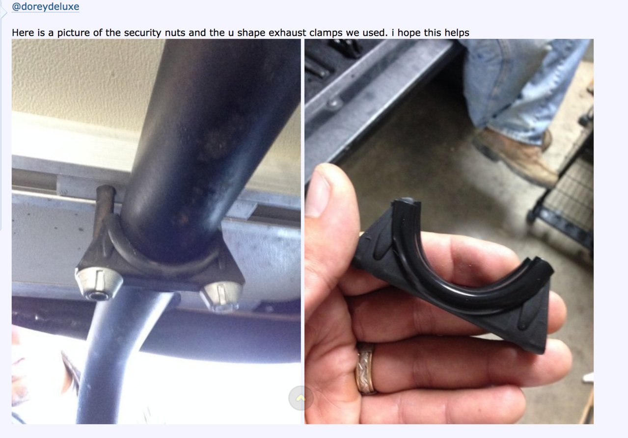

    Hey all - So, i have a CVT Mt. Rainier. I mount it to a custom bed rack that is made from 2" DOM tubing. I've always just mounted the mounting plates around the tubing and tightened it down so that the mounting plates bend a little. That's done just fine for the last few years. Noticed today when i was putting my RTT back on the rack that the mounting plates are showing some signs of wear. There are some stress cracks from the slight bending around the DOM tubing... I'm planning on replacing the mounting plates, so wanted to see if anyone had any good solutions for mounting around tubing like this. I know some people have used U bolts, but have had issues with the RTT sliding.
    I came across these Yakima universal snap arounds, which would be a cool solution, but i don't think they'd be wide enough for my rack. I think they are meant for smaller diameter tubing...
    Any ideas or solutions that you guys have seen or are using?

    exhaust clamps

    Anyone have pics on how they've used exhaust clamps to mount their RTT?
    I actually came across these, which i think would fit the bill for me. it would prevent the mounting plates from being bent around the tube and seems like they'd be plenty strong.

    ohhhh! i see now. that's not what i was thinking of when i thought of exhaust clamps. That is exactly what i need! thanks guys!!

    Here's another version of this idea I saw on here somewhere. They used door trim to protect the crossbar:

    You can also use Kydex.
    Cut it to size, heat it up and shape it to the bars!
