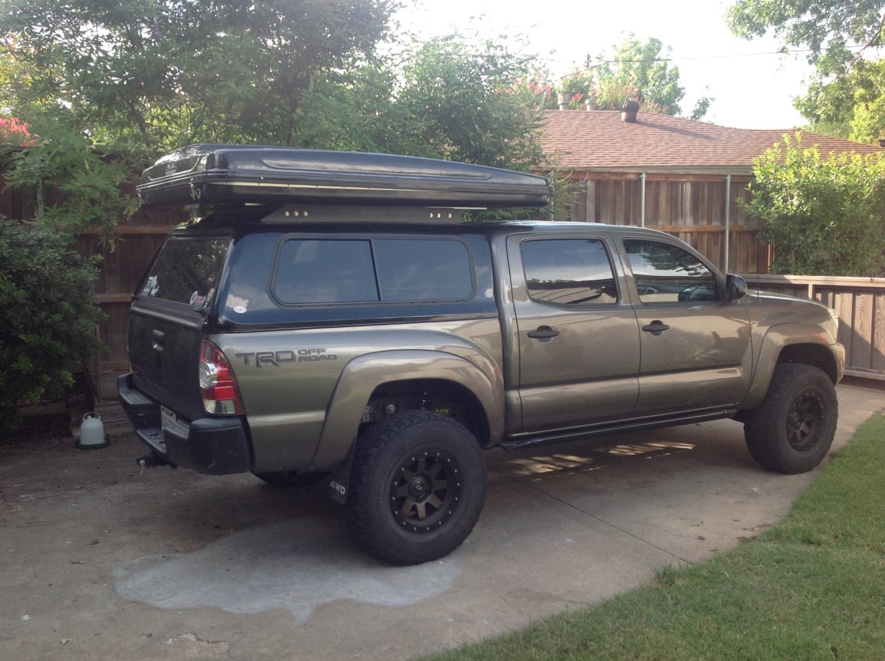

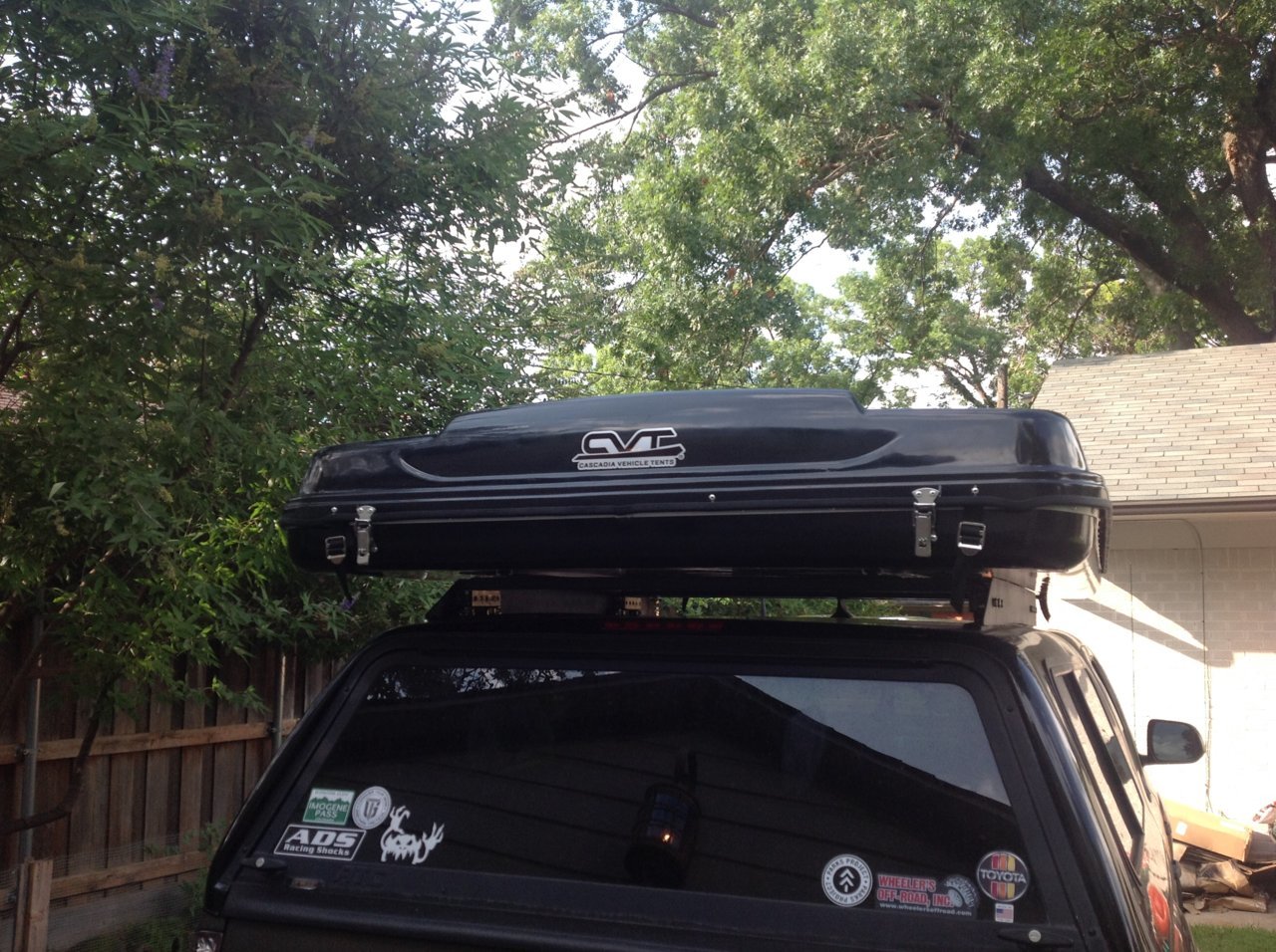

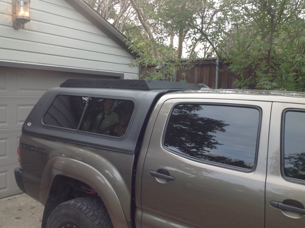

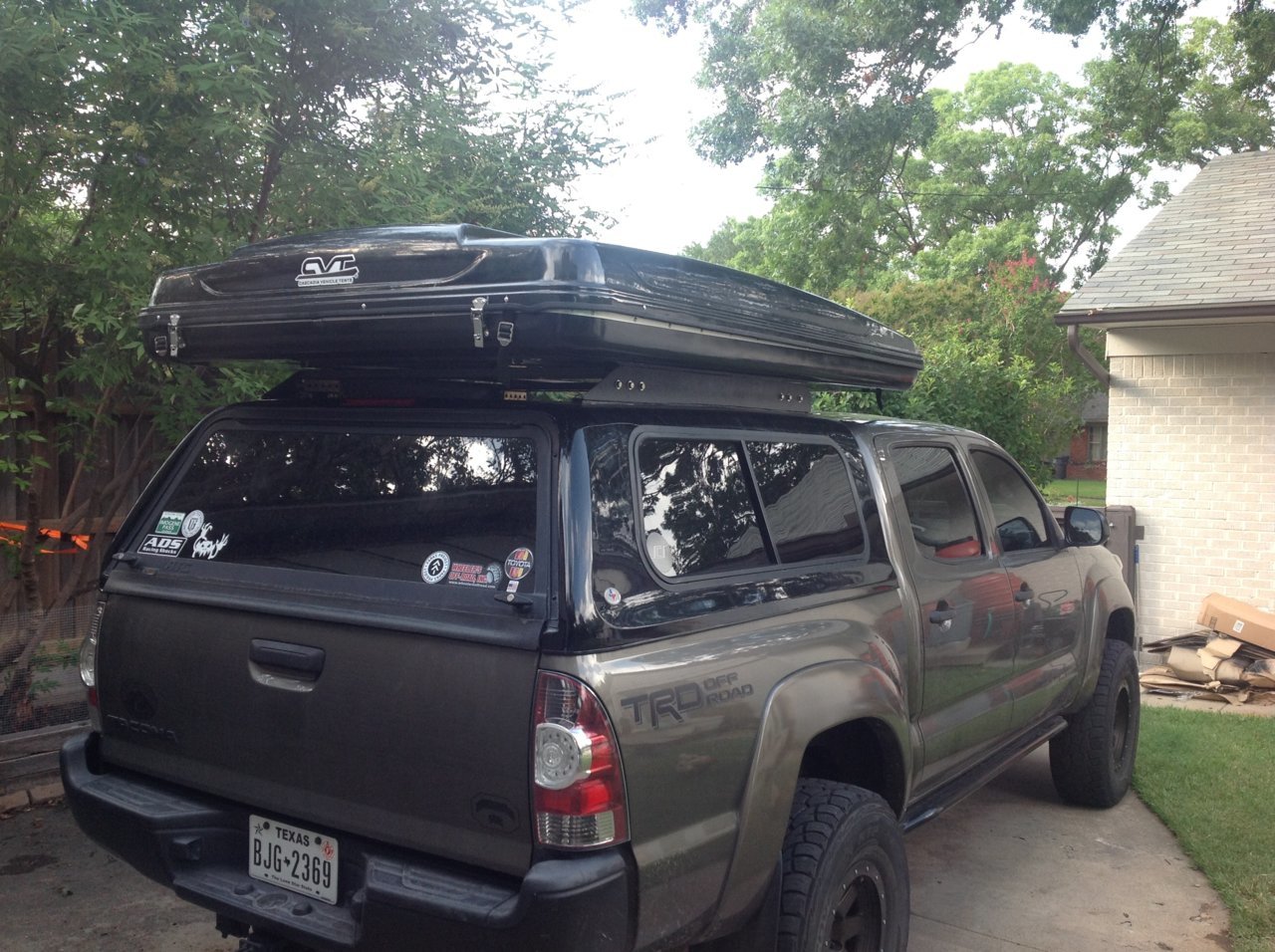

    image.jpg image.jpg image.jpg image.jpg image.jpg Here's mine. Homemade rack and bars. L track mounted to shell, uni strut mounted to locking L track load keepers (removable) used as risers, then (4) 1 inch sq tubing mounted to risers. All but the L track is removable, if I ever needed to.

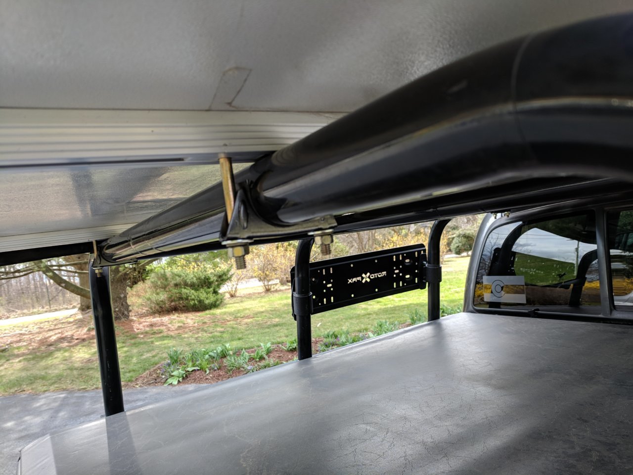

    Is your topper reinforced? Or came rated for higher weights from factory ?

    DIY reinforced. I made a cage for it.

    Wow! That’s awesome.
