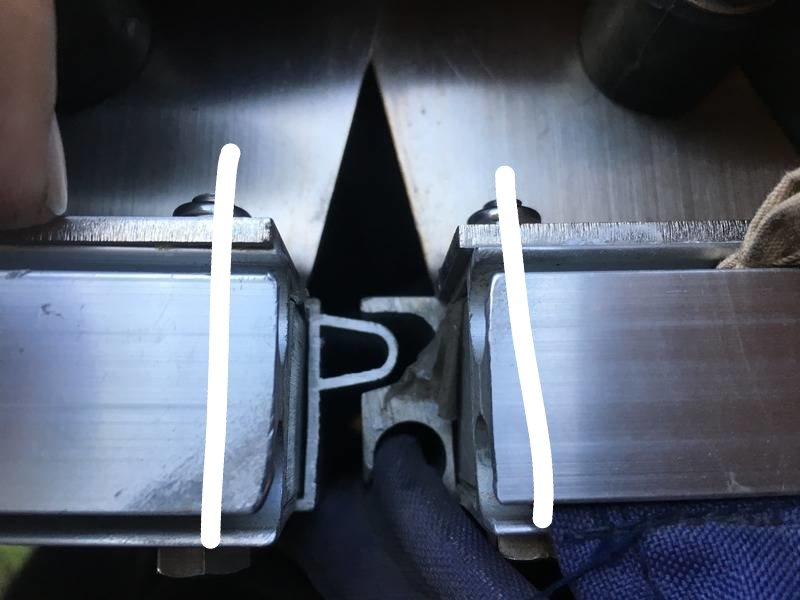

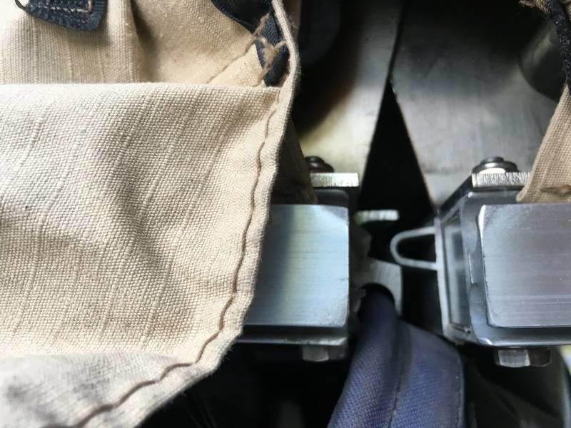

    Anyone have issues with your tent coming apart at night? Like when I flip it over, the tent doesn’t sit evenly and lock in the tongue and groove that well. One side works fine but the other barely fits in there. A few times in the middle of the night it felt like my tent was going to fall apart. You can see the difference in the pics below. The only thing I can think of is the hinges weren’t installed evenly...

  3. Jul 6, 2018 at 12:26 AM
    MonkeyProof
    MonkeyProof Power Top
    Oct 7, 2008
    #9774
    12,851
    SoCal- SGV
    I push on both corners to help lock it all into place every time I open mine up.

    That’s a good idea. I could probably do the same but hook it to the roof racks to be more out of the way. Thanks.

    My tent did the same thing. Loosen the hinge bolts, push the tongue into the groove, and retighten.
    The straps to hold it open help other things but won't fix this.
