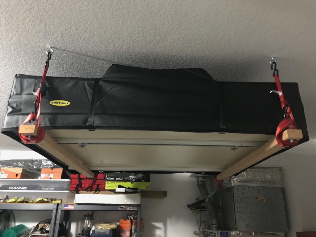

    $20 trip to Home Depot...works like a charm.

    You have a pic of it stored on that?

    No problem! I was all set to pull the trigger on one of those fancy and expensive hoists, then a couple beers asked me "Why are you overthinking this, bro?" :devil:
    I will tonight...still on my truck from the weekend.

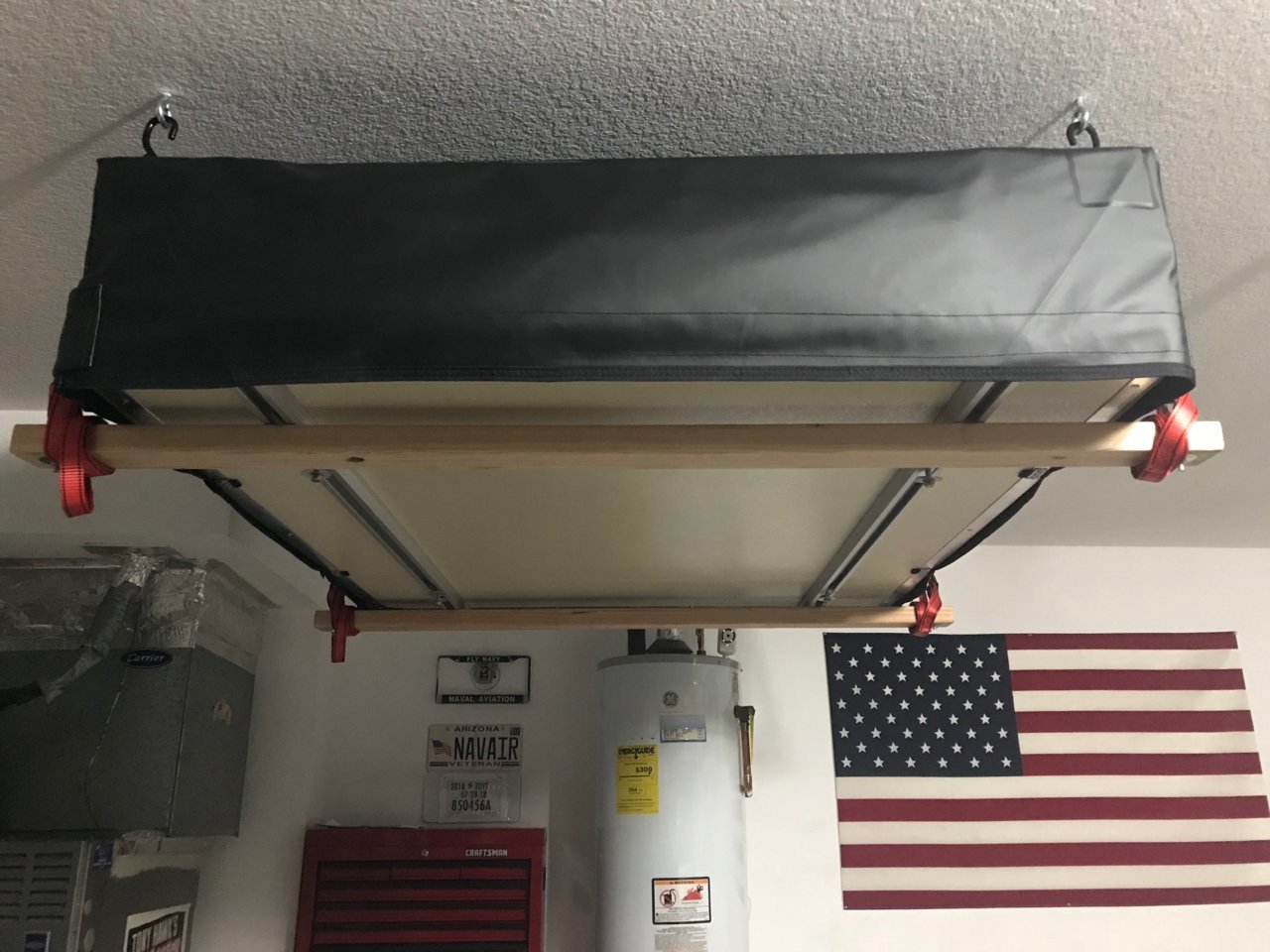

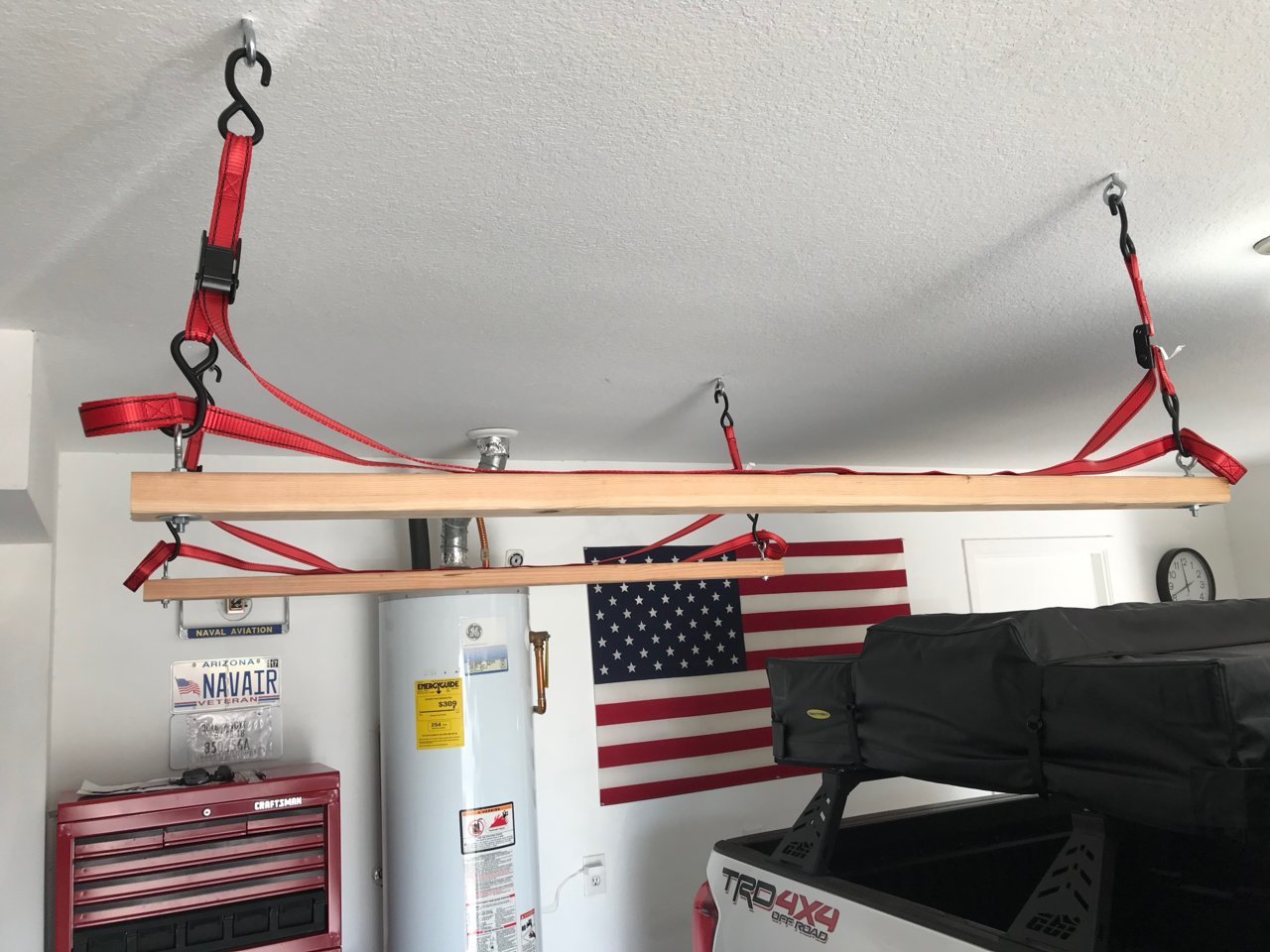

    Off the truck and stowed...

    I would assume that the top bolts are into joists in the roof correct? How did you raise it up into that position?

    You would assume correctly...not my first rodeo :thumbsup: I used cam buckle straps with 1K# working load, as they're easier to control, and the tent only weighs 116#. Simply pull the respective strap corner by corner a few inches off the truck, move the truck, then finish raising the same way. I thought I would have to help by pushing each corner up, but there was plenty of leverage. I've loaded and unloaded a couple times now, and it's cake...best part is that no help is needed.
