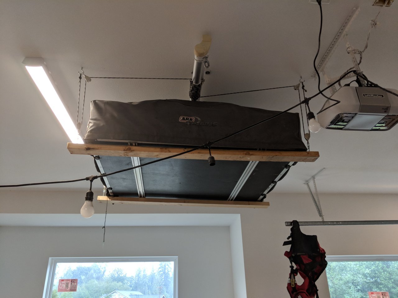

    Glad I could help!
    The latter...3/8" X 4" lag thread screw eyes in the ceiling joists, 3/8" X 4" eyebolts nutted with fender washers (top and bottom) in the 2" X 3" X 56" stud crossbars. It will hold way more than the RTT...

    i do the same, except i used pulleys and rope and tied off. This is much easier, not sure why i didnt think about it.

    That was Rev 1 :D
