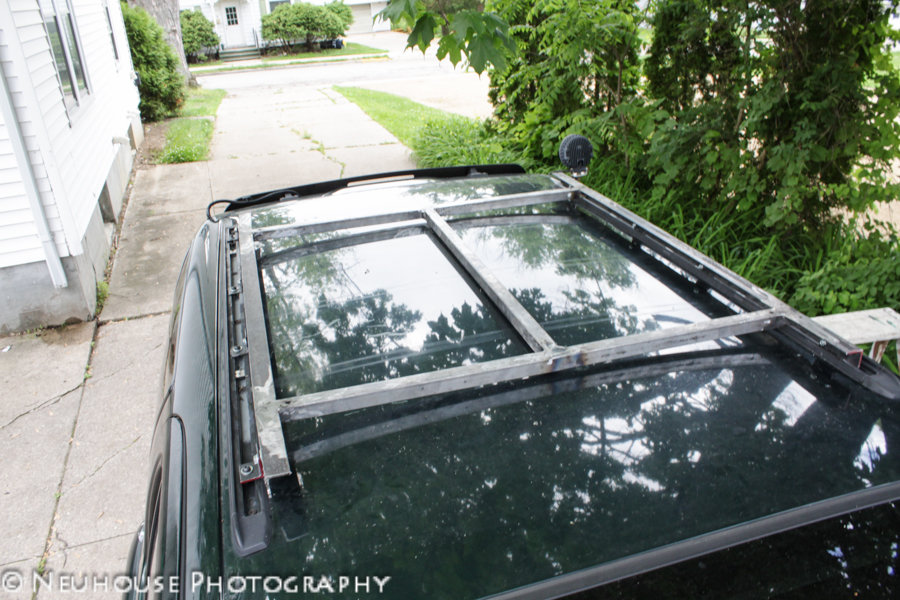

    If you look at the picture, the roof rails have four small bolts that would be used to hold the towers to the rails. The towers are replaced by four angle brackets welded to the frame. Just unbolt the assembly and lift it and the tent off (not the rack bolts to the tent) off.

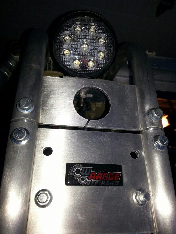

    Its a prototype that is being developed by Low Range Off Road. It is currently getting some refinements. Once all gets worked out look for a full write up on it in TCT Mag in the future. :)

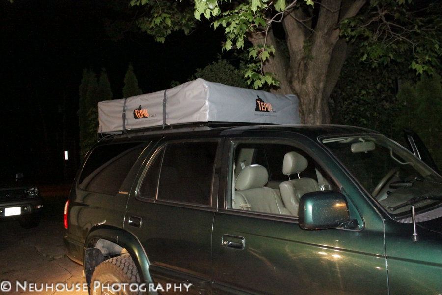

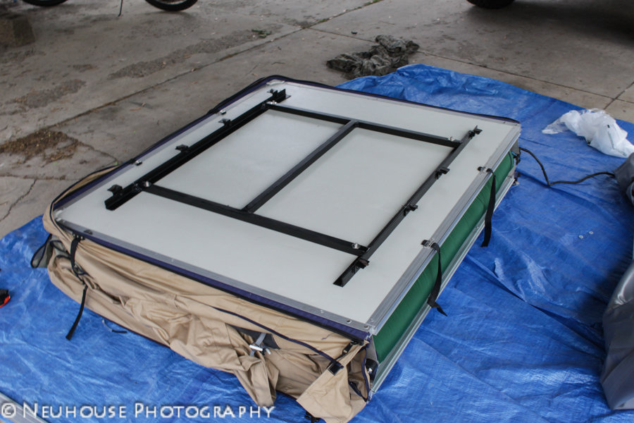

    I can have it off in about 5 min because I used the hardware that mounts the thule racks to the tracks on the truck. There is no need to completely unbolt them then just about a full turn on each of the 8 bolts and then it can be lifted off. :cool:

    Just a teaser.
