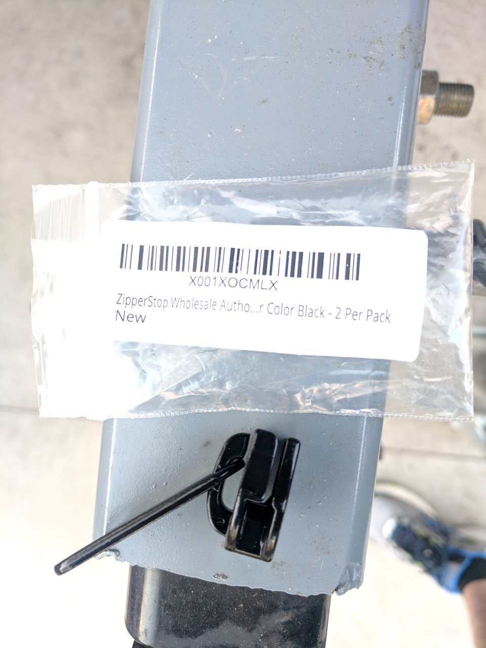

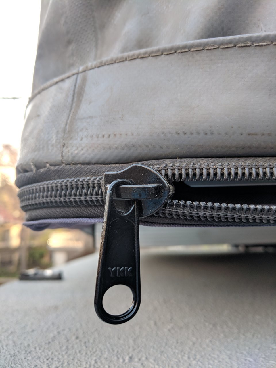

    FINALLY FIXED THE BROKEN ZIPPER ON MY TRAVEL COVER
    Figured I should share my success since others might have the same issue. I've posted in here a couple times trying to find info about this but didn't hear from anyone who had solved the same problem.
    For a while now the zipper runner that holds the travel cover to the tent base has been worn out. At first the zipper wouldn't connect both sides together unless I was very very careful, and random spots along the way would never connect no matter how hard I tried. Then one cold night I snapped the zipper pull off. Not just the rope on the end, but the metal hook on the runner that the zipper pull loops around.
    After some trial and error I figured out the zipper is a #10 Nylon Coil and found the corresponding zipper runner on Amazon for $10 (pack of two). I'm sure you can find them cheaper, but this is the exact replacement for the zipper. To swap it out all I had to do was pull the zipper stop off the end of the tent base side, and slide the replacement runner on. Didn't have to alter the zipper besides that. The zipper stop is easily replaceable and dirt cheap. Now my zipper works like new when putting the travel cover back on.
    Can't believe it took me this long to fix the zipper after how easy it was once I figured out what runner to get. Took me less than 5 minutes.
