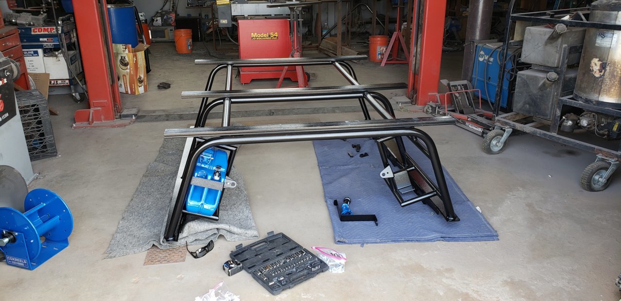

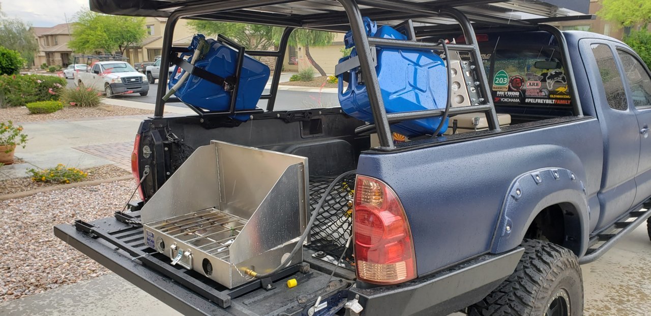

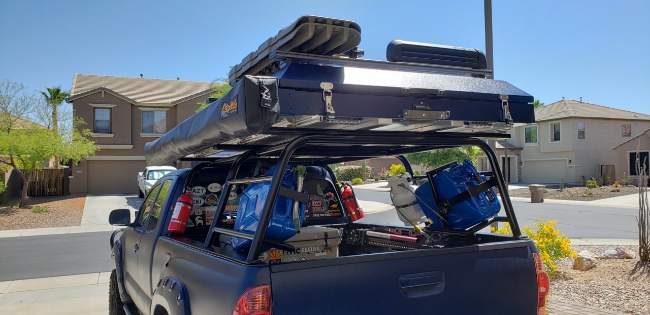

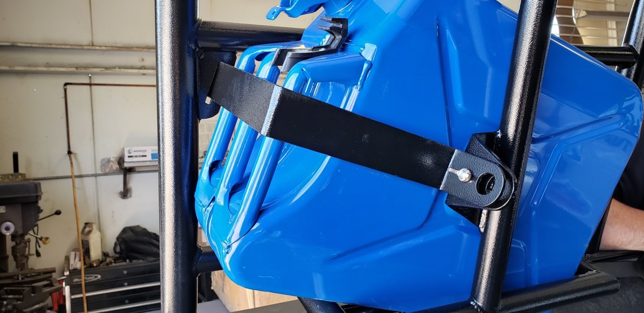

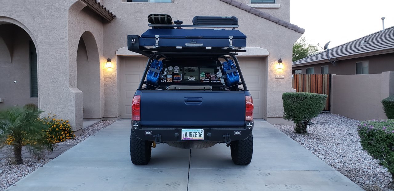

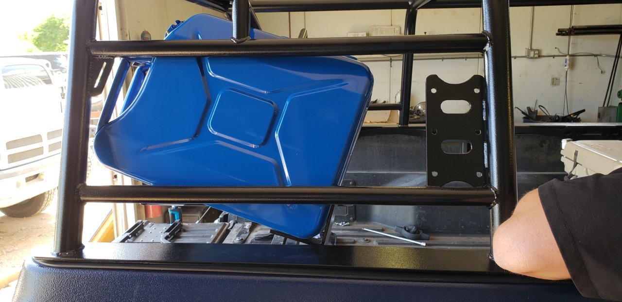

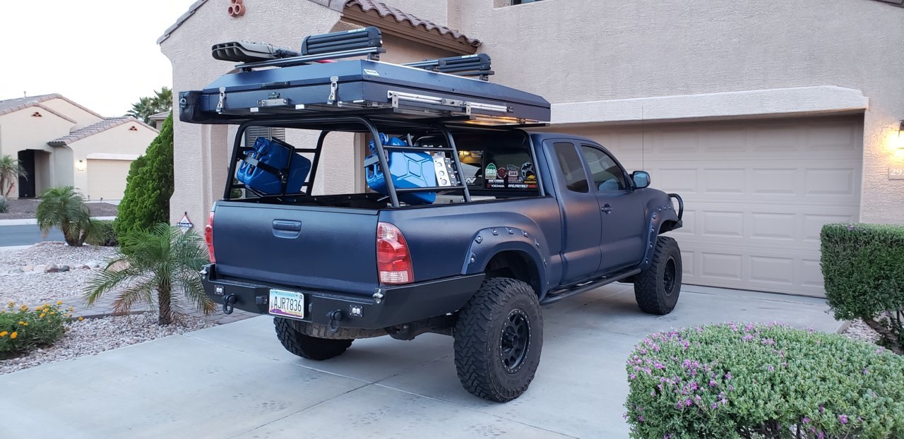

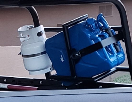

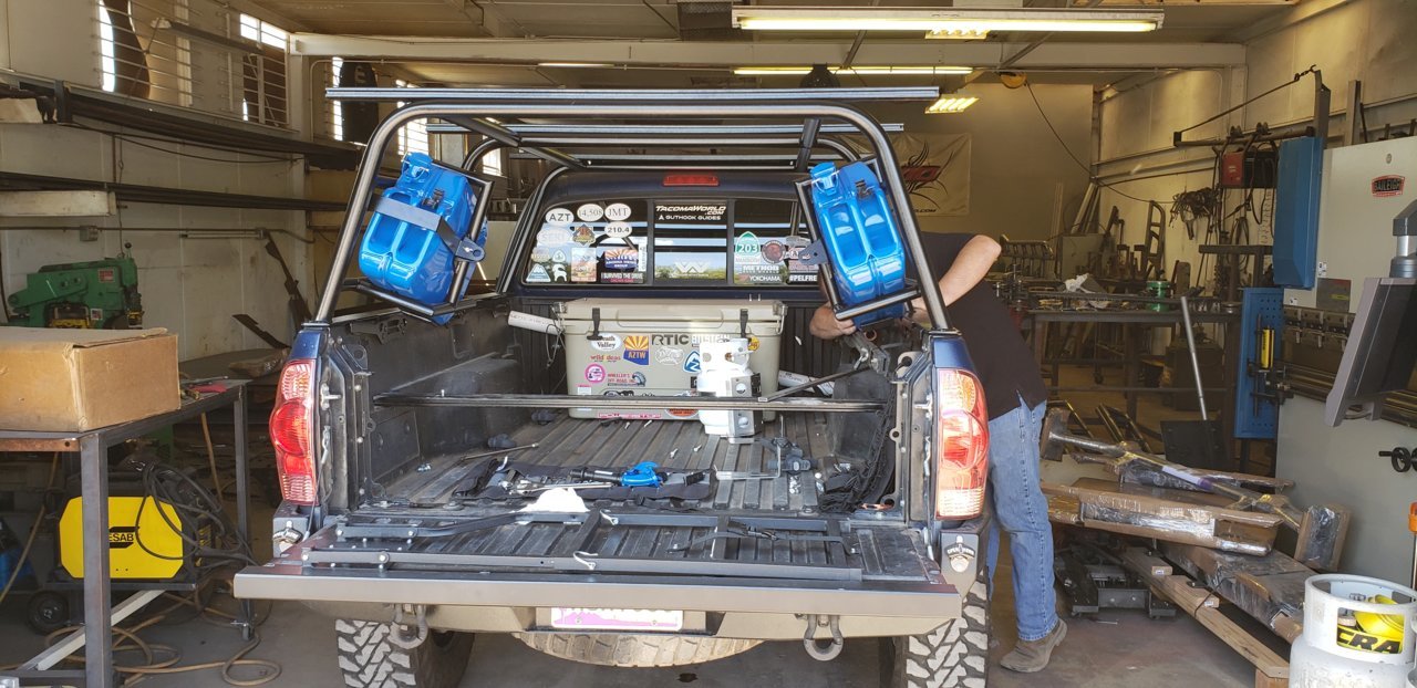

    Got my new custom Avid Off Road bedrack done and swapped in for my old bedrack on Saturday. This thing is amazing and built like an absolute tank. Jerry Can cages that lock, a mount for my small propane tank, 6 gusseted mount tabs for my Alu-Cab tent instead of only 4 so I could add a 3rd mount rail under the belly of the tent instead of just the ends. This new rack is so much more stable than my previous one and really handles the tent and awning setup well.

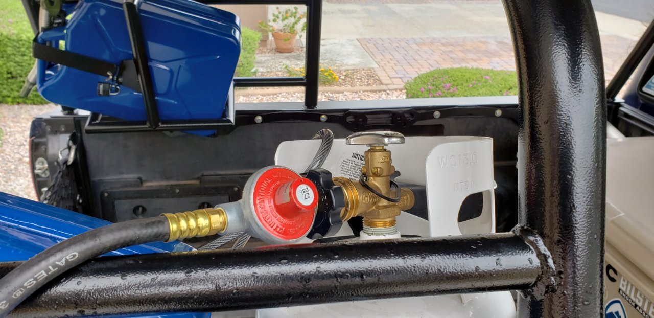

    My Partner Steel stove included hose reaches from my stove on the tailgate to the propane tank without having to remove it from the mount. I just screw on the hose and turn on the tank.

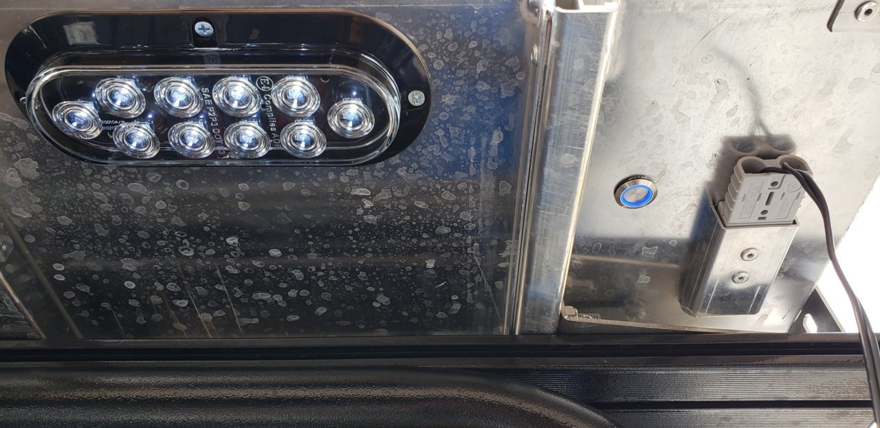

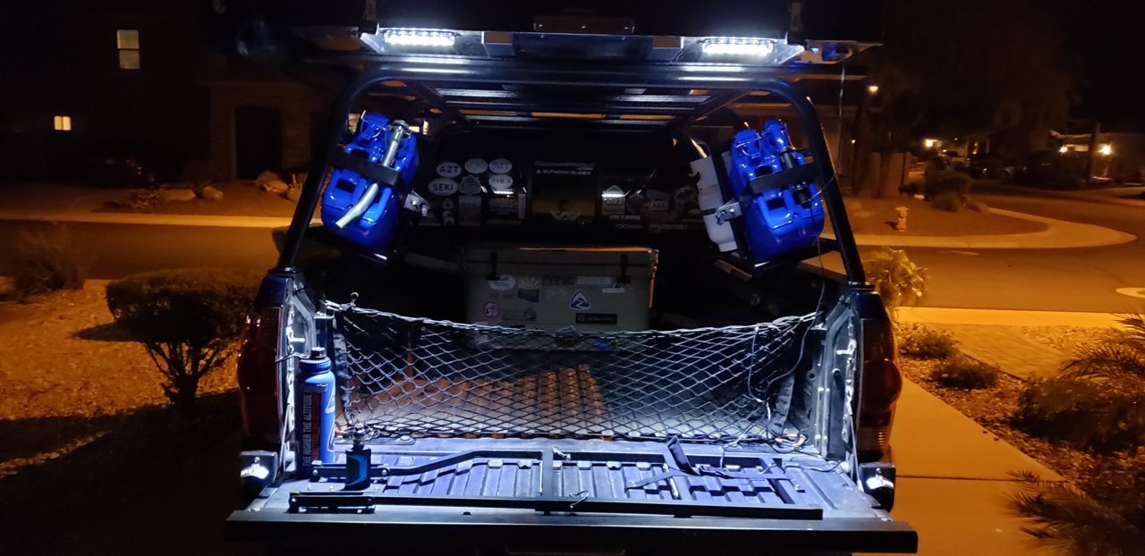

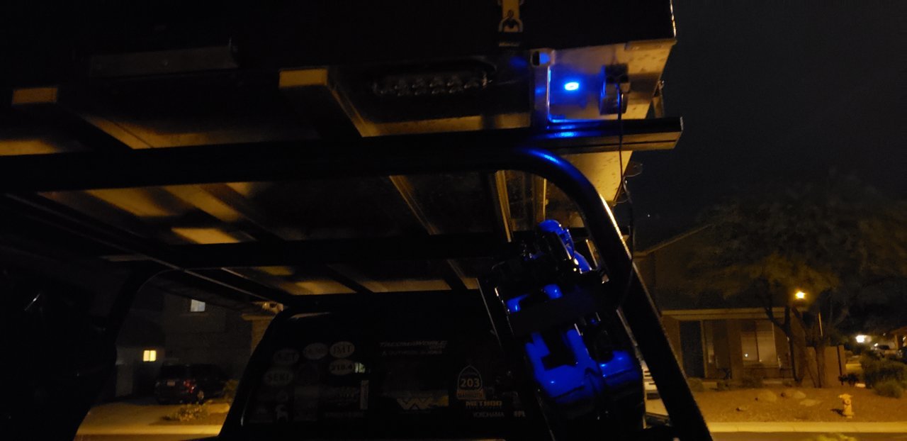

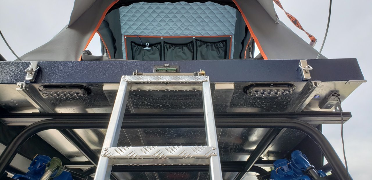

    Also installed 2 surface mount LED flood pods under the floor of the tent over the tailgate for some great light for camp and for night fishing. I ran them through a metal latching switch with an LED ring that's hard wired to the tent's power so when I plug the tent into one of my bed-mounted cigarette lighters, I have ready power for everything when the truck isn't running. The button for those flood pods is right back by them for easy access. Everything wired cleanly under the bedding of the tent and I used tons of heat shrink and shielding after soldering the connections. The LED button is always lit up when the tent is plugged into the truck so the switch for the floods is easy to find in the dark.

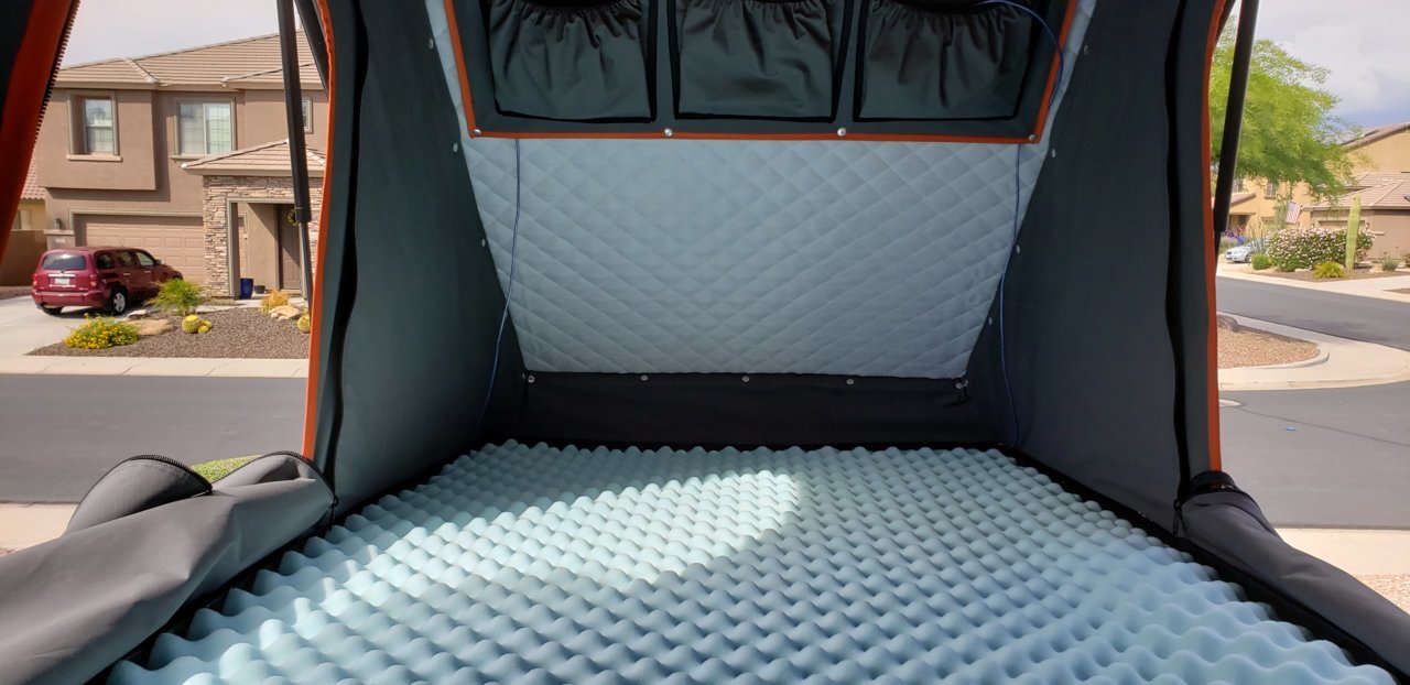

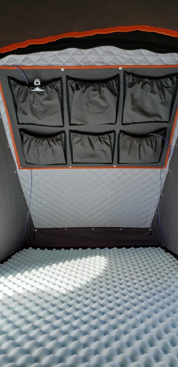

    I also removed my 2" closed cell foam mattress topper from the tent and replaced it with a 1.5" cooling memory foam topper which allows the lid of the tent to close SO much better and it's more comfortable than the other topper. While doing that, I ran 2 15' USB cable extensions from the tent's USB ports up to the head end of the tent. Quick access to phone charging and whatever else I need to plug in overnight like my headlamp. I also have 2 extra USB ports if I need them later for other devices.

    Thats a cool place for a jerry can. I might have to borrow that idea

    I didn't want my jerry cans down in the bed and blocking the cubbies and inverter or taking up any more bed space. Those jerry can cages also really box in the bedrack and make it much stronger, too. They tilted them so not only do they rest in there nice, but they put the spout at the highest point of the can in case their seals start to leak at some point from age so it minimizes spilling.

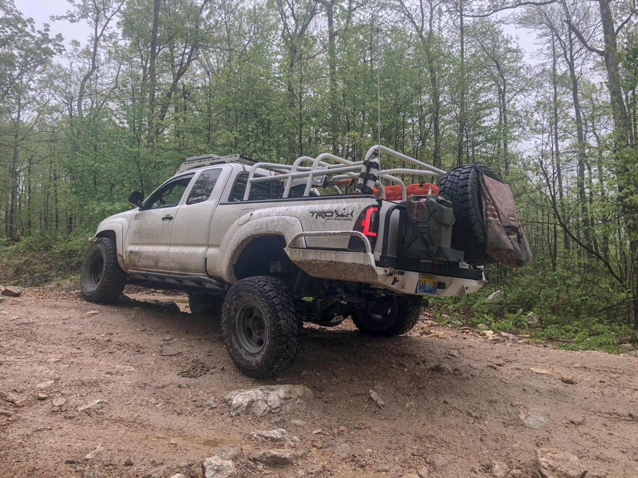

    Remember to vent them every once in a while too. I remember i got rid of my last can because the pressure was so much i was worried about opening it.
    I actually want to put 2 rotopax in place of 1 jerry can, in my swingout mount. I just need someone to confirm the width.

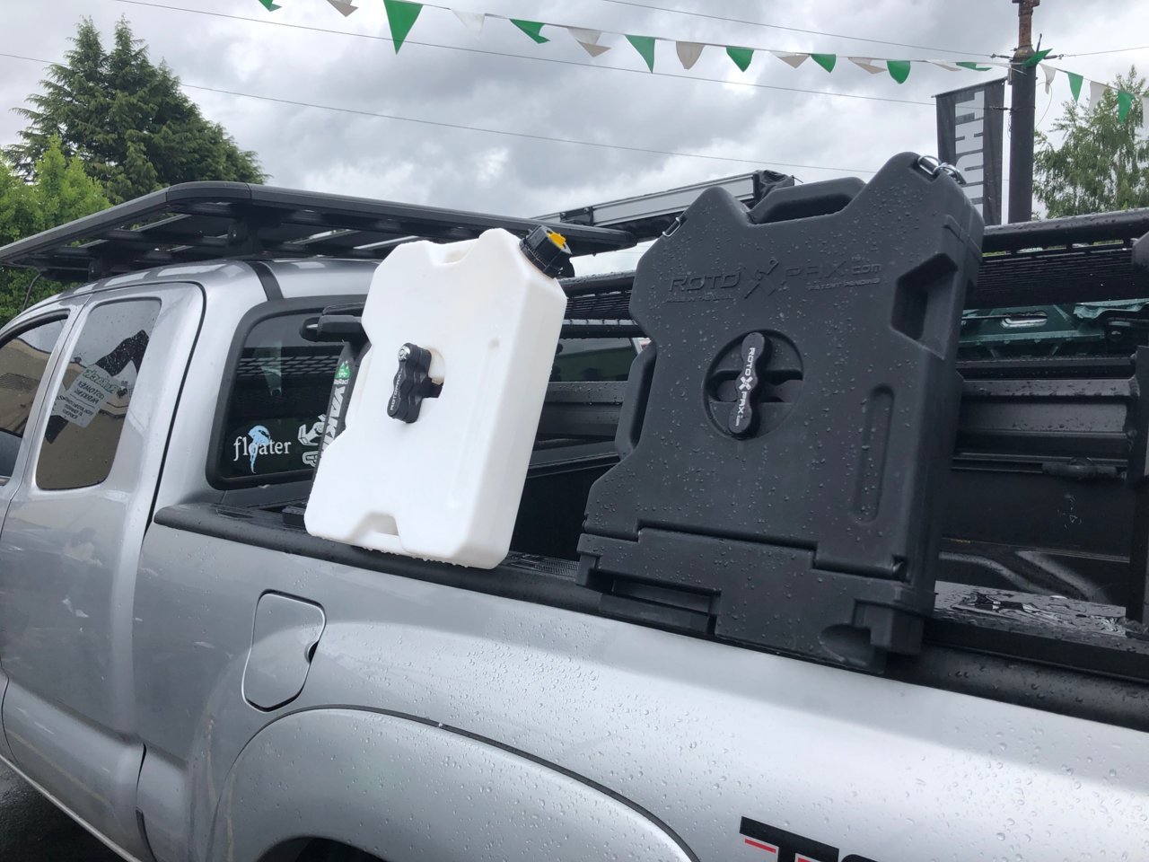

    I have some of the RotopaX, which ones do you need sixes for?

    I guess the water one? Id be looking for the width
