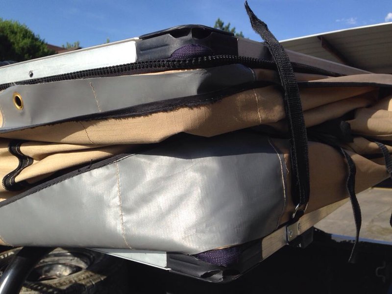

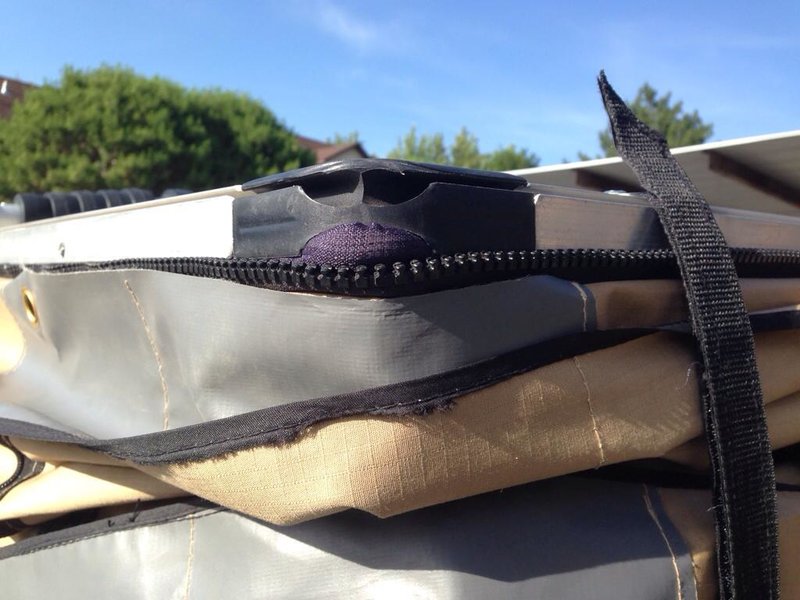

    So I flipped my tent over does this look right to you guys? I can see where that piece from the cover slides into the channel? Any info would be awesome I'm tired of wrestling with this thing

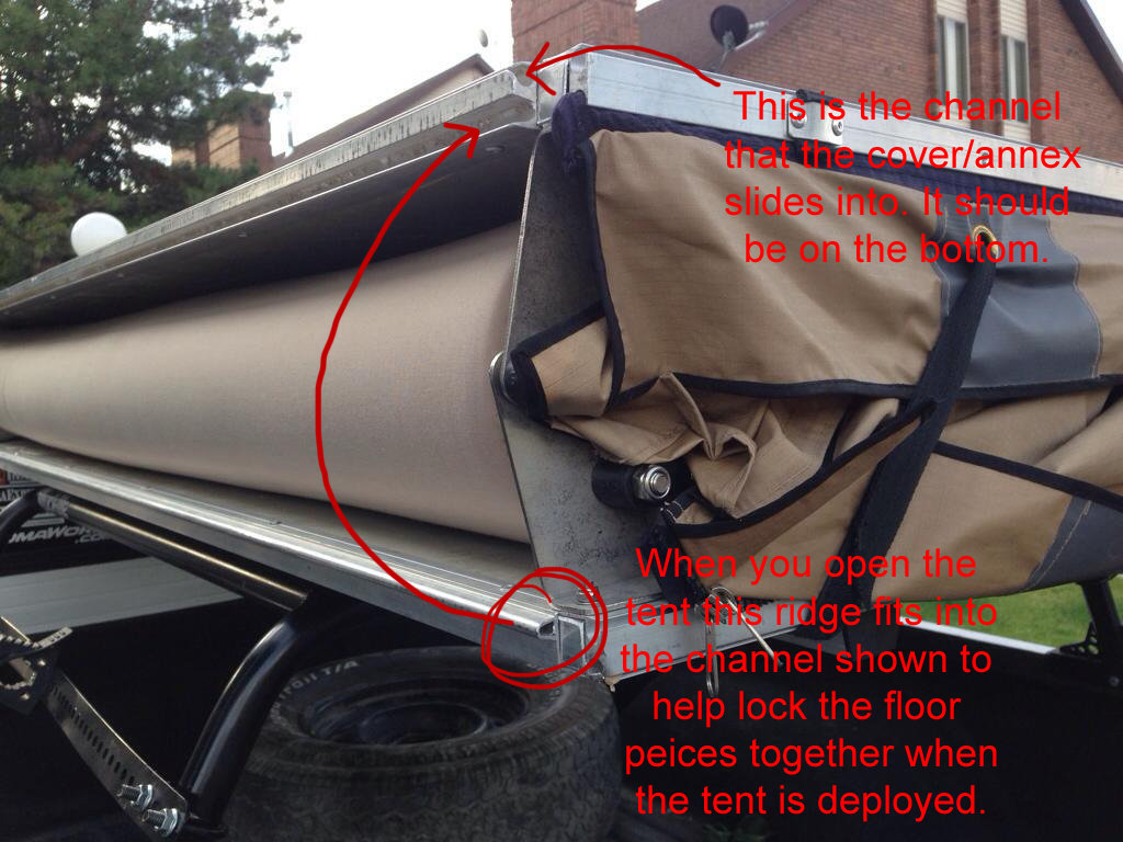

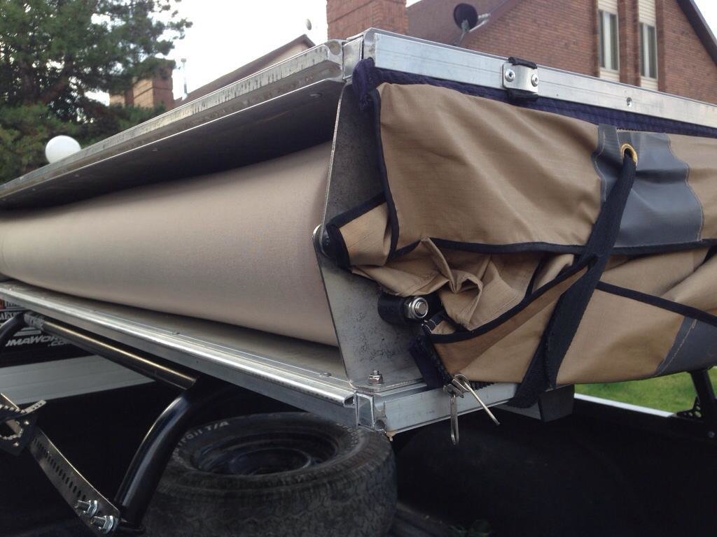

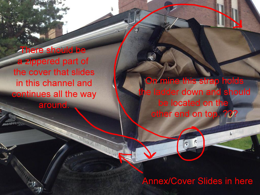

    So I will try and give some input here but I am not a pro. Mine is a tepui so things may be slightly different as well. Based on the photo, I think it should be flipped still. See the photos below. Maybe someone can chime in that has a CVT to confirm. The only thing that doesnt make sense to me is where the strap for the ladder is located.
    How you have it
    How it should be?
  18. Jun 26, 2014 at 8:05 AM

    I concur - except for the ladder strap. Mine doesn't have that.

    why the heck would my zipper be on the top half though? wouldnt it need to zip from the side of the tent that is connected to the rack?

    I am guessing the person before you put it there not knowing how to use it. My zipper can be removed by sliding it out of the channel. Hopefully you can do that to yours and move it to the channel on the bottom.
