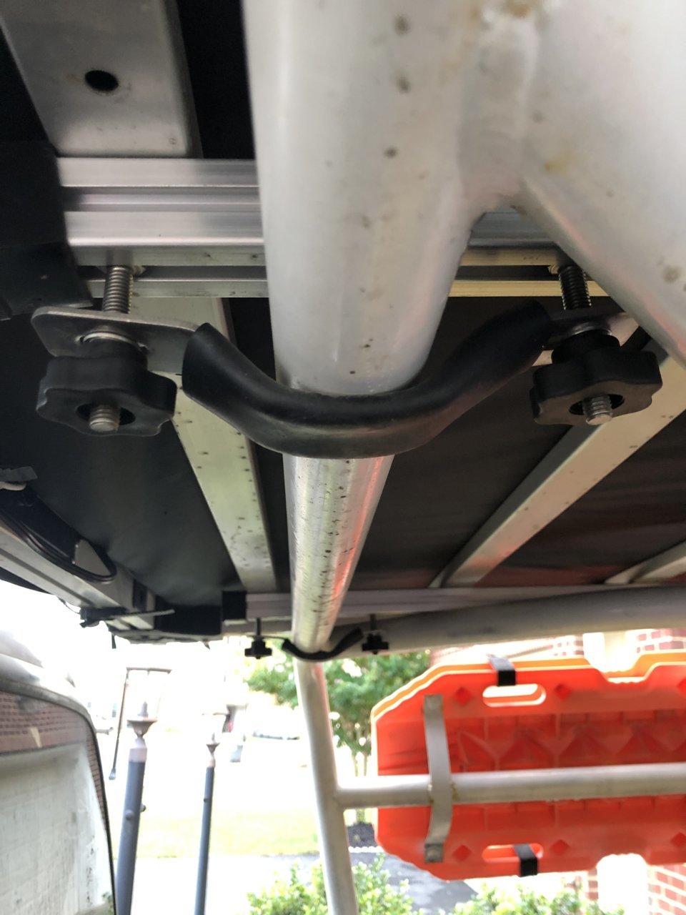

    Are the twisty knobs nylock nuts?

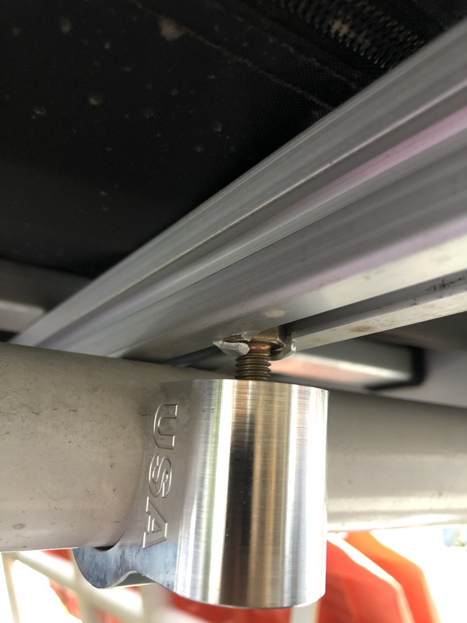

    I replaced literally every bolt that came with the tent and those 4 are rounded hex head in mine with fat fender washers for that very reason. The hardware choice was just a joke on Tepui’s part because they’re all undersized for the less than ideal tolerances.
    Going a size up on the ladder made mine so much more stable as it’s a snug fit in the hole. Fortunately the holes were all on exactly the right places.

    No. What came with the tent are the split washers

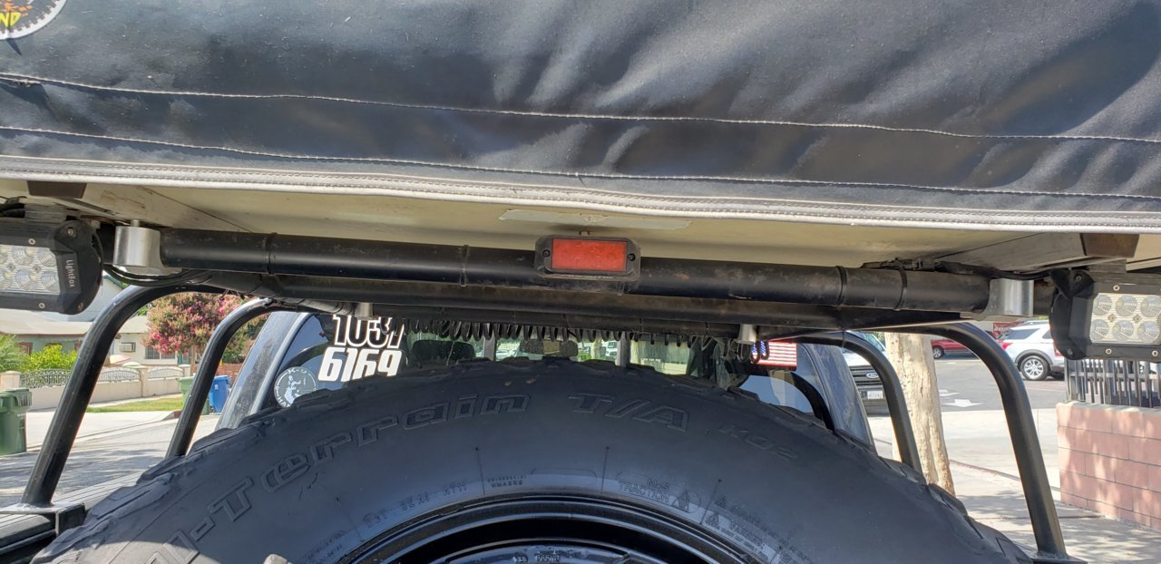

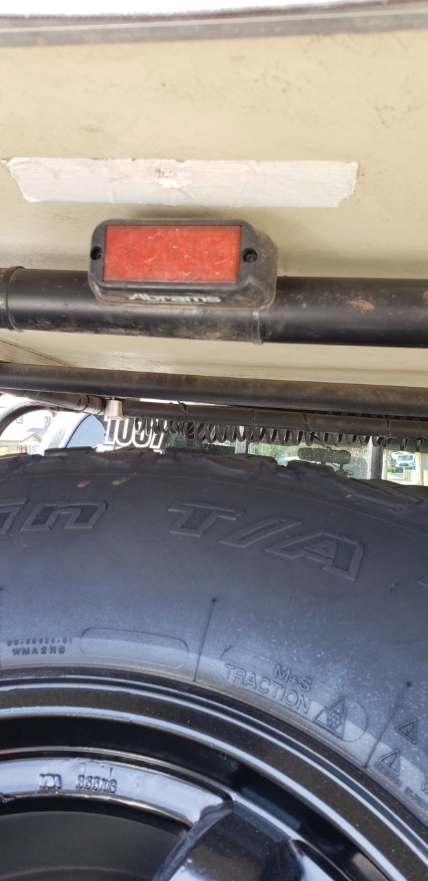

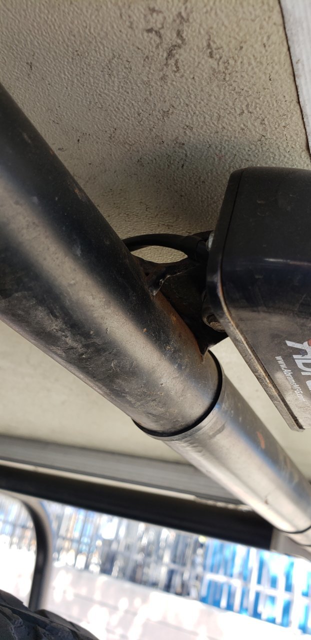

    I welded on some light bar tabs for my rear aux. lights and LED 3rd brake light.
    The Abrams RED LED light I am using and is insanely bright. It also automatically dims a little bit after being on for about 5-6 seconds. It's one that I would recommend. Only complaint is that the lens is clear and not red, that easily fixed using red lense paint

    That doesn’t look like a very good design having all the force on the nut. It should have an insert to spread out the force across a few inches of the extrusion.

    Its worked fine so far. Been on logging roads in Maine, rocks in PA, and fire roads in Maryland..
