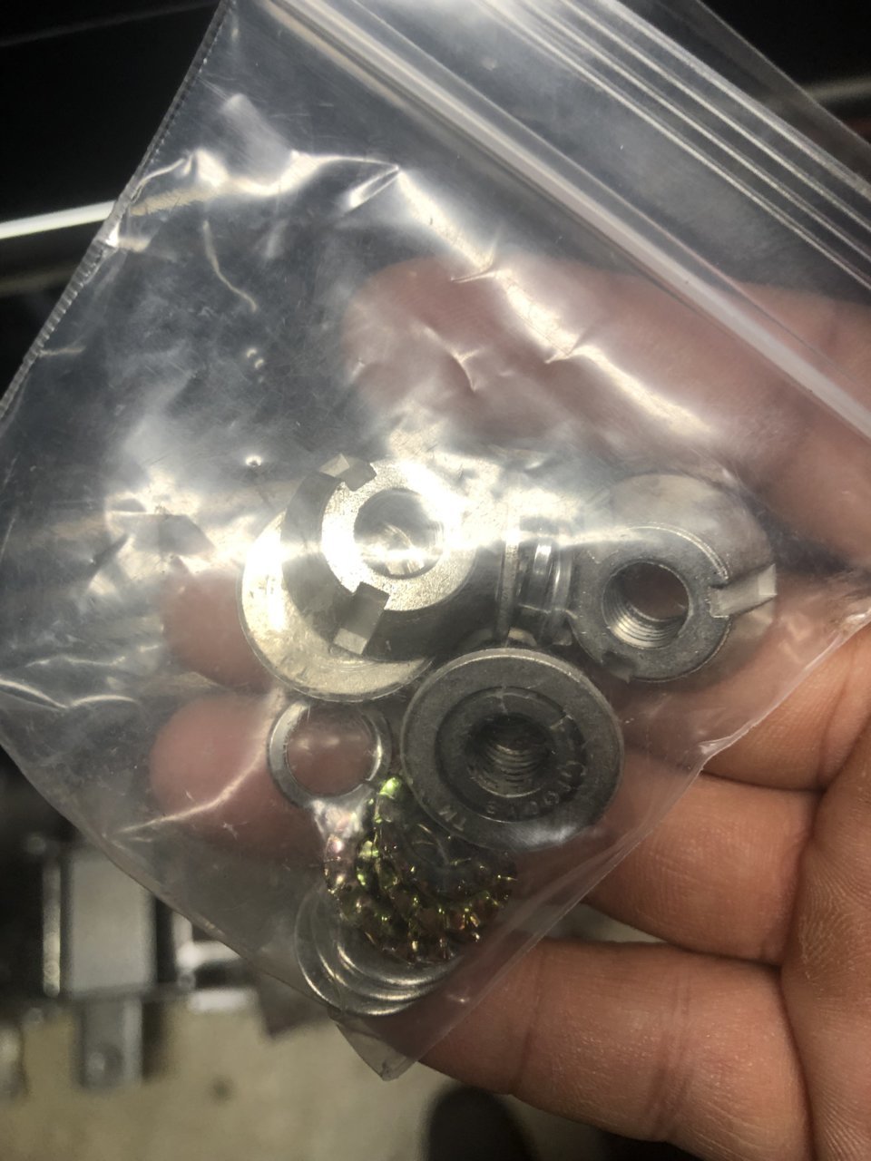

    Mine has a washer on each bolt, and they were with the kit. I dont see a washer in the picture that you are showing, a washer would have prevented that.
    Edit: I also believe that you over-torqued the fasteners unfortunately.
    Edit: my $700 Smittybilt has these cool insert things that fit nice and snug inside the channels which does an excellent job of spreading the load evenly. I am very much surprised that your much more expensive FSR RTT doesn't have the channel inserts.

    It didnt have a washer. It had the locking teeth washer thing. Don't know the real name for it..
    The standard washers you see, are for the knobs from FSR.
    Im not doubting WEW product or shaming it in any way. And i wasnt torquing anything down. I was just using a wrench to tighten things. No power tools at all.

    @nvnv and @MonkeyProof are correct, your tent appears to be missing the aluminum inserts that would normally hold the bolt in the extrusion riveted to the bottom of the tent. That is the only reason your tent rails are now damaged, it has nothing to do with the WEW security mounts at all. Returning them will not solve your problem. If you don't have the sliding aluminum inserts that should have come with the tent, then get some fender washers that fit the bolts and the rail and stack 2 or 3 washers together on each bolt. That will spread the load on the bolt head and prevent the bolt from pulling through the extrusion like that. Even the shitty factory straps will have the bolts pulling through the rails at some point. It's a disaster waiting to happen without some sort of insert in the rails to support and spread the load of the bolt heads.

    You are spot on sir. I didn't even catch that in the photo he posted.

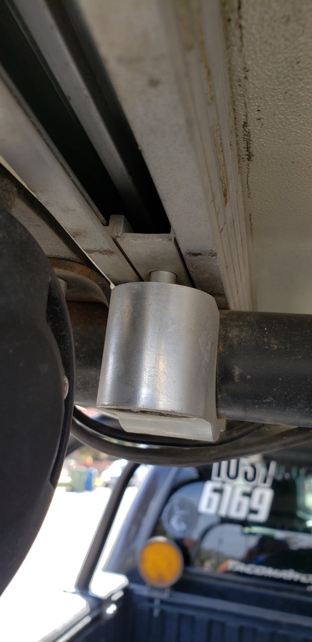

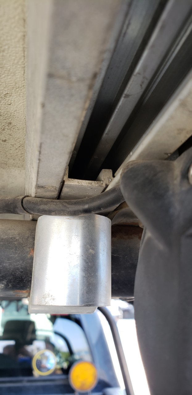

    The bolt head fits directly into the extrusion.. it doesnt twist. Do all tents have the same style mounting? no. o_O
    Ive never had a problem before this. I am going to go back to the straps. They are not like the flat tie down like on other tents. Im not saying mine are inferior, but Im not going to stack washers either. Im just going to slide my tent back to where it was and secure it that way. Its been through tons of different situations where it could move, and it never has..

    Still asking for problems IMO. Without something to spread the load of the bolt head, even the factory straps will eventually pull through. The WEW mounts made it happen faster because they wont deflect like the straps will and therefore the bolt head pulled thru faster (immediately). If the factory that built the tent has you installing the bolts without something to spread the load, they are doing it wrong and creating future issues. I'm glad I didn't buy one of their tents because that is just not safe, regardless of how long you have been doing it. Good luck with that.

    GoFSR tents just use the bolt in the 8020 track. I have one too.
