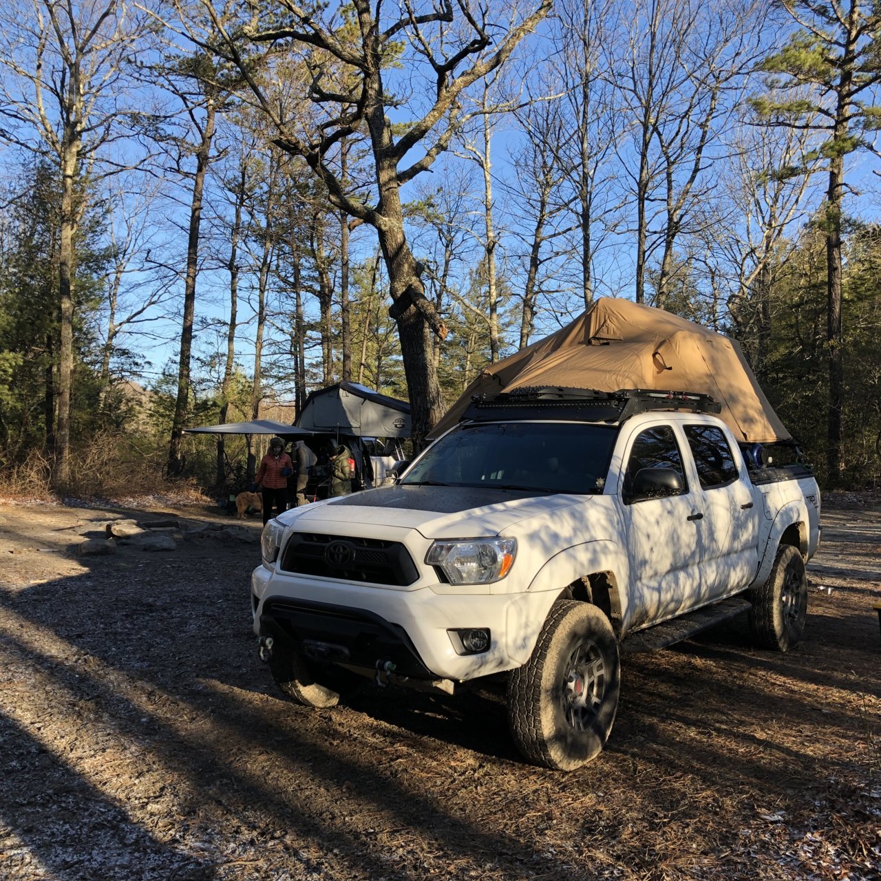

    I've considered adding a third bar as well but I've spent a bunch of nights in it as we well as doing some pretty tough trails and the tent seems solid so far so not sure if I will.
    I did exactly that, I looped a short bungee with a ball on the end to that flap and have a permanent hook installed on my Prinsu. I dont have a good picture of how it right now but at least here you can see that it pulls the flap tight.

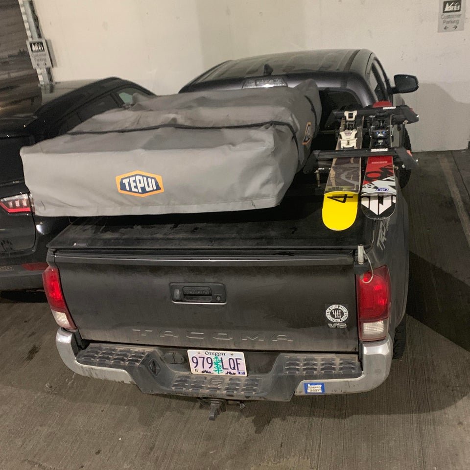

    When Overlanding is life but skiing is also life. $20 ski rack off Craigslist and a little creativity, no more propping my ~6 foot long skis crosswise in my 5 foot bed. Honestly I'm digging the asymmetry of my setup

    Nice, I would probably have mounted the RTT on the passenger side to offset the Taco lean (battery and gas tank) but still pretty slick.

    The exhaust is on the other side and especially when I'm winter camping off road I like to give the truck a chance to warm up while I'm putting the tent away rather than hop into low-range and the associated high RPMs on a cold engine. I did have it on the other side to start with and the exhaust goes straight up into the tent while I'm putting it away, and I like my brain cells.

    Maybe I'll flip it around when I eventually cut my exhaust(willingly or otherwise lmao, one of my off road buddies cut the exhaust on his FJC over the axle like that with a rock instead of a sawzall). I keep my heavy ass box of tools, recovery gear and chains on the right side of the bed and my lean isn't that bad

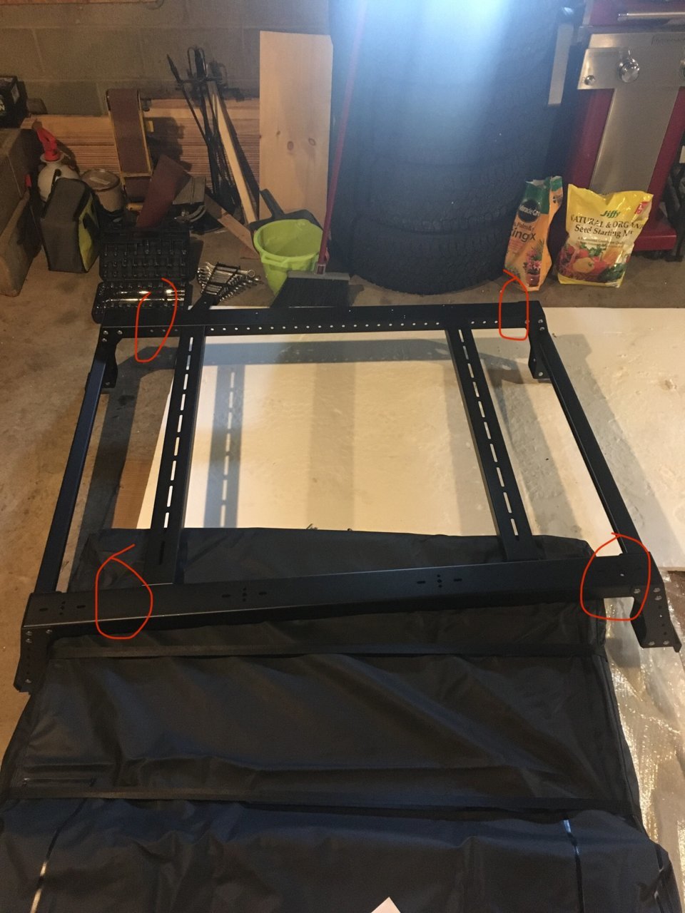

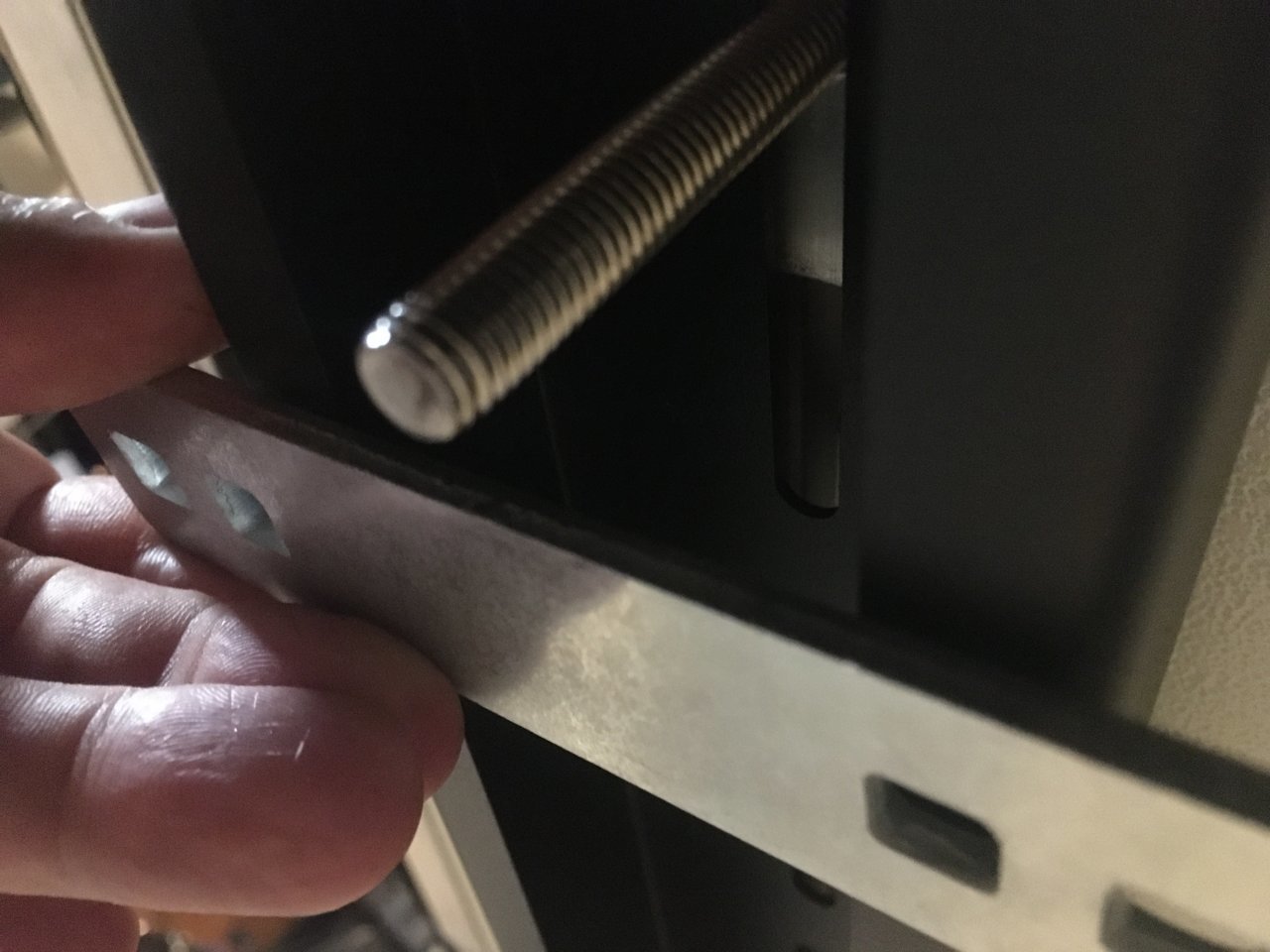

    I feel dumb. Got my RTT and im ready to mount my tent to the bed rack. Hardware supplied with Smittybilt tent is for clamping on to bars but I have the KBVoodoo rack with the slotted bars running parallel with rack.
    Do I drill a hole in center of mounting plates and use 1 bolt per corner instead of 2?
    Roof rack bars also dont seem to line up with tent mounting bars.
    Sorry dumb question.

    shouldn’t the bolts go on the outside of the bars ? And that piece you’re holding attaches them to the bar like a ubolt. Or am I missing something.

    Yes but both the tent rails and bed rack rails are running parallel.
    Im not sure but I might be having a dumb moment lol

    Just use a washer.

    Unless I mount to outside bars instead of those two center ones?

    How are you trying to orient the tent? The mounting bars on the tent should go perpendicular to those two crossbars with the slots in them.
