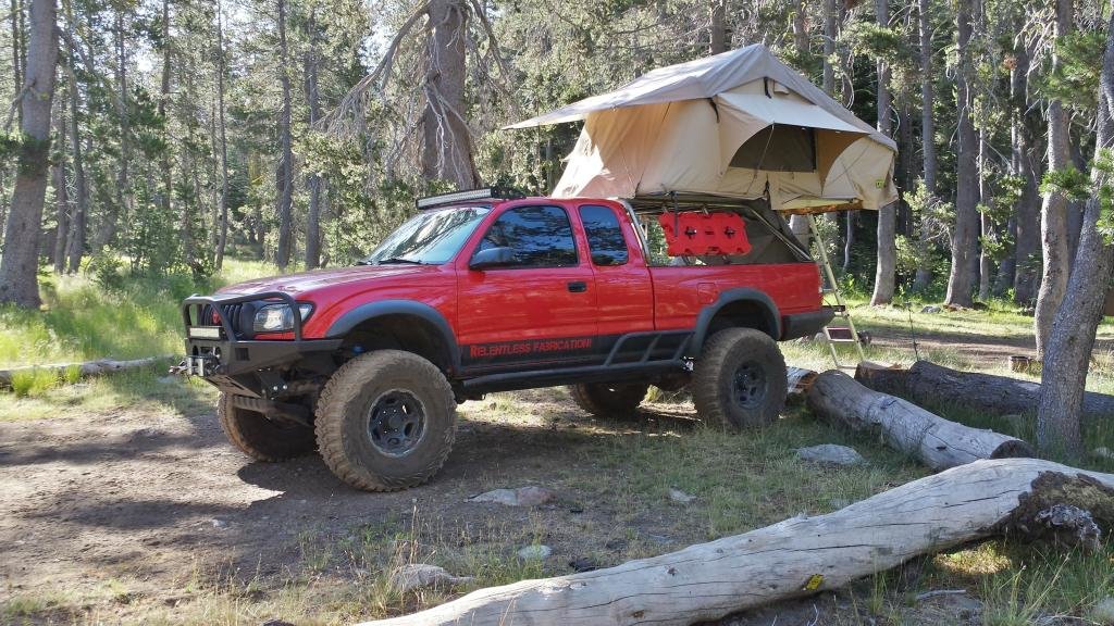

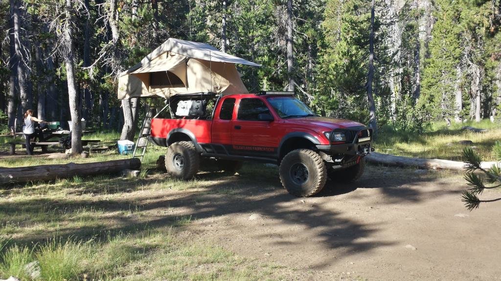

    Tested out my RTT for the first time this weekend. Worked great
