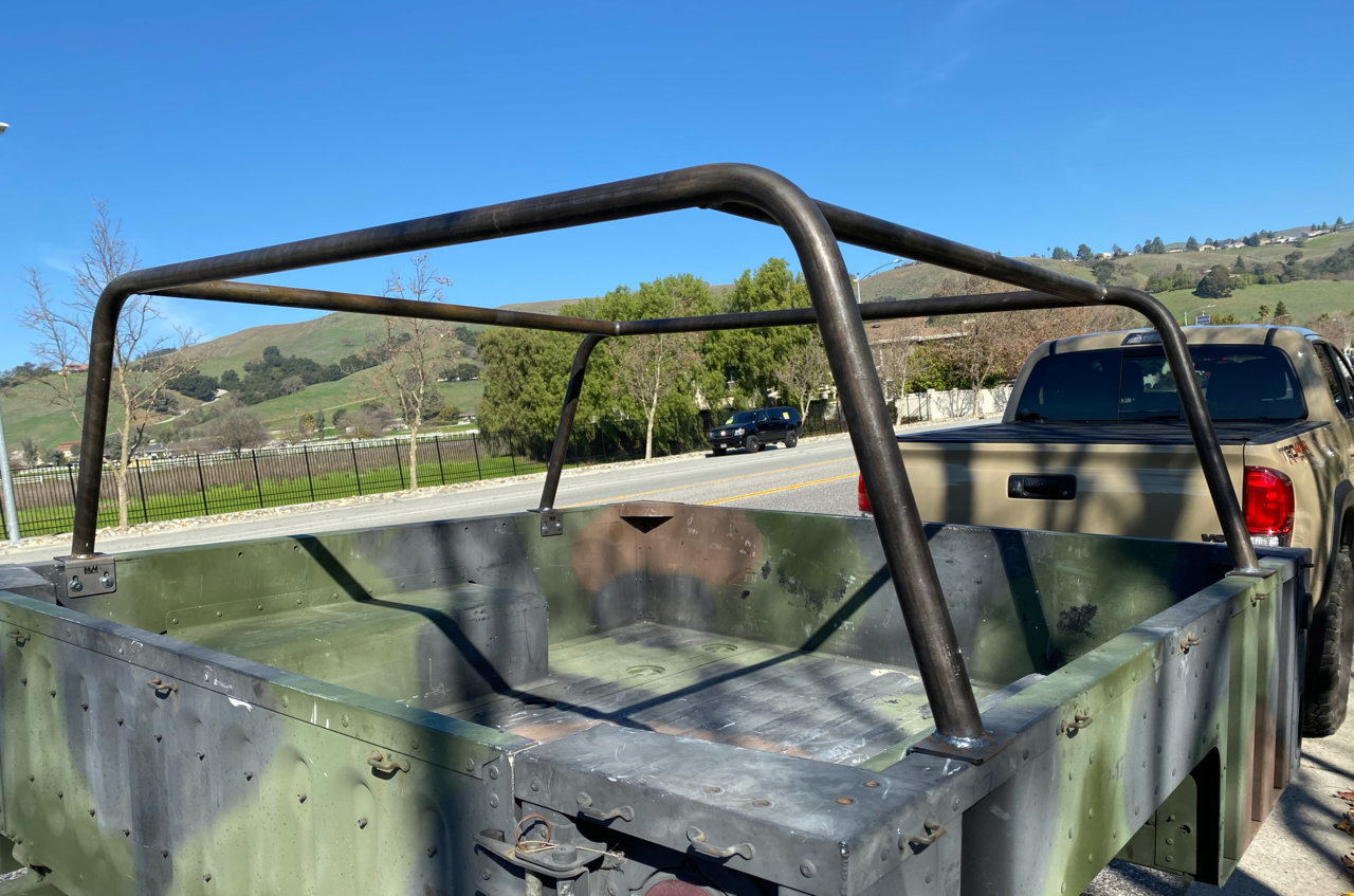

    What would be some good protection on my bars so I am not ripping off the paint every-time i load the tent on? About to throw some paint on.

    @unk I got a set from this group buy. Doubt they are still making them, but maybe you could use the idea to get someone to make them for you. I love my set, they work so well.
    https://www.tacomaworld.com/threads/kydex-bed-bar-protectors.393501/

    You can buy sheets of kydex from Amazon or a half dozen other places. Cut four pieces and pop in the oven at 275ish for 15 minutes. Pull out with good thick gloves and set on the bars and you can hand form them around the bar.

    Yep, exactly what i am trying to do. thanks.
    thanks, i found this as well.
    https://www.summitracing.com/parts/wsd-ws9011

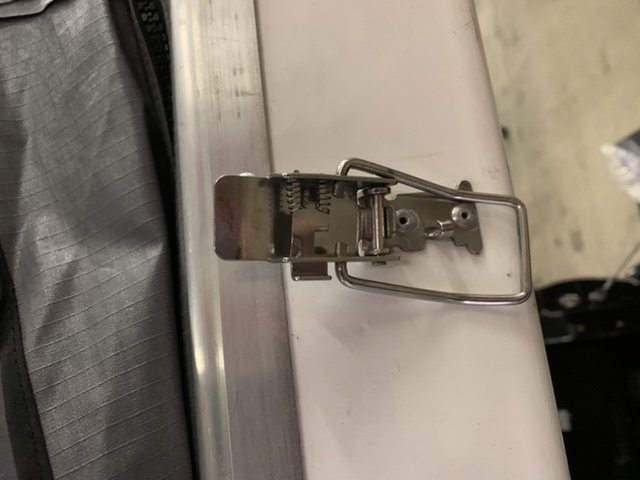

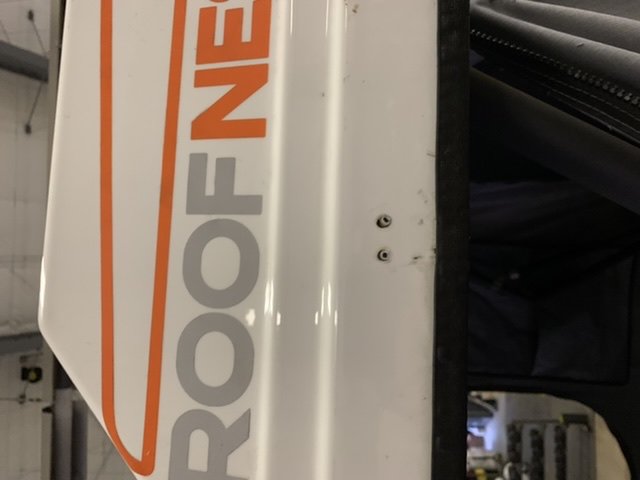

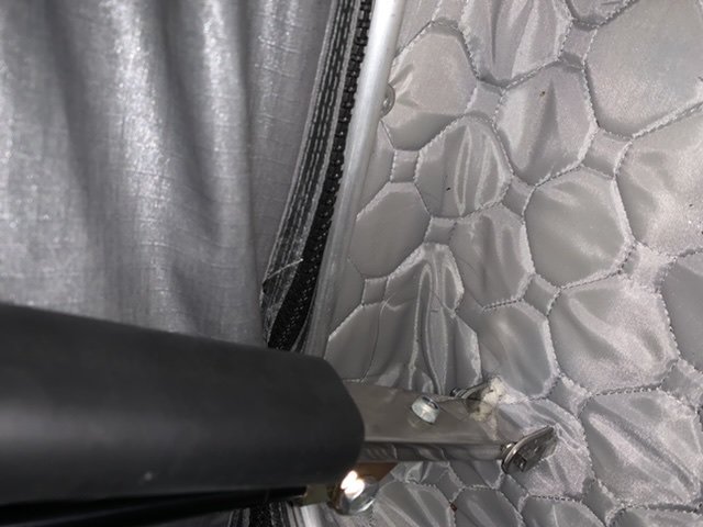

    Hi all,
    Bought a used Roofnest Sandpiper for $1000, in fairly good condition but obviously with some attention needed.
    All 4 latches are busted. Previous owner received new latches from Roofnest but didn’t install them. OEM latches are riveted on and hidden behind insulation layer on the inside. Replacement latches are nut and bolt. Advice on how to replace? Has anyone had to replace their latches?
    A5EE373D-9A1D-43FA-AB5F-D1539E83DCCD.jpg A4BB1129-CE09-46AC-819A-E263D3CB5EBC.jpg 3E1DBC74-B0A6-4C77-A9FF-4599D221836C.jpg

    Guess Im having a hard time understanding whats going on there. having never seen one of those units in person.
    Your last picture makes it look like theres either snaps or screws that would release the quilted padding stuff. From there couldnt you drill the old ones out and rivet new ones on? Though I would think appropriately sized bolts with large fender washers and nyloc nuts would be a more robust solution in the long run.. Probably spread the load out

    Apologies for the not so great picture quality. The interior insulation layer; quilted looking liner, is kept in with other rivets and a metal band on the inside.
    It almost appears like I will have to drill through the latches from the outside, and drill through the quilted liner. I agree rivet replacements would probably be a better option but the factory replacement latches came with nuts and bolts.

    I suppose worst case, you could just do a fender washer and nyloc nut over the quilted liner on the inside..

    How did the previous owners manage to screw up the latches that badly? I'd give roofnest a call or email and see what they say for the replacement procedure

    when I had my Roofnest, I hated that everything was riveted. Rivets arent meant to hold that much weight. And my fat ass broke the ladder on the first time opening it :rofl:
    Id see if you can pull the inside material back enough to get your fingers in there.
