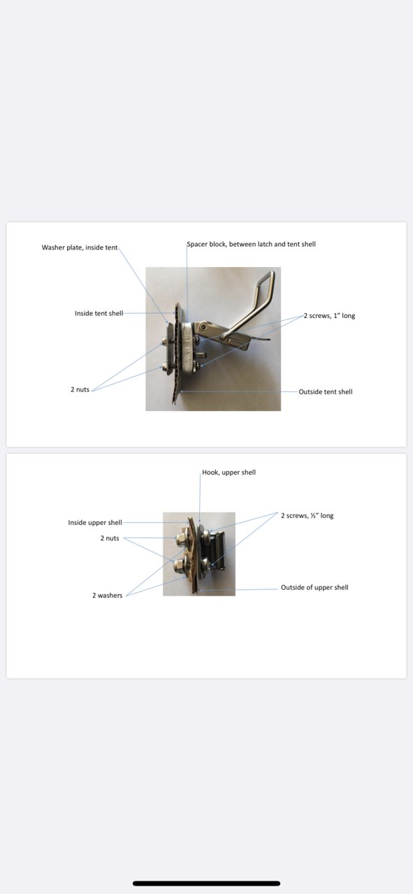

    Emailed Roofnest, they responded immediately with detailed instructions. I can’t say I’m thrill about the idea of cutting the insulation layer though5A676332-C603-4A41-8A32-C5D3588B9631.jpg6915F22C-4B81-48E5-855A-1EF4A1496602.jpg

    I would just drill the rivets out and where the drill bit pops through the insulation, install the replacement screws there.

    or just use a heat gun on a lower setting and really dial them in that way

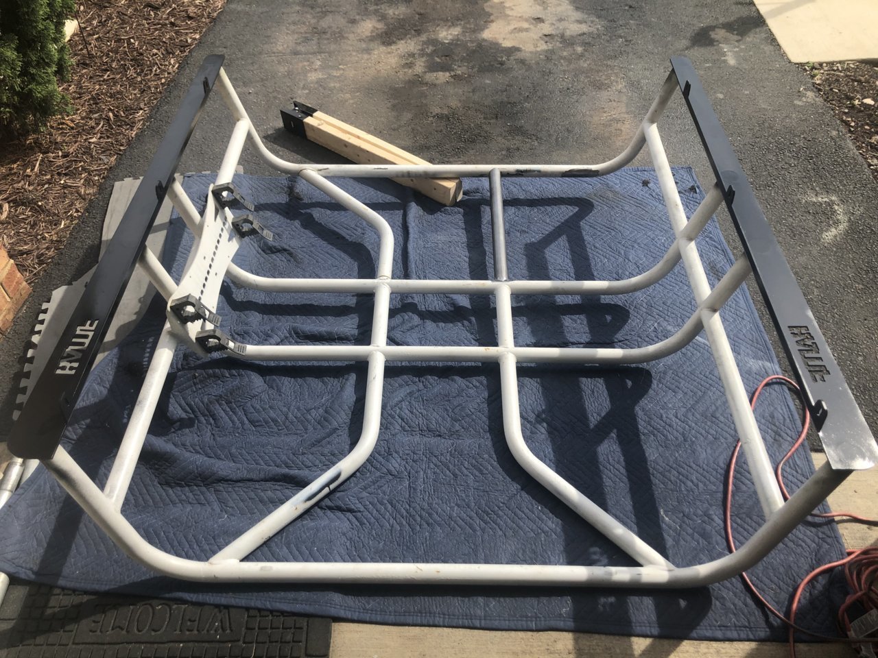

    Today's project. Pulled the rack and put a wrap on it to hopefully cut down on some of the heat that is absorbed when it's closed up.
