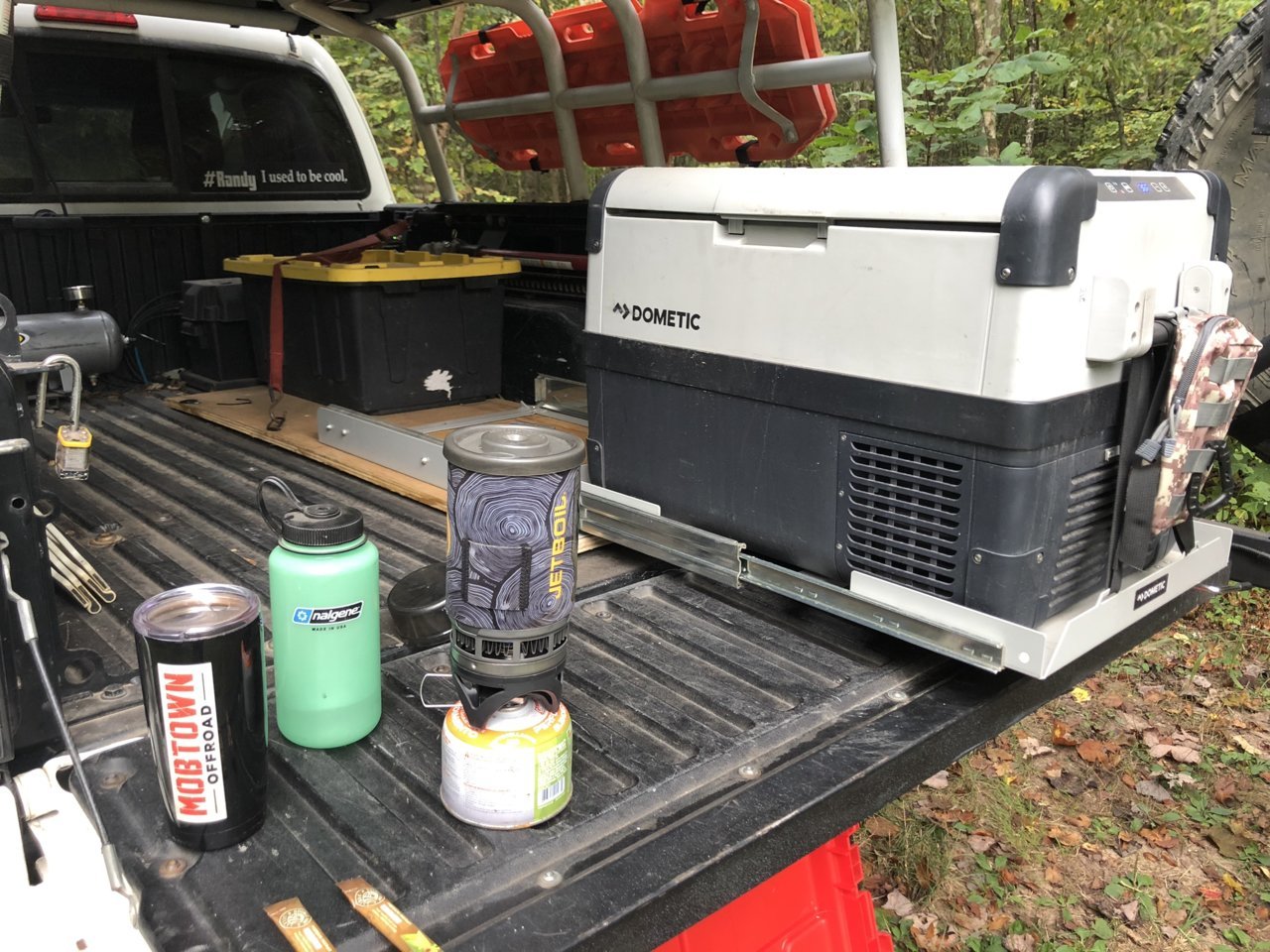

    Hey ya'll, hope everyone is taking care of themselves and each other with this crazy Covid-19 crisis. I had a question for those who are running a fridge in their camping set up. Are any of you using a separate battery to run the fridge or using the existing truck battery? If you are using a separate battery, can someone point me to a thread or explain how to set up a secondary battery to use for the fridge so I don't suck my existing battery dry when I'm out camping? Thanks, I hope the question wasn't too confusing. Stay safe!

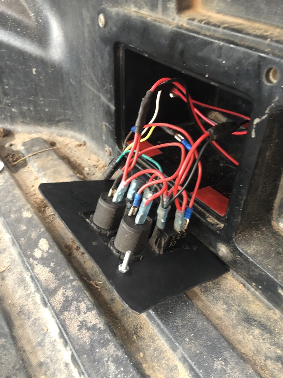

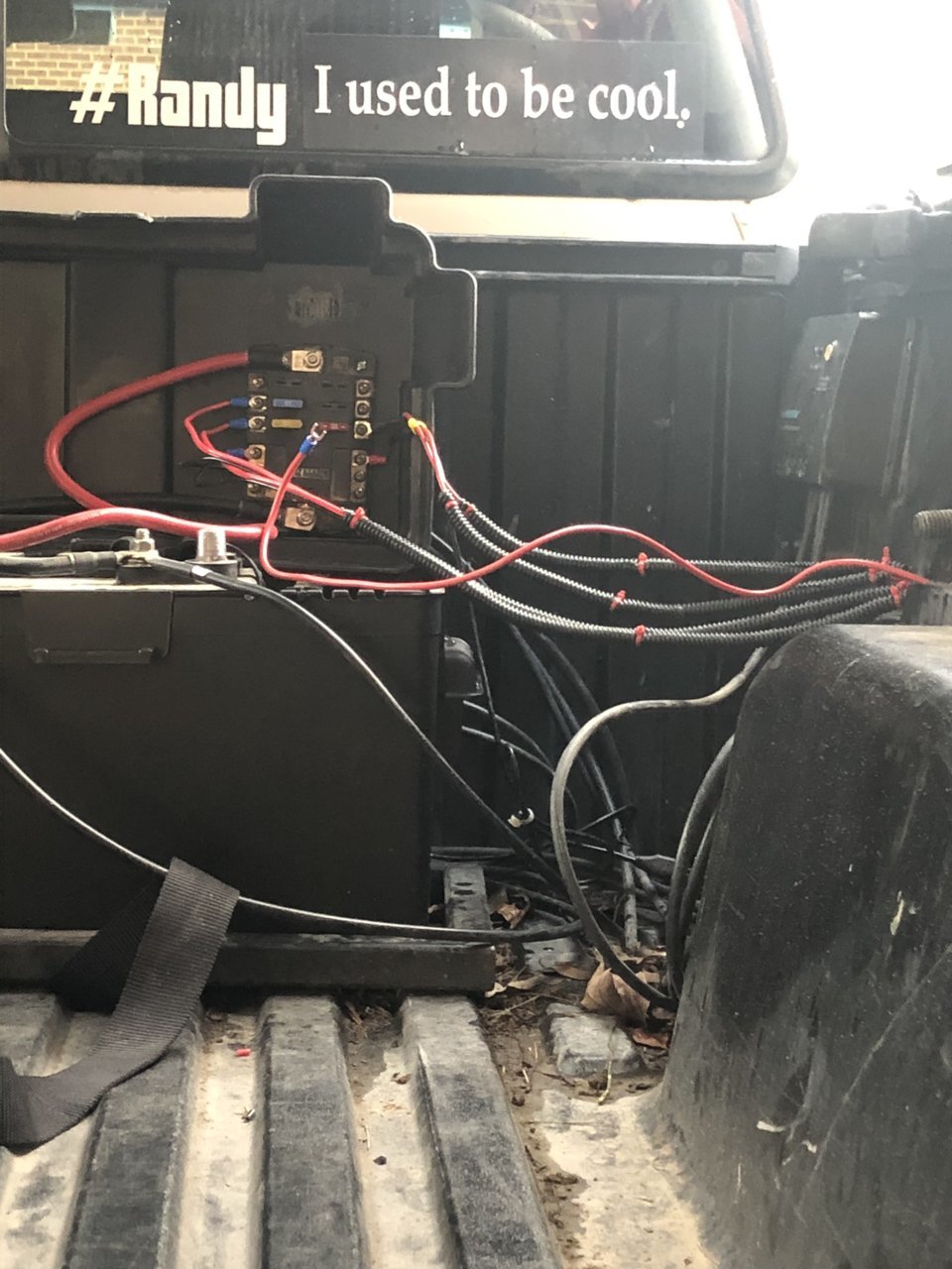

    Awesome question! I have this exact setup. Someone just asked me about it today.
    I have:
    - Duracell Group 24M deep cycle battery - $99 + $10 rebate - https://www.batteriesplus.com/product-details/marine_rv/battery/duracell-ultra/sli24mdc
    - Renogy 100W solar panel kit with 30A charge conroller - can get a better price on ebay - https://www.amazon.com/Renogy-Monoc...&qid=1585689207&sprefix=renogy,aps,254&sr=8-3
    - blue sea 6 fuse setup - $35 - https://www.amazon.com/Blue-Sea-Sys...d=1585689293&sprefix=blue+sea+,aps,224&sr=8-2
    - 3 switches for bed lighting etc, and a 12v plug for the fridge - $30 - https://www.amazon.com/Rocker-Switc...=1585689336&sprefix=3+gang+swi,aps,255&sr=8-6
    - battery box, cables, etc - ~$20
    I have had this setup for just about a year. Its outside in the weather, and I havent had any issues. Fridge is Dometic CFX50W and on all the time.

    David,
    Thanks for sharing that set up, I thought it was going to be super expensive to set up but looks rather doable in price! Now for the follow up question, lol. How is your set up? Everything located in the truck of the bed of did you place the battery in the engine bay and wired everything to the back or wherever your fridge is located? Have any photos of it up on your page? Thanks so much for this info, it really helped!

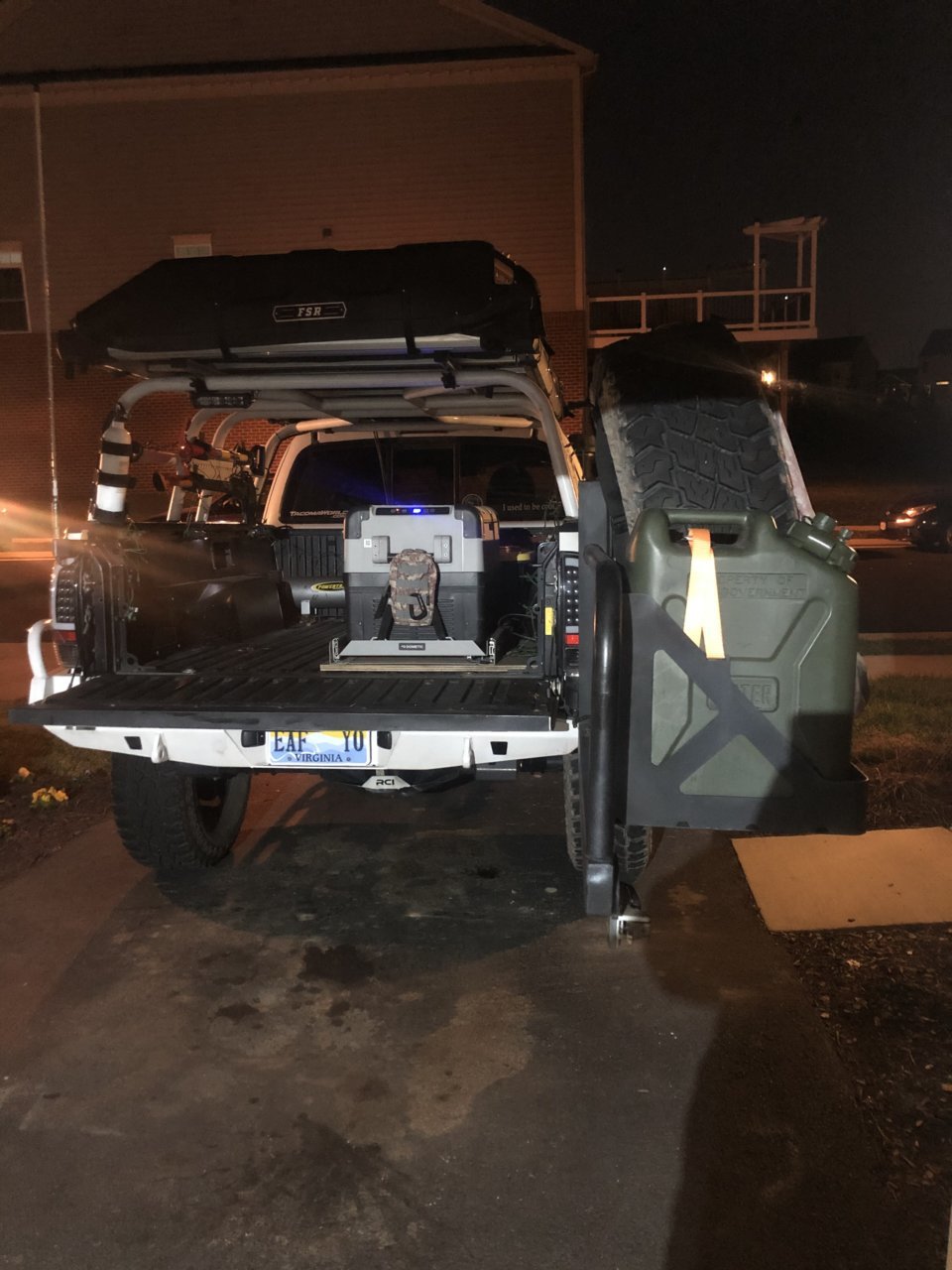

    Everything is in the bed. The second battery is not linked to the engine bay battery. Hopefully these pictures will help you. If not, I can get some better ones tomorrow morning. I drilled some holes in the bed/deleted a cubby for the switch panel, so i could run the wires to the battery. I also want to redo it, as I have the switches wired to a trailer plug harness. I want to get rid of the trailer harness, and wire in the bed lights/accessories directly to the Blue Sea fuse panel - as that is why I have it there.
