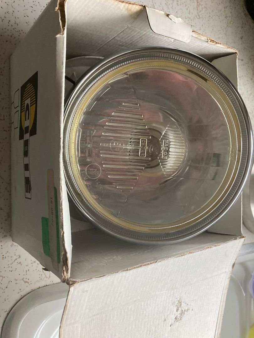

    I'm getting ready to add some additional high beam power to my new 4Runner and have limited options because of the new sensors in the lower grill area. There is however a just about perfect location for a pair of good sized round driving lights. Rago Fabrications even makes a perfect bracket kit to add them. So, my plan is to add some classic Cibie Oscar driving beams that I had in my basement stash on that bracket. Here's what's going to light up the night:
    I'll try to post up some pics when I get everything installed. Having had these lights on a previous vehicle, I'm quite sure these classic beauties will do the trick.

    As most of you know, my recently departed (and much loved) 2014 Tacoma TRD Sport had every lighting upgrade suggested by our very own @crashnburn80, plus a few more like the Diode Dynamics 30" Stage (all driving pattern) LED bar. Quite honestly, that truck had by far the best forward lighting of any vehicle I've ever owned - and that's a lot of vehicles that all had upgraded lighting.
    I knew when I bought my new 4Runner that I was in for a bit of a shock with the stock forward lighting. Unfortunately, "shock" doesn't come close to describing reality. The LED low beams were unimpressive and had way too sharp of a cutoff with virtually zero uplight. The high beams were, well let's just say I had to get out of the truck to verify that they were even functioning. The factory fog lights were pathetic too - just to round everything out.
    The second day I owned the 4Runner, I swapped out the factory fogs for the Diode Dynamics SS3 Max selective yellow fogs out of the Tacoma. Yup, now we're talking! Much, much better. The LED low beams were a bigger problem though because there is literally nothing you can do to upgrade them. Fortunately, the SS3's pretty much make up for the low beam short comings, plus some. That left the high beams. After consultation with the master, I installed a set of HIR bulbs in the high beams. Better? Yes. Awesome? Unfortunately not. In the words of Captain Kirk, "More power Scotty!"
    That leads us to this thread and adding more power to the high beams. As I mentioned earlier, I had the Ultimate Headlight Upgrade (with the NLA Osram Hyper bulbs) plus the DD LED bar for high beams on the last truck. Why not swap the LED bar over to the 4Runner you say? Great question and I'm glad you asked. Unfortunately, Toyota started installing certain safety system sensors in the center of the lower grill in late 2020. So even though one can still mount a 30" LED bar down there quite easily, probably 30% of the light will be blocked by the new solid center section of the grill with the sensor.
    There was another option though. The very same Rago Fabrications bracket set that allows one to mount an LED bar down there also allows you to mount round auxiliary lights on either side of the infernal sensor. This led me to go down into my basement stash to see what I might have to brighten up the night sky a bit. As I mentioned in an earlier post, I stumbled upon a set of original Cibie Oscar driving lights with 100 watt halogen bulbs. They came off of my 1976 Corolla SR5 Liftback that I sold in 1993. Better yet, they were still almost perfect!
    Today - while it was pouring rain outside - my son and I tore into installing the Rago brackets and the Oscars. The bumper cover absolutely needs to come off and it's a bit of a pain - especially with the new sensors. With 2 people, it takes about 20 minutes to carefully remove everything that needs to come out. Next, the Rago brackets need to be assembled and installed. Truth be told, you need to install the upright brackets, then assemble at the horizontal cross members, then play around with way too many slotted adjustments. It's not a terrible design, but I would suggest that it's got a few too many degrees of freedom built into it. You also have to partially reinstall the bumper cover once or twice to make sure your lights are centered where you want them. Here's what it looked like before the final tidying up and shielding of the wiring:
    About 2 hours later, my son had to leave and we decided to put the project on hold with only the final wiring of the relay (triggered by the high beams) and aiming left to do. Here's what it looks like from the outside:
    Hopefully the rain will stop in a few days and we can finish up the wiring and get these monsters aimed. I have high hopes for these bad boys and will post pics up as soon as I can.
