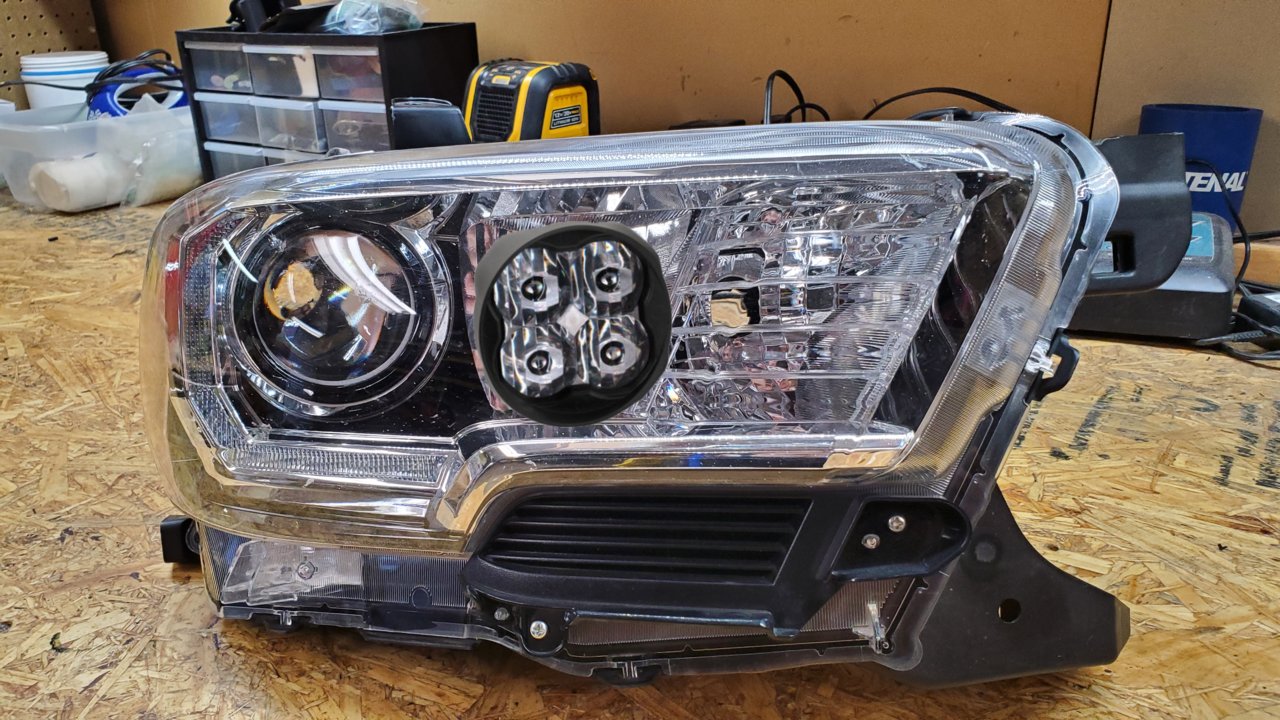

    So I just picked up an extra set of stock headlights for cheap to aid in a RX350 retrofit. I was originally planning on a set of SS3 Pros in 4000k behind the grill to compliment the high beams, but now that I don't necessarily need the halogen high beam, what would be the reason to not mount the SS3 pods inside the headlight assembly? Another member did it with BD Squadrons, and outside of not having an SAE pattern I think it looked clean. The biggest potential issue I can think of is heat, I know crash clocked these at ~200 F, but the stock halogens also put out a fair bit of heat. I am counting on mounting being tricky, but the extra set of lights mean that I don't have to hurry on these.
    Any other things that I should be aware of?
    Poor photoshop for kicks-

    I would contact @Diode Dynamics to see what they would say. My only concern is thermal management since it would be in a sealed housing with no air flow. I believe it would handle it just fine but would dim to protect itself from overheating.
    Either way, I think it would be awesome! I've thought about something similar with the SSC2's and the amber backlight for a turn signal/running light.

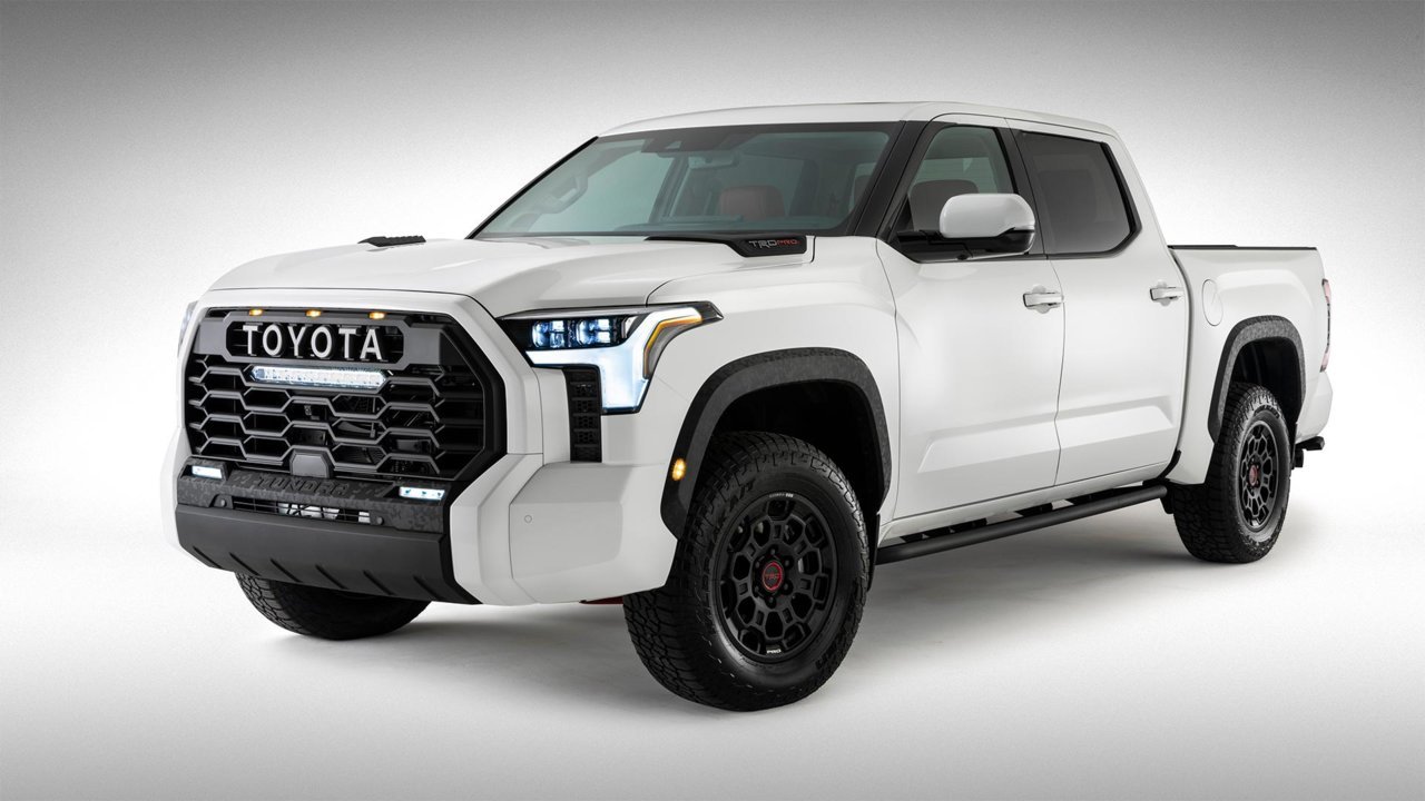

    Looking at the new Tundra front end- it looks like they've decided to incorporate light bars as part of the auxiliary lighting package on the TRD Pro. The lower pair may be fog lights (as I don't see anything else low in the bumper), while the higher bar in the center of the grill could be an SAE auxiliary driving light? I don't see a split in the center of the bar, as Rigid has done for their street-legal bars.
    Also of note are the amber marker lights in the grill and corners, signifying that this truck is wider than 80".

    Possibly… but not necessarily. They’ve been used as styling elements before. Don’t quote me on this, but I’m pretty sure the new GMC Sierra heavy duty trucks have them but don’t need them.

    I’d be curious if the high beam light bar is part of the production design and not some extra styling element for marketing photos. The split in the center of Rigid's bar is only required if output intensity exceeds the J581 candela maximum, essentially making the one bar two lights each subject to the max spec independently vs one light subject to the max spec as a whole. Clever workaround on the regulation. As to the marker lights, let’s hope it isn’t 80”+ wide. Last thing new trucks need is to be even larger. The Tacoma is supposed to share the same frame with the Tundra in this upcoming generation.
