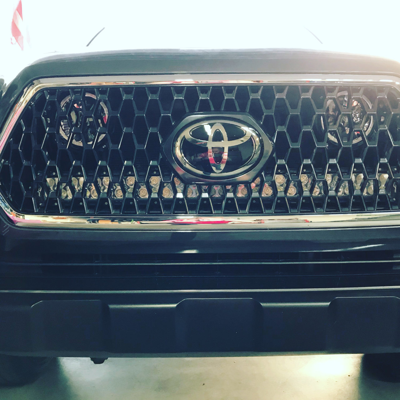

    #281

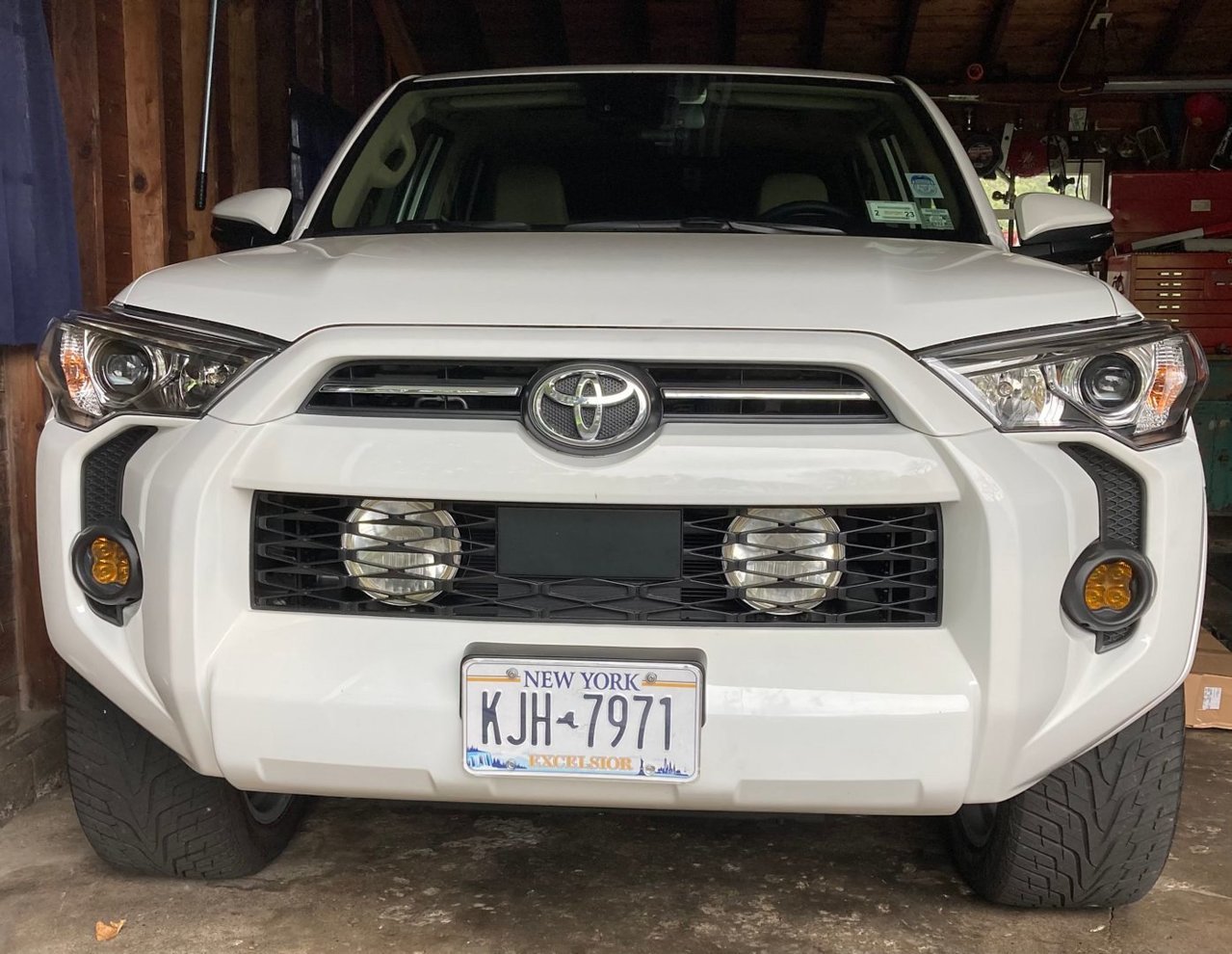

    You mean like this? Yup, they're Oscars alright. They were sitting in my basement for over 30 years until I pulled them out for the new 4Runner.

    I’m planning on Oscars or Hella 700FF for my driving lights. I’m not too worried about strict J581 compliant because I will have them wired to my high beam circuit for street use.

    For your specific purpose I’d agree with @MrMccrackin and take note about the comment on mounting location to avoid the counterproductive hood glare. The Pro fogs will also help with light out to the sides, and pros have more spill and a wider angle than the other fogs, which will be helpful for your purpose. A center mounted front Baja combo bar isn’t going to give you significant light to the sides like your other solution would, and if you are already planning on driving lights the bar doesn’t seem like it would provide a significant purpose other than just more light.
    Depending on your grill situation, you might consider some Diode Dynamics SS3 Pros in selective yellow with a clear driving lens swap. That would provide 4000k output in a more compact platform that would block less airflow to the radiator.
    Also, I have a spare BAMF behind the grill light mount, PM me if interested.
    https://www.bayareametalfab.com/2005-2021-Toyota-Tacoma-Behind-the-Grille-Light-Bar-Bracket_p_9.html

    Agree that the SS3 Pro will be easier to mount, but will the lower CRI (in the 70s with a clear optic swapped on) have any negative effects? I can understand @Cwopinger's choice of halogen, specifically in regard to the color temperature and the CRI of 100. Does a light source with sub-optimal CRI cause eye strain?

    Is it possible to source the Cibbie super Oscar 9” in halogen? That’s what @Too Stroked has? But he bought his many years ago?
    I see plenty of LED versions for sale at rather reasonable prices but a quick search isn’t finding halogen.
    Do we have any rough comparisons between the LED 9” oscars and the DD SS3 MAX in driving pattern? The more compact SS3 seems easier to mount and not significantly more expensive.
    Perhaps there is a KC or Hella halogen option? Or is everyone ok with halogen base headlights and LED aux lights purely because cost?

    I have the 7" Oscars. The 9" are the Supers.

    Dan Stern used to be the go-to source for anything Cibie. However he has noted that cibies stamping dies for their lenses are getting at the end of their useful life (so an older production lamp with an intact reflector may be a better performer than a new one). He currently just asks people to email him about auxiliary lamps and fogs.
    I don't have a driving beam optic for my SSC3 pods, but I can try to get some pics posted up this week with some comparison shots of my LED super oscars, SS12 bar and SSC3 pod with spot optics.
    Back around page 3 there was a member who posted photos of his Hella 700FFs.
