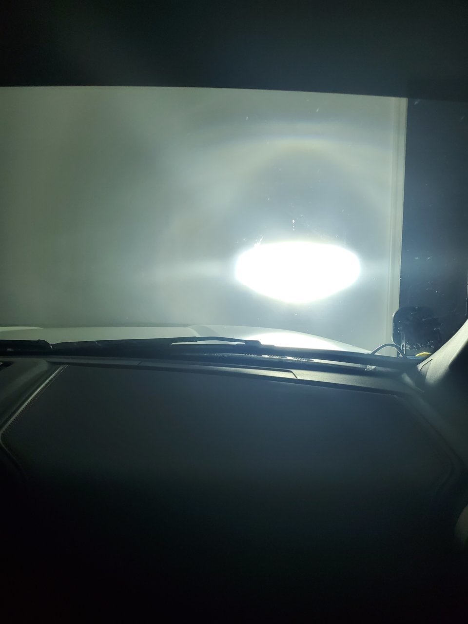

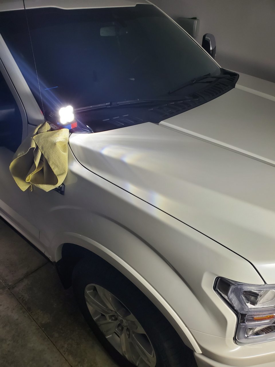

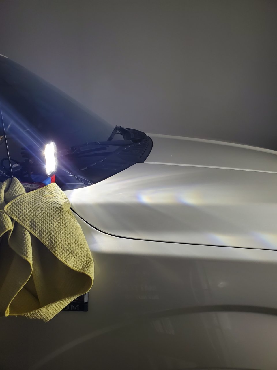

  14. Sep 19, 2021 at 11:41 PM
    #354
    toledoupsguy
    toledoupsguy Well-Known Member
    Jul 19, 2021
    #371680
    293
    Haskins OH
    2020 Ford F-150 platinum
    This is not up to what I've seen as tacomaworld standards but it was a quick and dirty check for hood glare. No on road pics. Ammo box looked like a good match for the height of the cowl mounts. Not sure if it was correct or not but I aimed the light level or straight out. Used the passenger side because there's a larger flat spot in the correct spot than the driver's side. Adjusted the passenger seat to same position I drive in. Really don't think there's much glare looking at the hood from outside and not sure what you see from inside isn't the blindingly bright beam reflected back. Either way with the higher height of the driver's side dashboard and steering wheel in the way don't think you'd notice much at all driving. What do you think?
  15. Sep 19, 2021 at 11:47 PM
    #355
    crashnburn80
    crashnburn80 [OP] Vehicle Design Engineer
    Jun 6, 2015
    #156893
    14,771
    Kirkland, WA
    2003 DCSB TRD OR
    Good mock up! Aside from light immediately in-front of the lamp it looks pretty reasonable for a forward ditch light mount. I've also noticed this very short vertical spill with the TIR optics. However in nearly any other prod product, you'd have the entire hood illuminated like that spot just right in front of your SS3s.
    toledoupsguy[QUOTED] likes this.
