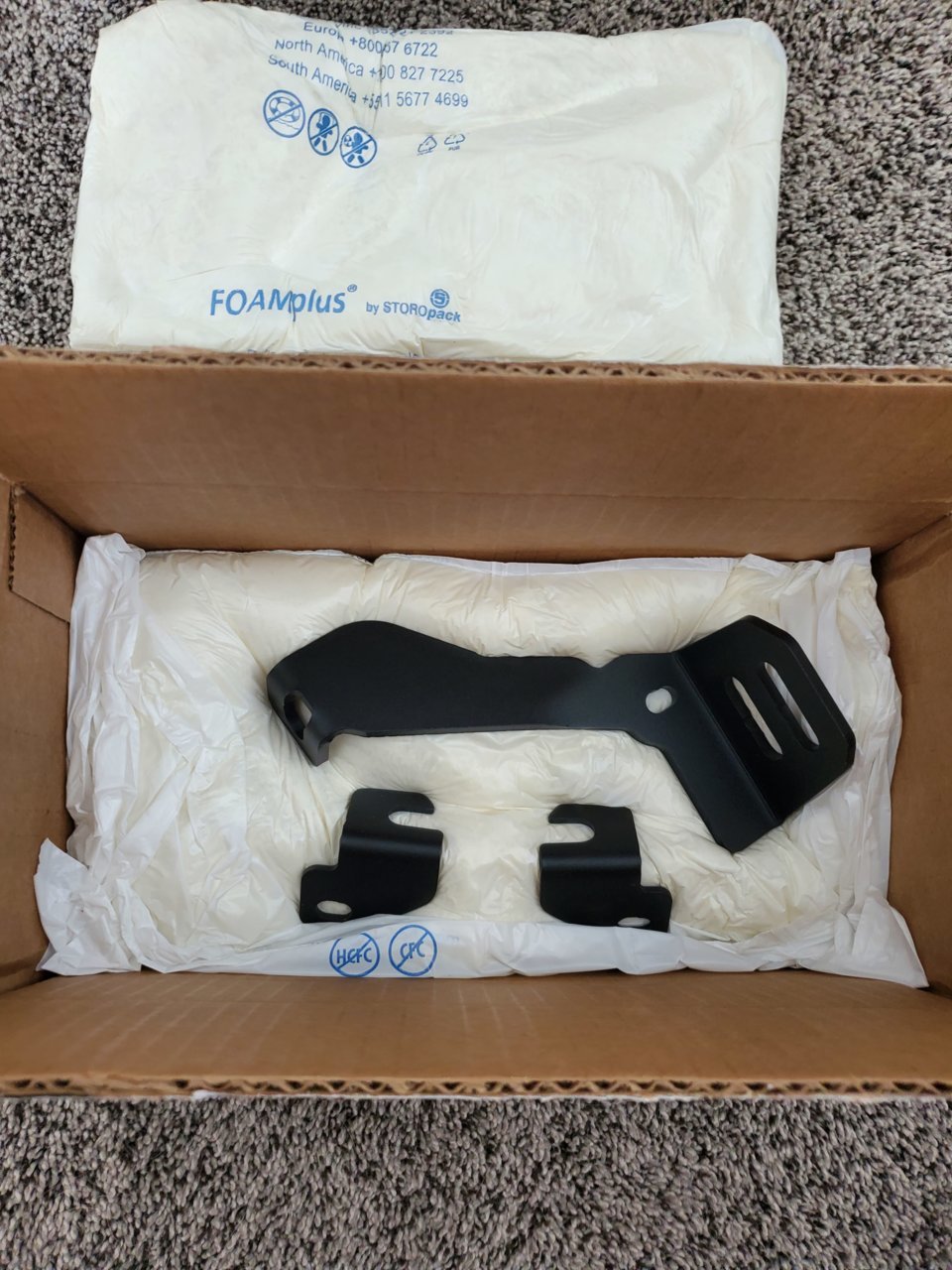

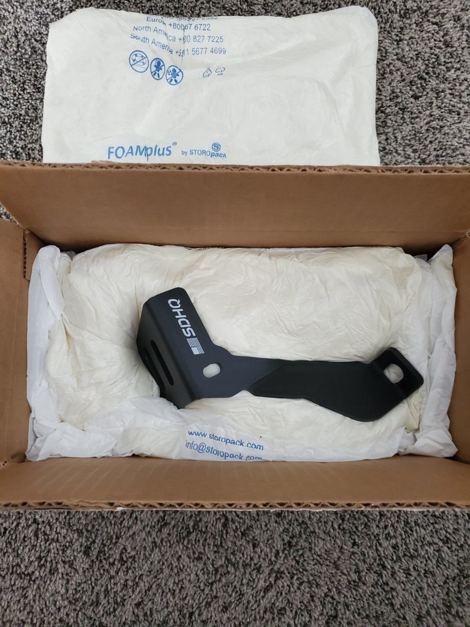

    I have been struggling with what or how I'm going to mount the SS3 max driving I got from memario for a while now. There is a really nice 2 pod mount from KDF to replace the single fog in the bumper but others report it is an absolute PITA to aim the lights once installed. I looked at rigging something up to put the driving lights in the intercooler opening in the bumper but they would probably be too close together. KDF, BD and others make a mount that goes there for 20" light bars and I thought I'd use that for the pod brackets but I'd have to remover the ACC sensor to mount the drivers side bracket and that meant realigning the ACC radar. I really did not want to do what is the easist solution, A pillar mounts, because they don't fit my looks like it came that way desire. Oh well, decided to go that way anyway. There are A pillar mounts for the f150 everywhere from $39 to $150. Even the 39 seemed high for a stamped piece of metal. Was going to go with the DD mounts, didn't really want to deal with having to loosening the hood mounts and then found these from SDHQ. They're the most expensive of the mounts by far but are 2 point mounts (good for stability) and don't use the hood mounts (yea no possible alignment issues) so I ordered them on their black friday sale. Memario if you sell these sorry I didn't know and was too lazy to look.
    I was initially a little disappointed when I ordered them. Everybody and their brother is offering free shipping but not SDHQ. But the package came today and I have to say I'm not sorry about the $10.95 shipping after opening the box. I doubt my pictures will do them justice but this is the best packaging job I have ever received. Way to go SDHQ. Being in the shipping industry and seeing how packages are treated I go out of my way to make sure whatever I might sell to someone will get there unscathed but this makes my efforts seem weak.
    Nothing special about the box other than I noticed there was no rattling of the goodies inside
    Here's why, no open space in the box. 3 layers of a formed foam around everything. In a day when companies and people just don
    t give a crap this was a very pleasant surprise.
    Would absolutely positively buy from these guys again.
