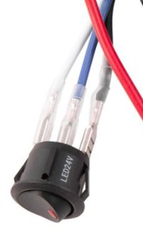

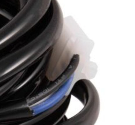

  8. Dec 3, 2021 at 12:30 PM
    #448
    daveeasa
    daveeasa FBC Harness Solutions
    May 14, 2020
    #328079
    7,483
    David
    PNW
    2016 Tacoma OR DCSB 6MT, 2005 RC 5MT PreRunner, 2002 Tundra SR5 RCLB 4x4
    Switch illumination is typically PWM dimmed rather than chassis ground. Hence the illumination harness option. Highly likely we could get something going for the 470, lots of common connectors among various Toyota vehicles.
    white is most likely ground. Meaning the blue is either sent ground (off) or +12v (on). Also possible white is power and black ground depending on how the switch works. Quick testing will tell you.

    Gotcha! I sent a message to DD to clarify which wire does what. If blue is the trigger and black is ground then I'll assume white is +12v. I'm also going to assume I don't want to connect the white from the DD harness to the green on the AOB. As that would be sending +12v to the switch all the time even when the car is off because the harness connects directly to the battery. IF that's correct thinking, then where would I connect the white wire?

    If you want it ignition switched, you likely want to add a fuse from the in cab fuse box, use that to feed the switch +12v input, then switch output to the blue. The other two wires to the switch are illumination + and - as discussed. The white and black from the harness can be effectively ignored and left floating, just use some heat shrink to protect them or at least some tape.
    As an alternative to cutting off the switch you can likely de-pin it at the connector:
    And then all you have to do is connect your switch output from in the cab to the blue in the harness connector. Ideally with one additional terminal you crimp on but also possible to just wrap bare wire and enclose in heat shrink.

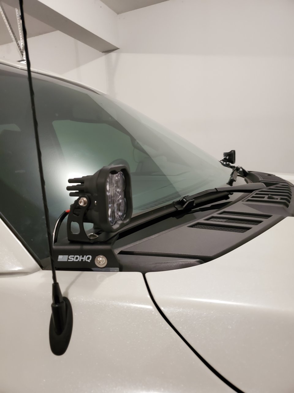

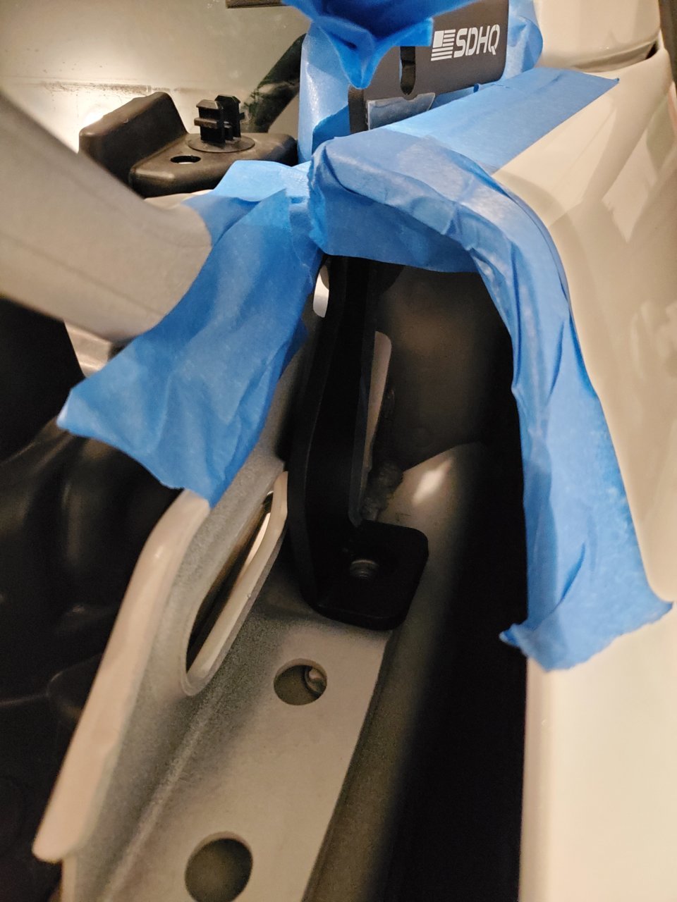

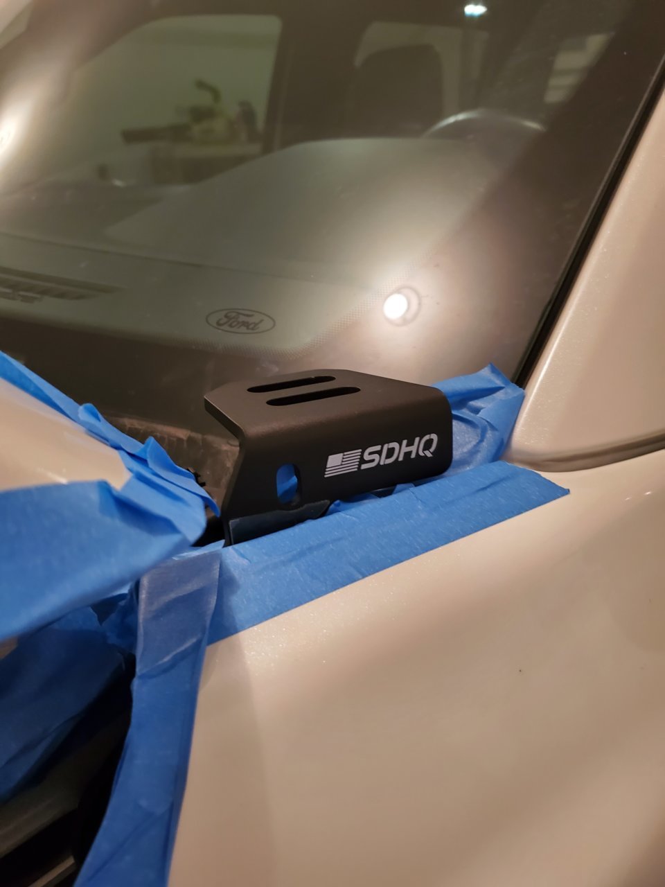

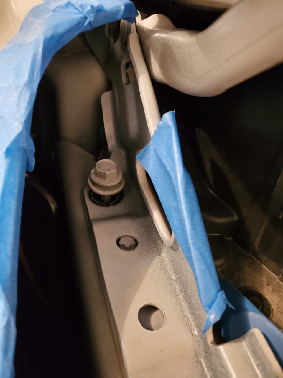

    #455
    toledoupsguy
    toledoupsguy Well-Known Member
    Jul 19, 2021
    #371680
    293
    Haskins OH
    2020 Ford F-150 platinum
    Looks really nice for an aftermarket look but what a PITA. First bracket took about 2 hours. Something about some moron (me) dropping the bolt into the black hole of the fender well. Had to remove the mud flaps, part of the fender flare and 2 lowered bolts of the fender liner. Reached in with a magnet and pulled out the bolt. After all that figured out why they supply replacement bolts, freaking factory bolt won't fit anymore, fitted washer is too wide. Grrrrrr.
    2nd bracket took about 10 minutes, we're flying now. Now time to mount the lights. Diode Dynamics why the heck a washer, locker washer and nut, why not use a lock nut???? Hope it wasn't to save a few pennies on $500 lights. Anyway, not much space to try getting your hand in to hold 2 washer and thread on the nut. Decided to put a rag under incase I slipped. First one went smooth. Thought the second one did too until I pulled out the rag and heard a tink tink tink. Lock washer gone and time to scrounge another. Can anyone say lock nut please DD.
    Have not finished up the wiring yet. I was going to use high beam tap trigger but I'd like to be able to use the off side of the switch to keep it off even if the highs are on. Can someone please tell me how to do that? Also have a remote switch coming tomorrow to link to one of the homelink buttons.
    TacomaONT, Toy_Runner and Too Stroked like this.

    They replied back:
    "The black wire on our wiring harness is ground, the blue wire is the power to the relay and the white wire is power from the battery."
    So it's as we assumed. Should be easy to wire up.
