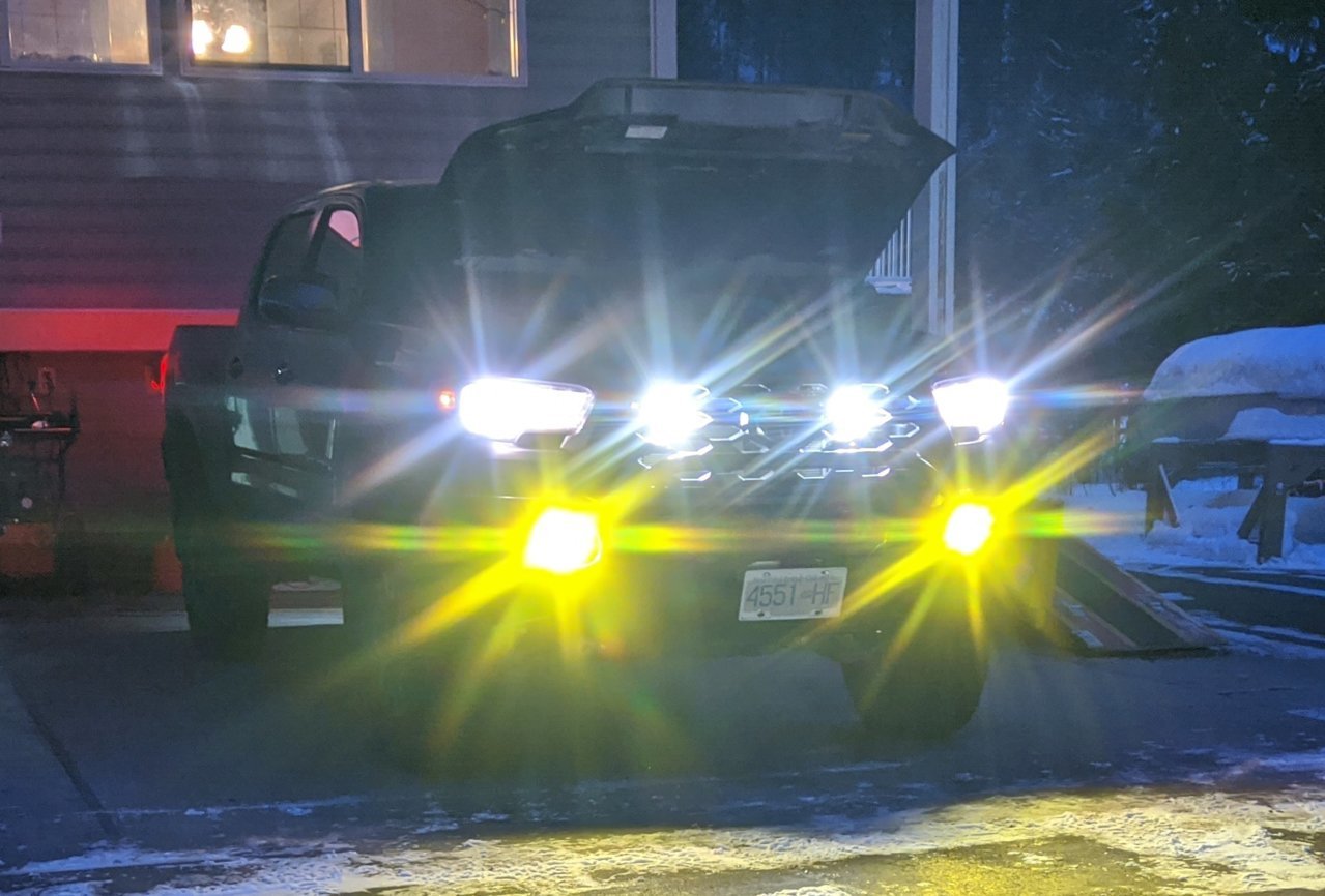

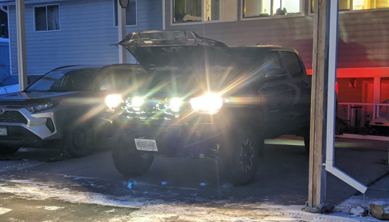

    Finally got the lights wired in as planned.
    SS3 Pro 4K driving on a BAMF behind the grill mount.
    Blue Sea fuse box and 60 amp breaker mounted on to of engine bay fuse box.Fuse taps off high beam and low beam in the engine bay fuse box.
    Relay mounted to inner fender.
    Anytime backup camera High/Low 3 way switch.
    They are switchable with low beam for when I'm off road or with high beam as auxiliary high beam.
    I need to decide on cutting "windows" out of my grill.
    I've never done any wiring before, bought some tools, connectors, wire, shrink wrap, loom and build my own harness. Took my time, kept checking continuity as I made connections and it all worked. Just glad I'm not paying myself by the hour for it.
    Still need to clean a few things up and aim them, then I'll add some pictures.
    Thanks for the advice and suggestions.
    Aws123 and mynameistory[QUOTED] like this.

    SS3 Pro fogs, H9 low beam and 4K SS3 Pro driving
    High beam with 4K SS3 Pro aux high beam.
