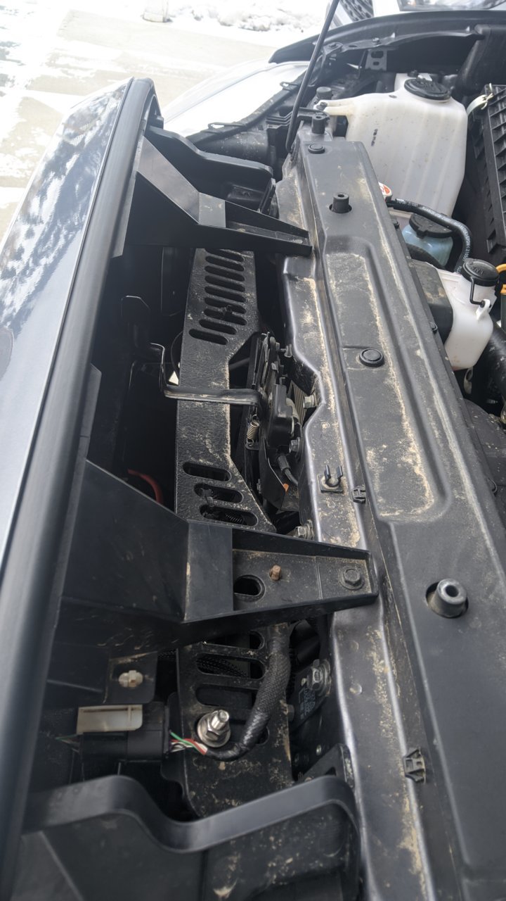

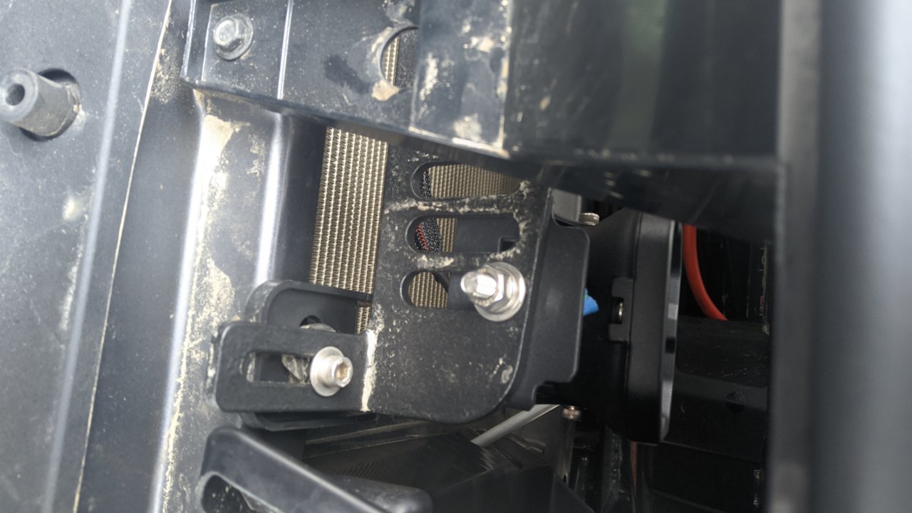

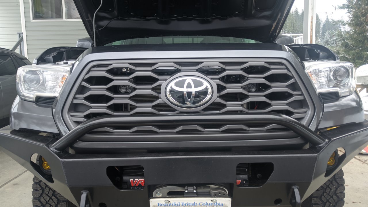

    Here are some pictures of the bamf rack with the pods. I'm leaning toward cutting the grill.
    I took some pictures of output that I'll put in the Diode Dynamics thread. Snow covered road (Canada in February) and no fixed camera setting but they mirror what I was seeing.

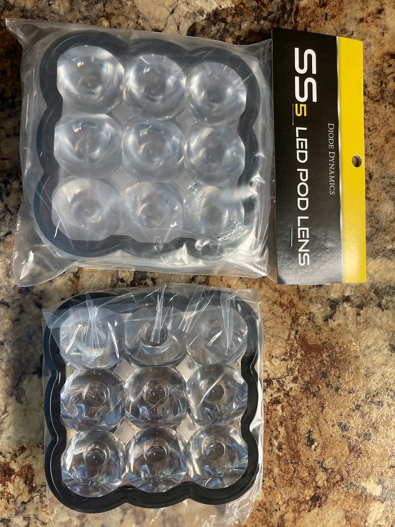

    Hmmm, I wonder what I should do with today's delivery? Output pics when (or if) it ever stops raining around here.

    Here's a top tip for anybody swapping lenses on SS5's. Although they may look symmetrical and thus should fit no matter how you rotate them, this is not true. There are two triangular shaped posts on one side of the lens that are designed to slip into two similarly shaped holes cast into the pod base right beside one edge of the circuit board. Both of these features are pretty small, and you really have to look for them. I'm not sure what happens if you have the lens 90, 180, or 270 degrees off, but I'm pretty sure they built these features in for a reason.
    Edit: I should have thought of the 90 and 270 degrees off issues. (Horizontal pattern fogs.) But 180 degrees off (upside down) will also be avoided through the use of Poke Yoke. (Japanese for Mistake Proof / Fail Safe.)

    I think the poka-yokes are featured in all of the pods. Probably to make sure that people don't end up with vertical fog beams or other silliness. It makes it harder for people with rotated mounting positions though. I think they can be gently ground down with a Dremel with no ill effect for those corner case situations.
