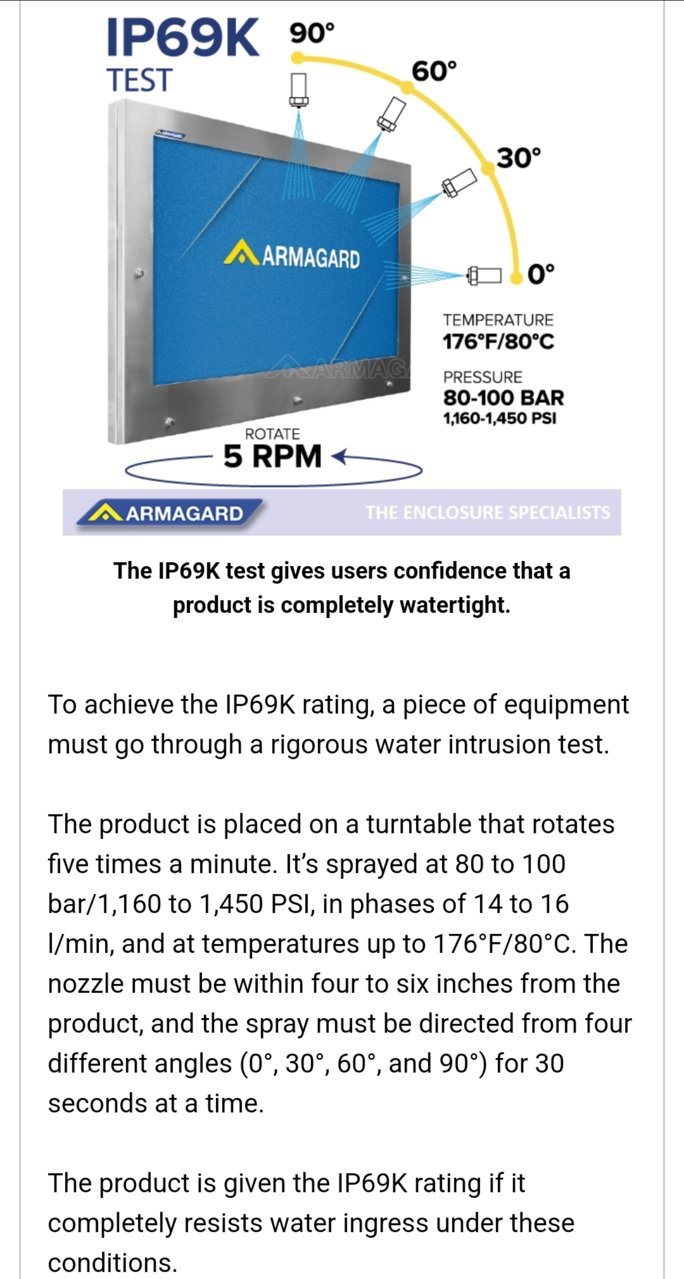

    I just read the DD SS 30" bar is only IP68 rated. Has anyone ever had a problem with this? :confused: (Condensation, leaks, issues with dust, etc?)
    I'm bummed it's not IP69K rated like the SS3/5 pods. Why not, especially when some inferior competitors' bars are IP69K? I'm suddenly wondering if I should be looking at other brands for my bar? Ones with an IP69K rating. :eek: :annoyed:

    I'm guessing this is for the breather valve, Ip69k has to withstand a 1450psi water stream from 4 inches away.

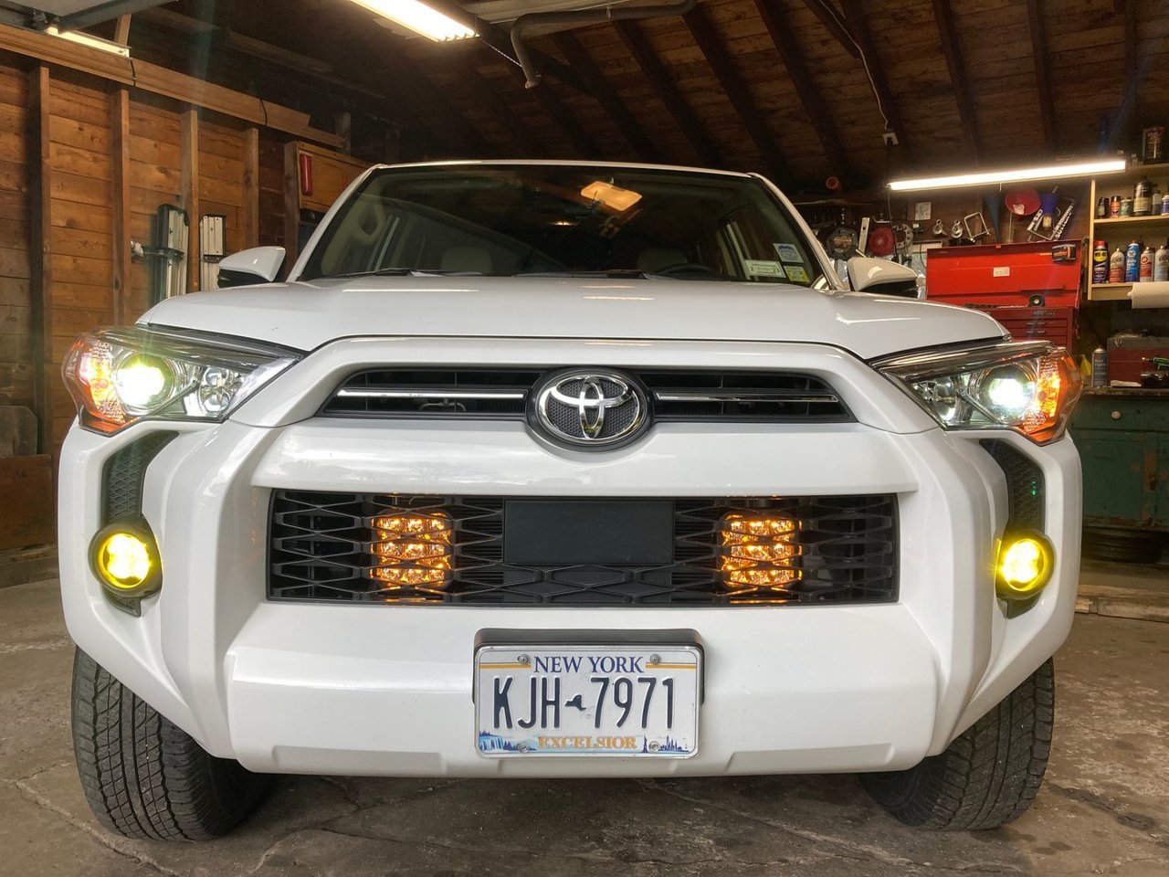

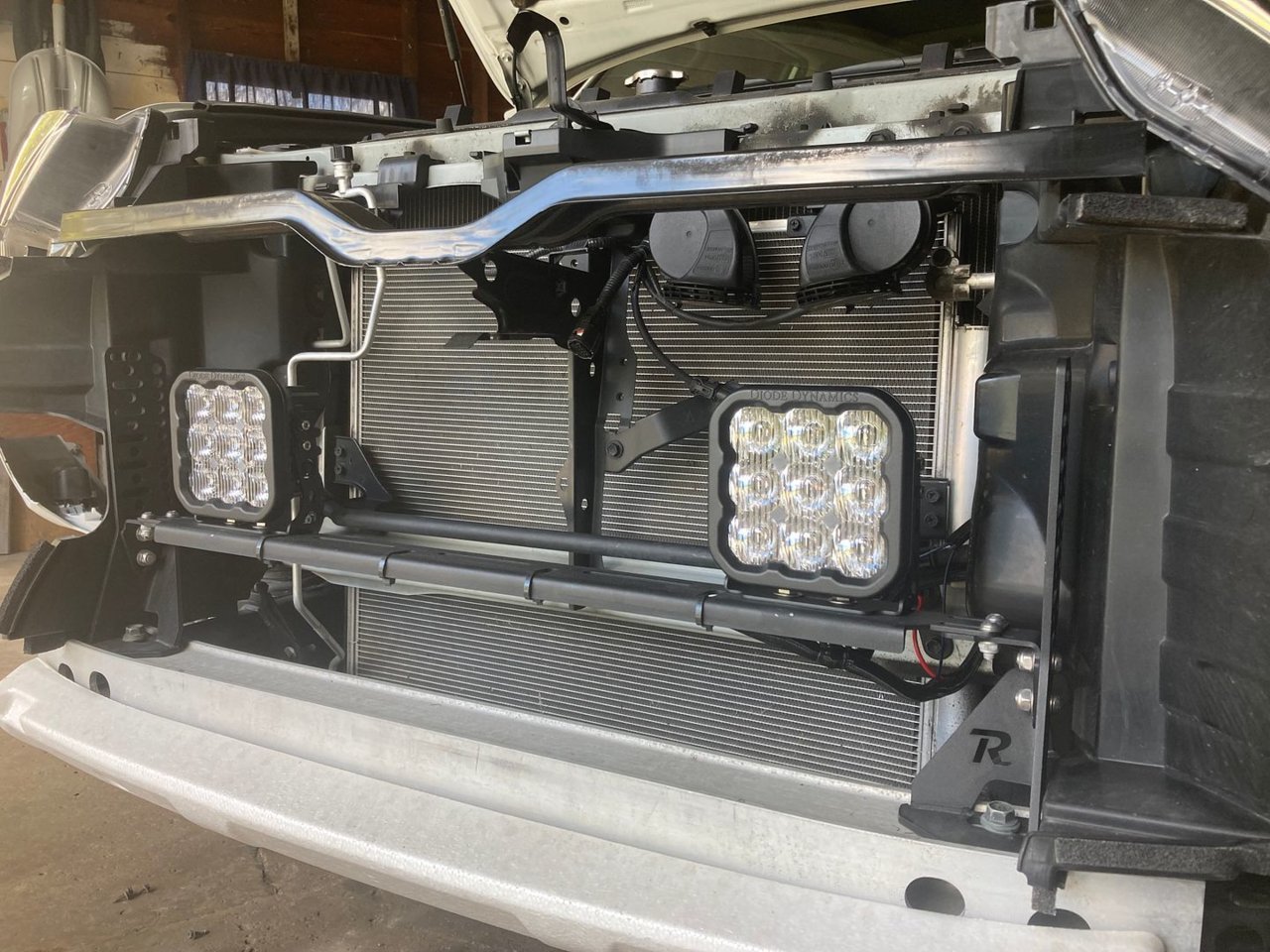

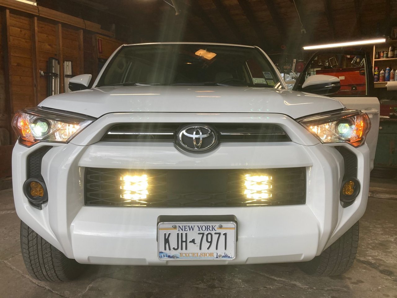

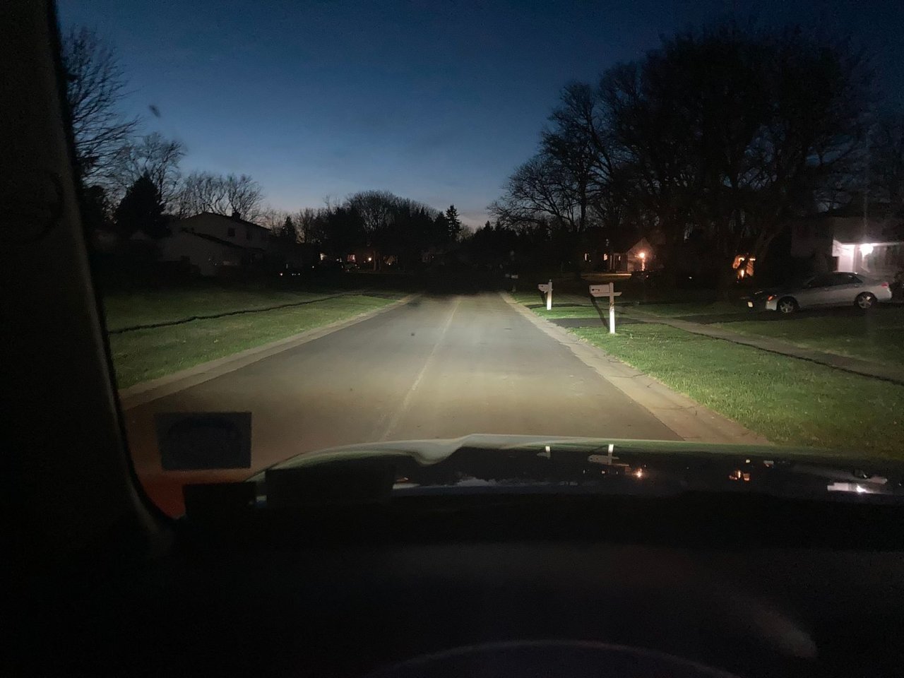

    Actually, I swapped the factory supplied H11's for the HIR1 Toshibas - which are pretty hard to find these days. Although this did increase my high beam performance, adding the Diode Dynamics SS5 spot beams tied into the high beams was the real ticket for success.

    My headlights are the OEM LED low / halogen high beam ones. Trust me, the low beams are great and the SS5 enhanced high beams are more than one could ever ask for.

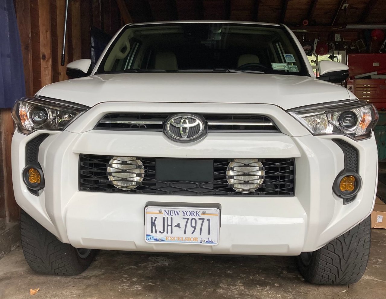

    This is what I did for visibility prior to going OEM Led. I have ssc1 sports with the fog lense. Not enough output for a legitimate fog but a really visible light for other drivers.

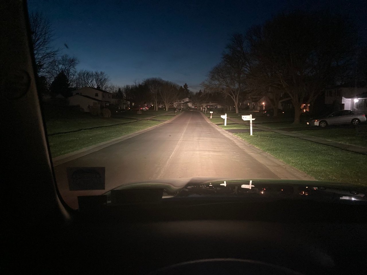

    Old output shot from previous configuration:
