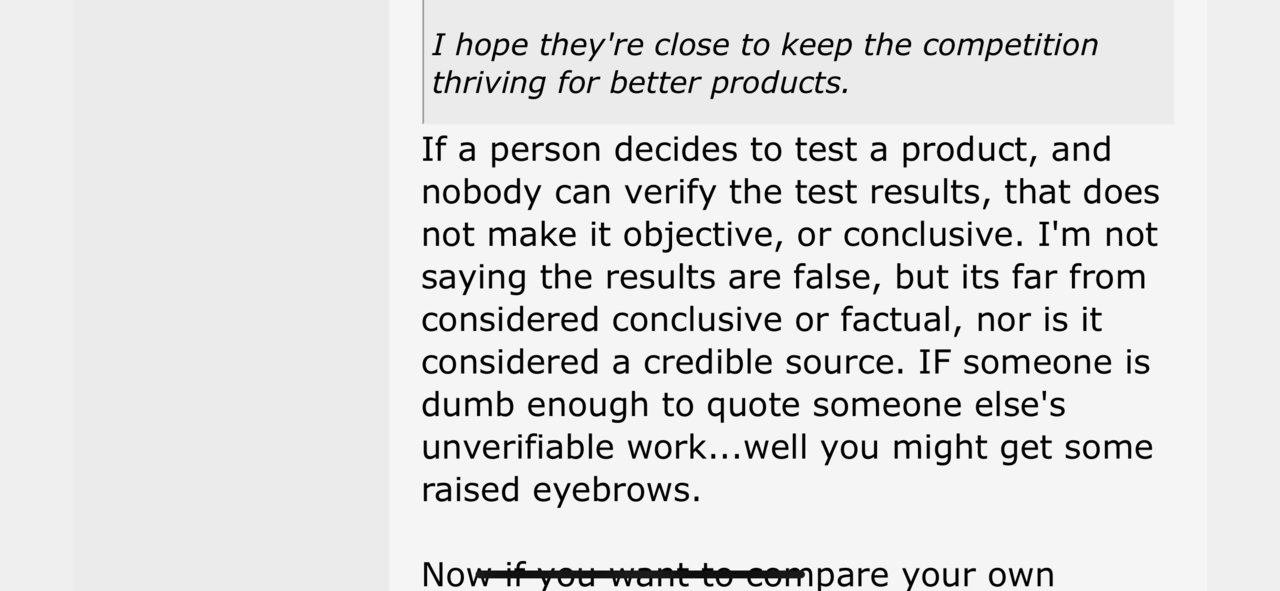

    I linked one of your threads to another forum and one of the guys says you’re not that objective… o_O

    Let me guess. Mr. Blah?

    I figured as much. He and I have had words.

    That thread is discussing ditch lights specifically, which have a lot more subjective criteria for judgement than road-legal lighting. Not worth going into the weeds over. I did find it funny that the OP kept repeating that he wasn't getting compensated, while also keeping the free lights he received in exchange for the review.

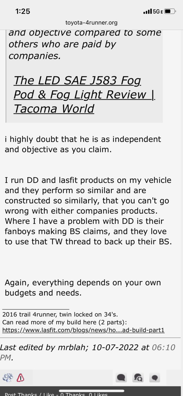

    Has crash stated he receives the lights for free or in exchange for a review? I don't follow this thread regularly.

    This guy does not seem to understand what some of those words mean.

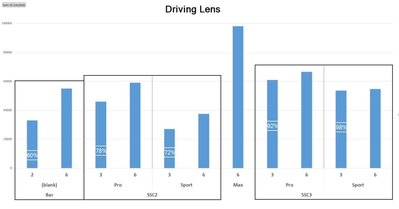

    I am looking at adding the SSC2 driving light to an SUV since the best spot is going to be behind the grill, but it doesn't look like excessive cooling air intake area.
    SSC2 Pro appears to have about as much intensity (candela) as the SSC3 per DD spec sheet, as @crashnburn80 pointed out they can drive it harder because the better surface area to volume ratio for cooling. Over in the SAE fog thread, he also confirmed DD is using a different emitter for the 3k selective yellow vs 6k white SSC3, allowing a lens swap to get a 4k SSC3 from the selective yellow version.
    Question for the hive -
    Based on the DD spec data for the driving lens version it appears the SSC2 has a lot more loss for the 3k version. It's not as severe of a loss as the stage series bar going from 6k to 2k, but certainly doesn't look like the minimal SSC3 loss. That makes me suspect the SSC2 might not be using the same 4k emitter as selective yellow SSC3?

    Never noticed this, but this is what I could find on the LEDs, DD lists SS3 as XP-L HI and SSC2 as XP-L.
    From Cree:
    "The XLamp XP-L HI LED is the first of Cree LED’s new class of high-intensity LEDs optimized to deliver maximum candela through secondary optics. Built on Cree LED’s breakthrough SC5 Technology® Platform, the XP-L HI LED delivers 120 percent more candela than the XP-L HD LED through the same optic. The XP-L HI LED leverages the industry’s highest singledie performance and a new innovative primary optic design that radically reduces the optical source size to deliver both lumens and intensity."
    Sources: https://assets.cree-led.com/a/ds/x/XLamp-XPL.pdf

    The (usually) silicone dome over an LED chip enhances the efficiency of it, in terms of lumen output v input power, because it helps pull and redirect light that would otherwise be "lost" inside the flat lens due to internal refraction. The downsides are that the dome also effectively "magnifies" the apparent die size, reducing its apparent intensity (cd/mm^2) at a rate that exceeds the gains in total output made by redirecting low angle light output up and out of the chip. The same die under an xm-L/xp-L dome would be "more efficient" than when measured under the flat lens of the -HI variant. But the -HI does not increase the apparent die size/decrease the intensity, meaning it can be more effectively focused (which is increasingly important the smaller the optics package is).
    I'd be surprised if the SSC1/SS2 uses the xp-l in a domed variant. The optics are effectively the same size as the SS3, correct?
