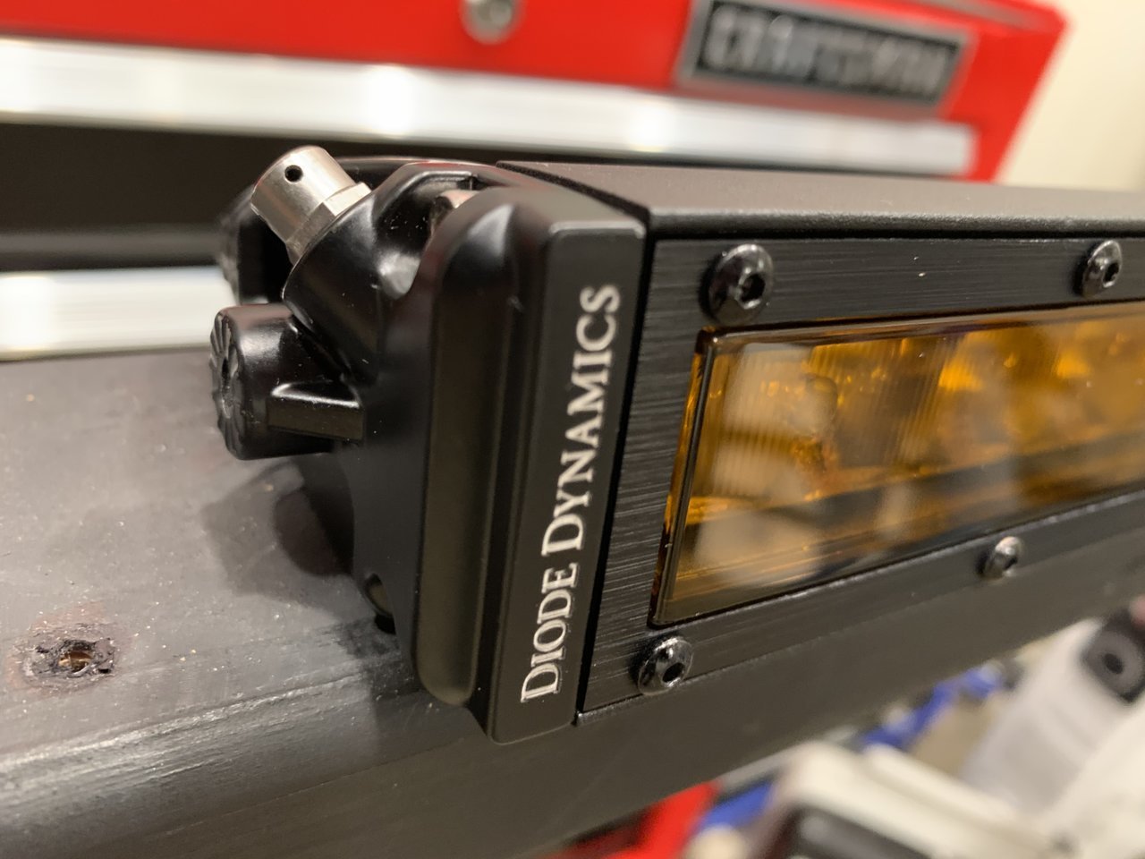

    Or just pick up a Diode Dynamics Stealth kit which will have brackets designed to marry up the Tacoma to the Stage Series 30" :thumbsup: Unless there's a different desired mounted position that is (further forward).
    I'm not official DD but...
    • Optics are in fact swappable
    • All light bars use the same 6000k emitters (unlike SS3/SSC2)

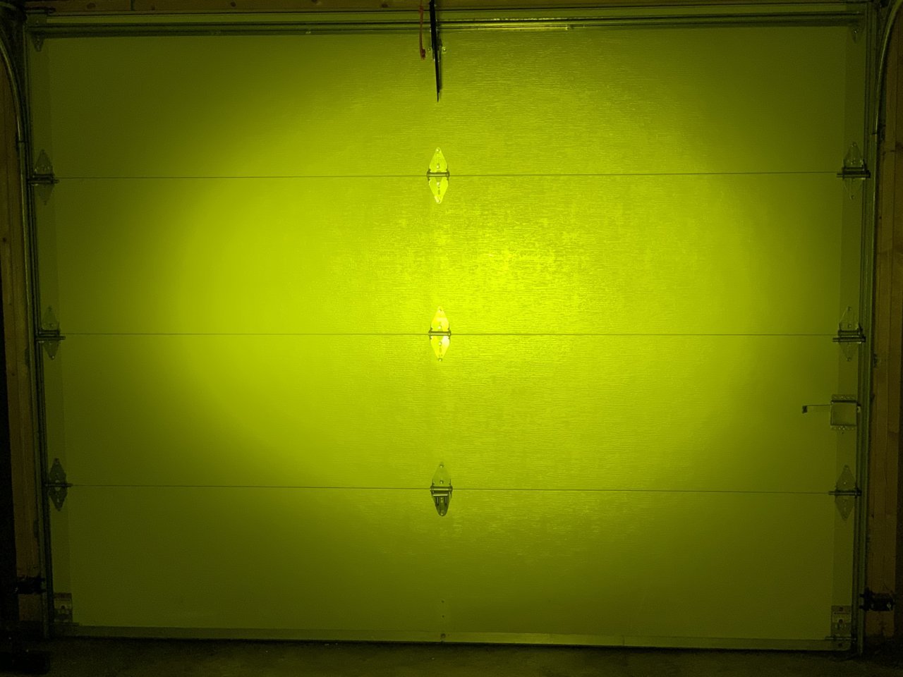

    Yep. Because of the darker color, the yellow optics on the bars are less efficient and the output is more significantly reduced. Also there is no spot pattern for the stage series bars- only driving, wide, and flood (and any combos thereof).

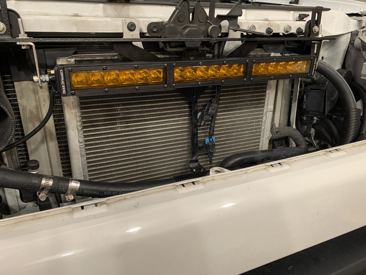

    I have this post covering mounting an 18" Stage Series driving light bar behind the grill. In this case the 2nd Gen Pro grill provided minimal obstruction as the entire top part of the grill is open. Note that Diode Dynamics calls these bars 'amber' not selective yellow which is incorrectly stated in the post below. Unfortunately my test tool was offline at the time due to a software upgrade issue, so I don't have data to compare color temp and chromaticity.

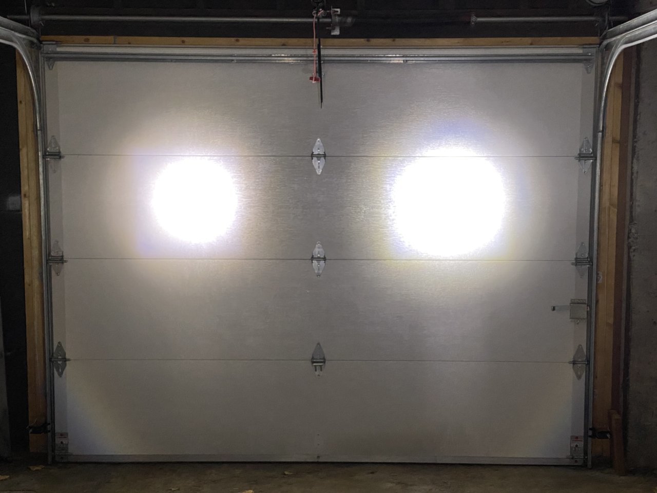

    SS3 Max Driving (not SAE compliant due to intensity)
    SS3 Pro SAE Driving
    Pro vs Max
    The max pattern is more rectangular like the Sport, covering a slightly smaller area. But the Max output is extreme, nearly 60% higher in intensity by my measurements than the Pros. The Max performance is incredible for a pod product, though again the Max is not SAE compliant with the driving optic as output intensity is too high.

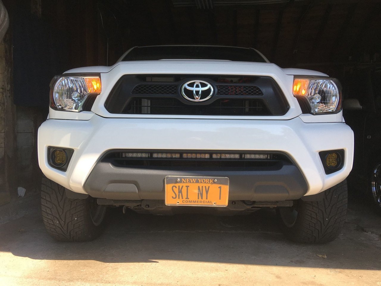

    DD 30" Stage series bar (all driving pattern) on CaliRaised brackets.

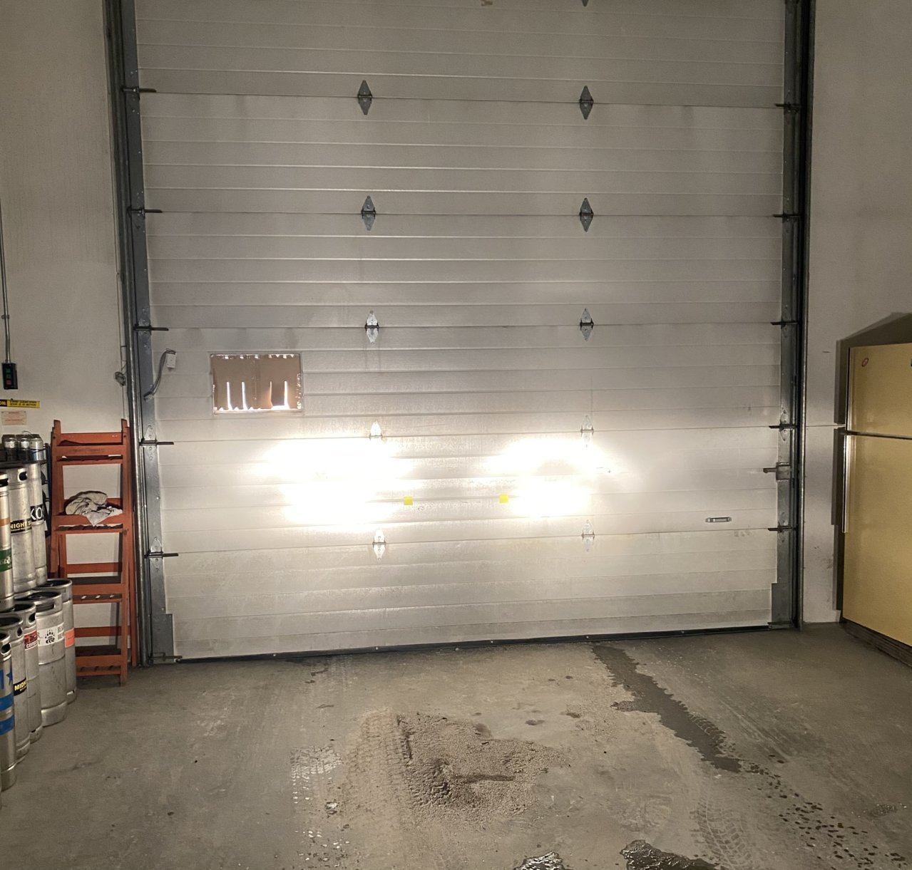

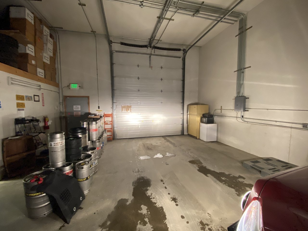

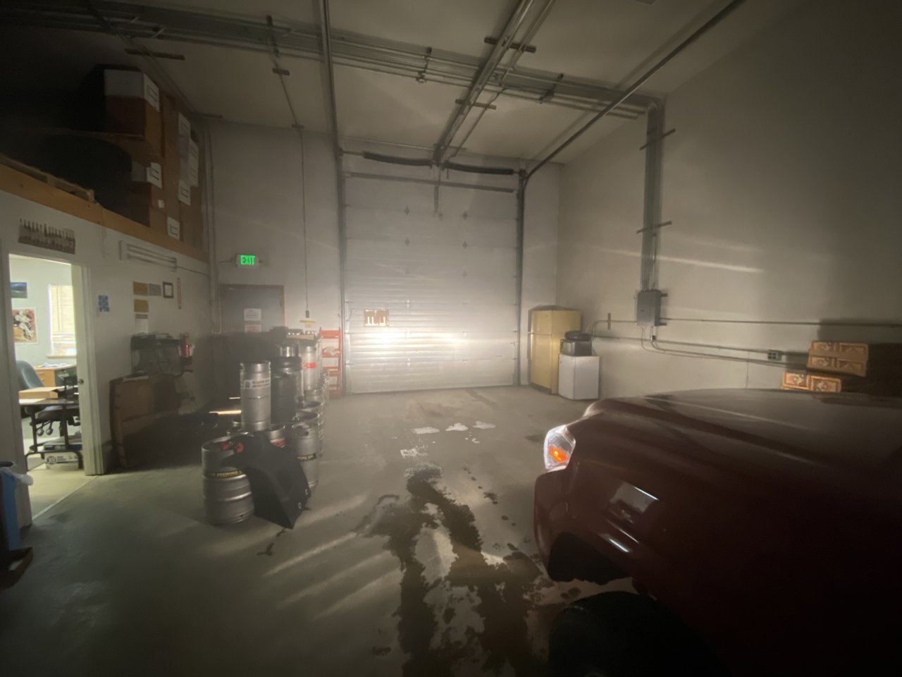

    I’m not sure if the Hella 700ff’s are j581 compliant, but I’ve been using them for 2 years now and I love how well they work. I’m bringing them up to help folks understand the practical differences between spot and driving pattern lights as I found it somewhat difficult to visualize it in practical terms before I got my lights.
    Not as clean as @crashnburn80 ’s garage. Hella 700FF with 100w halogen bulbs. I don’t have a real light meter, but a light meter app I use on my phone for photography puts the Hella hot spot at roughly 2x brighter than the stock h9 high beams. Distance is 20’ from the door.
    High beams alone.
    High beams and Hellas.
    Though listed as a driving beam pattern, I’d say they’re practically close to a mushoom-ish spot beam?
    Originally I had them aimed straight ahead vertically and horizontally, and they provided an immense amount of light directly down the lane I was driving in. I now have them aimed straight ahead and slightly angled to their respective sides of the road. The patterns of both lights still converge at about 250-300 yards out so the middle of my lane is still well lit, but I now have about 2.5 lanes of coverage at the far end but sacrificed some ultimate distance projection to get the wider coverage. Ideally I’d like to aim them so they cover a little less of the shoulders and more down the lane to balance down road performance with shoulder moose spotting...
    A driving pattern will give you something more like the stock high beams, that’ll cover more of the sides of the roads but won’t shine as far down the road as a spot pattern. Spots will cover your lane and maybe the ones on either side of it, but not much else.
    edit - this is why earlier I said an ideal setup would be two spots, for max distance down the direct path of travel, and two driving patterns, angled slightly out, to cover as much of the shoulders for as far out as you can to watch for critters. The only downside I’ve noticed so far is that the Hellas and high beams make my low beams seem ridiculously dim, despite running new-this-fall Phillips h9’s in the lows... I can only imagine what a set of 4 SS3 Max’s would do!

    Ironic timing! I was just in a PM discussion about 'value based' driving lights and I mentioned these as well as the 500 variants. They are not technically US J581 compliant, but they are European ECE driving compliant according to the specs. Of course that is with legal 55w bulbs. In the original thread I focused on LED options, but there are certainly good performing less expensive halogen options as well and by spec the 700FF hits a great sweet spot of performance and value. You'll get more performance for the dollar with halogens compared to LED. I would be certainly interesting to add some of Hellas offerings to compare.
    And that garage depth. :drool:

    That’s my work’s warehouse and unfortunately for aiming of lights and taking comparison photos purposes my last day is tomorrow. New job starts Monday, fortunately the only downside is no more being able to park inside in winter to thaw the truck out.
