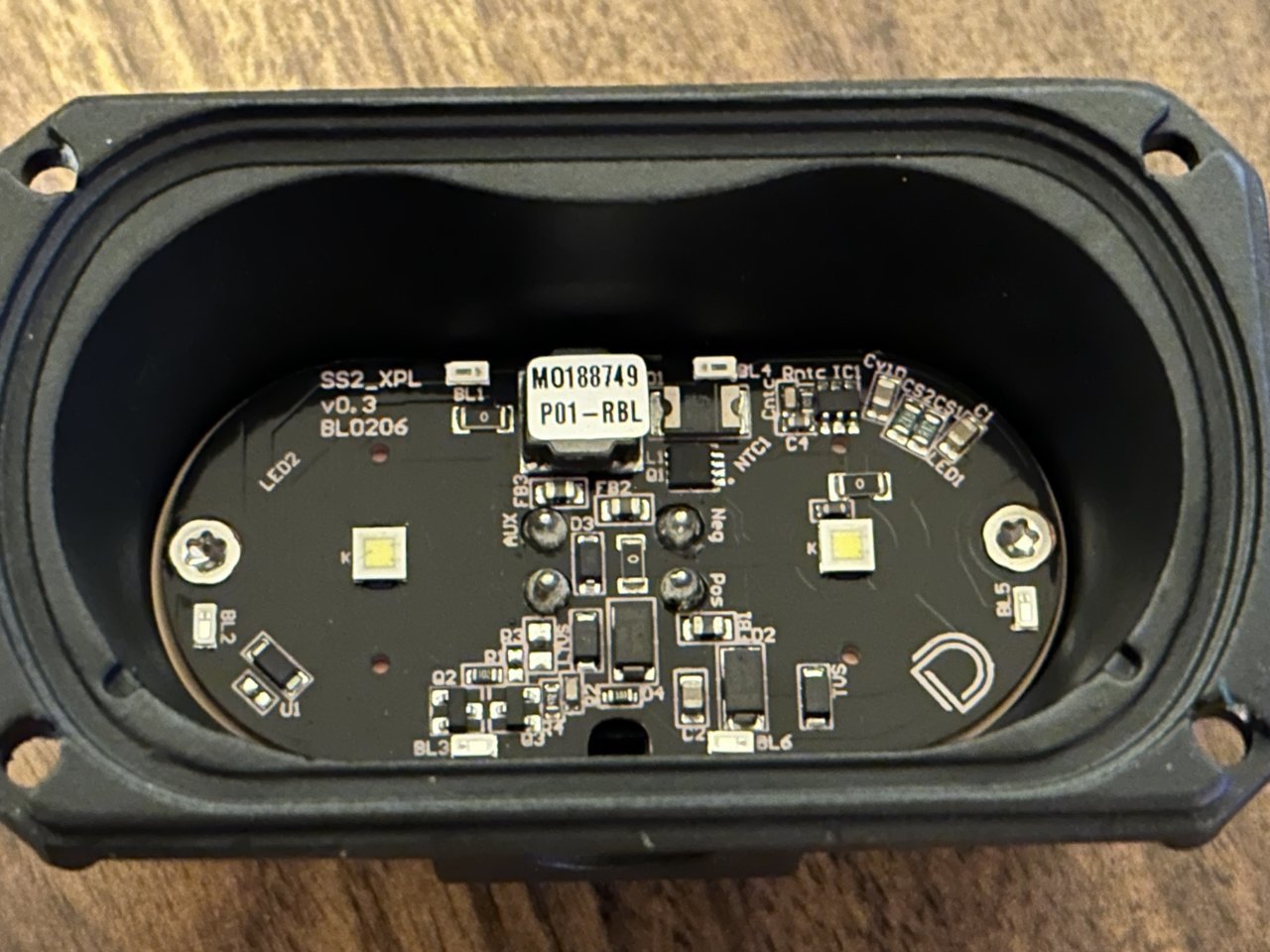

    DD SC2 Pro 6000k. No dome over the emitter.

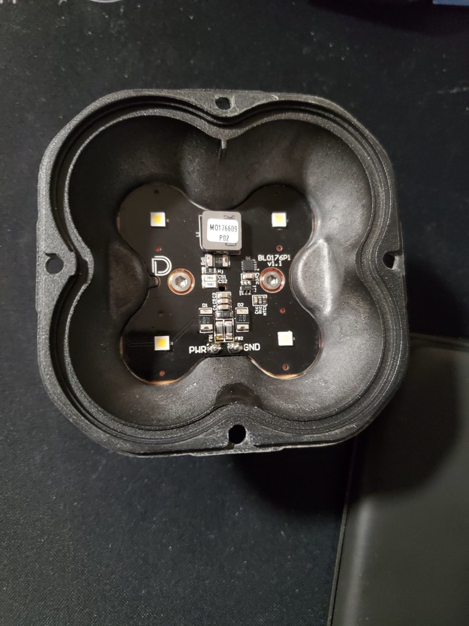

    Flat emitter for these too, SS3 pro 4000k no backlight.

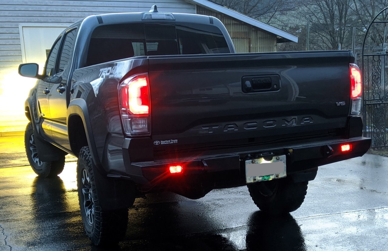

    I have them (red) on my SSC2 reverse lights in my aftermarket bumper. They act like a marker light in the rear bumper. Forward facing, doubt I'd bother.

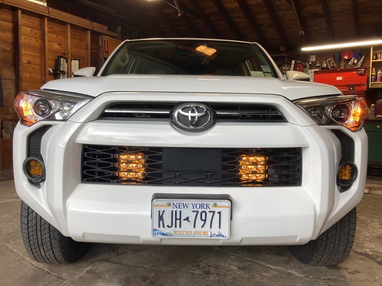

    The backlight feature is mainly just for the "cool" factor. I have the feature in my SS5 Pro's and it is hooked to my running light circuit. My SS3 Max fogs do not have it.

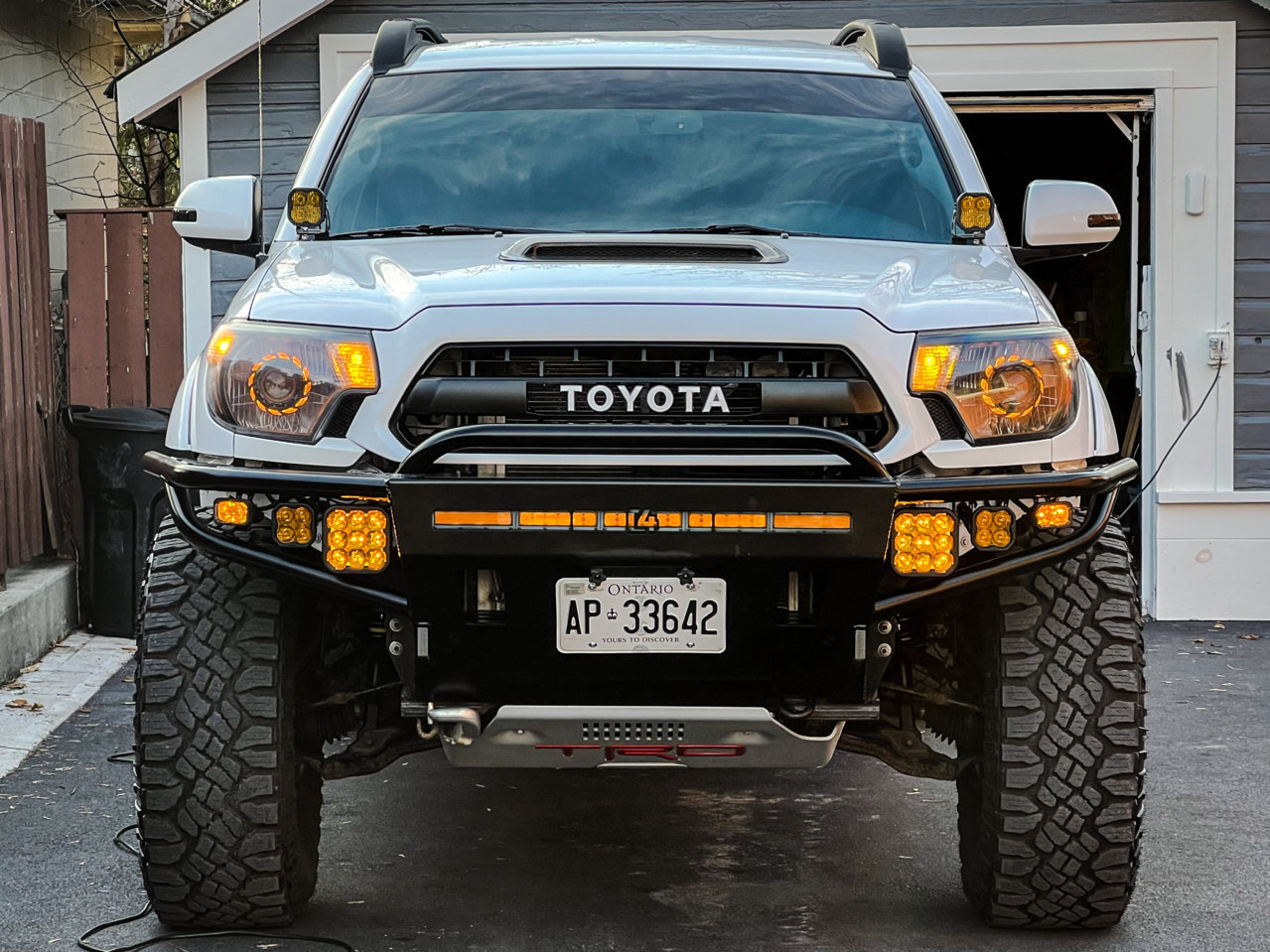

    :D
