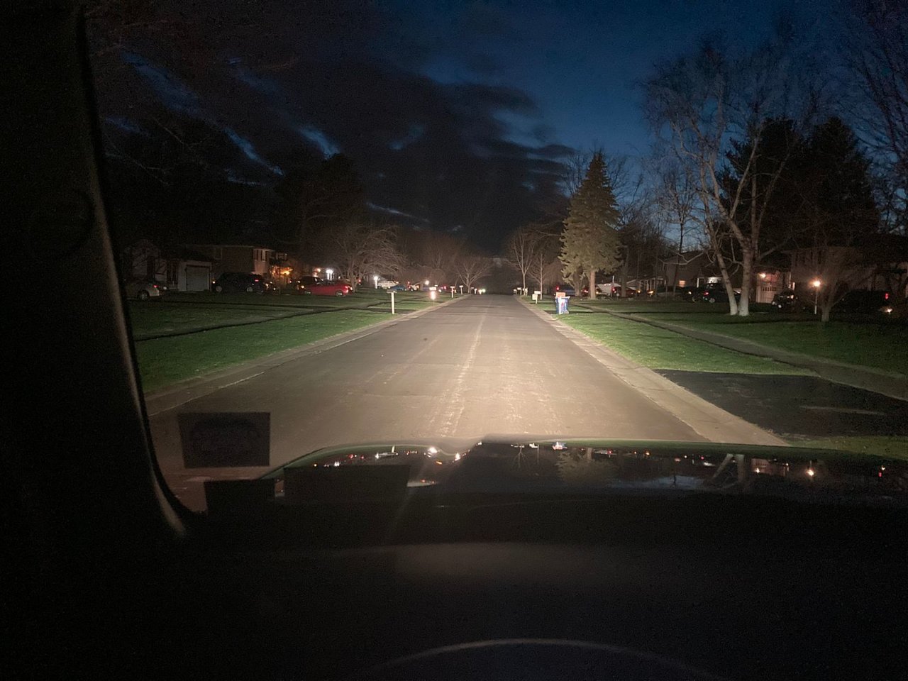

    Maybe I could offer some advice since I have some SS5's on my 4Runner. I ordered the Pro model in Selective Yellow Fog pattern, but swapped in Clear Driving pattern lenses to get a nice 4000k color. (More yellow / less white) They're mounted behind my grill, so I lose just a bit of light through getting partially blocked by the grill. As much as I liked the pattern, I wanted more distance and less spread, so I swapped to Spot lenses. For me, this was perfect.
    For reference, here's what the driving pattern looked like:
    For you, I'd suggest the same setup, but with the Clear Driving pattern lenses. Trust me, they're awesome!
