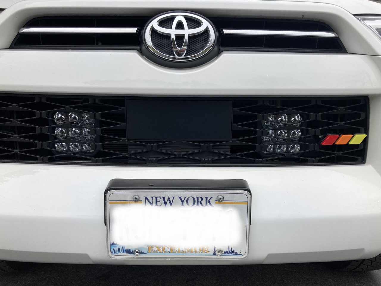

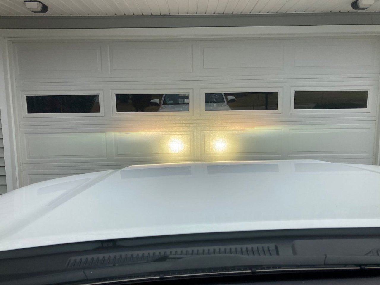

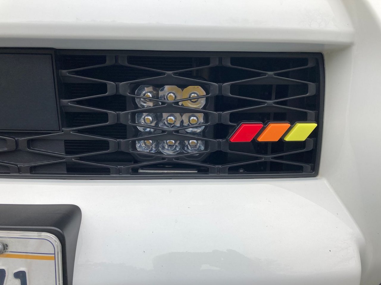

    Apparently, there's been a few questions as to which lenses I have in my SS5's. While it's true that I started out with Fogs, I immediately swapped in Driving optics, but settled on the Spot optic as the best for my needs. Here's a few pics to prove it.
    You could probably use these for stripping paint. :rofl:

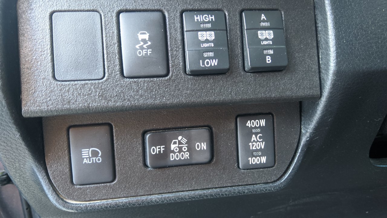

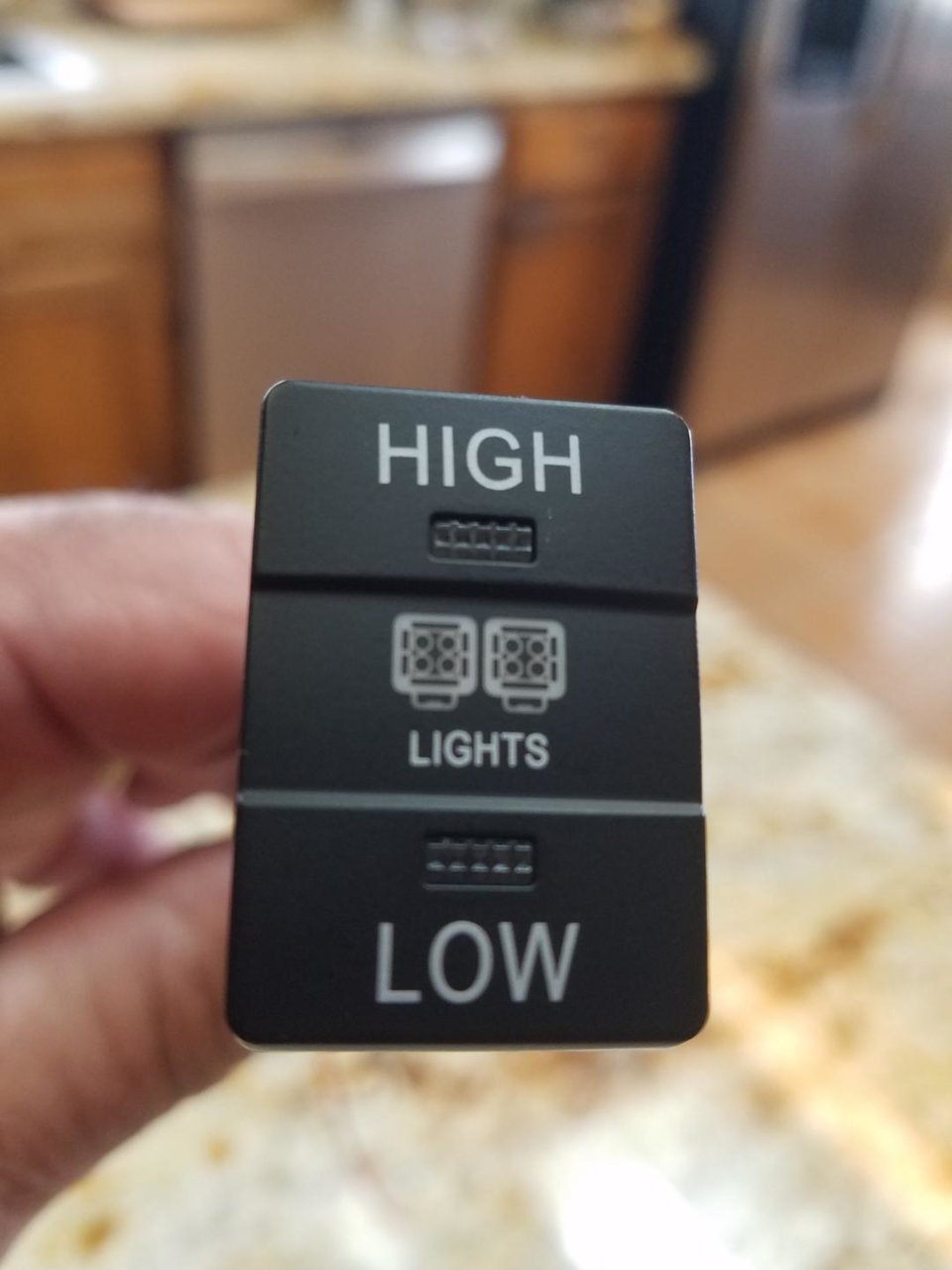

    My SS5 and harness came in from hotshot offroad ( memario1214 ) The harness is
    the best I have ever seen. I would buy one to use even on some other lights.
    I did find a three way switch ( on--offoon ) from anytime backup camera and
    will use that since it fits in an empty spot. The DD harness also give you a
    different pigtail if you want to use a different switch/power.

    Please consider adding a couple of pics of the actual connectors (sides and faces) on the harness, also.

    I have two switches like that, one for my DD SSc3 aux high beams and the other for my SSc2 reverse lights.

    Low is backlight?
  12. Jan 22, 2023 at 7:19 PM
    #652
    DuffyBank
    DuffyBank Well-Known Member
    Sep 24, 2021
    #377978
    1,537
    Me? Low switches the aux high beam on independently.
  13. Jan 22, 2023 at 7:22 PM
    #653
    daveeasa
    daveeasa FBC Harness Solutions
    May 14, 2020
    #328079
    7,479
    David
    PNW
    2016 Tacoma OR DCSB 6MT, 2005 RC 5MT PreRunner, 2002 Tundra SR5 RCLB 4x4
    And high does what? On with high beam? So “auto”?
  14. Jan 22, 2023 at 7:36 PM
    #654
    DuffyBank
    Sep 24, 2021
    #377978
    1,537
    Yes, three way switch, on with high beam/off/on as off road lights

    Cool. I would be super stoked with a switch that actually said ON, OFF, AUTO. High vs low doesn’t work for my brain :)

    I suppose you might be able to get custom screen prints? Don't know how that process goes. I got my SPDT switches from here: https://www.anytimebackupcamera.com/collections/switches
