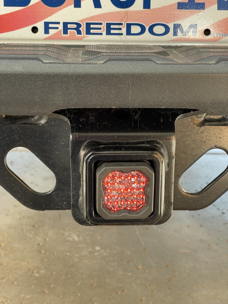

    Not an Aux High beam, but seemed more appropriate than the fog or headlight threads.
    DD SSC1R came today!

    How strong is the brake light? Do you have the flashing module?

    It’s pretty bright, pictured was the running light only.
    It comes with the flash module already installed.

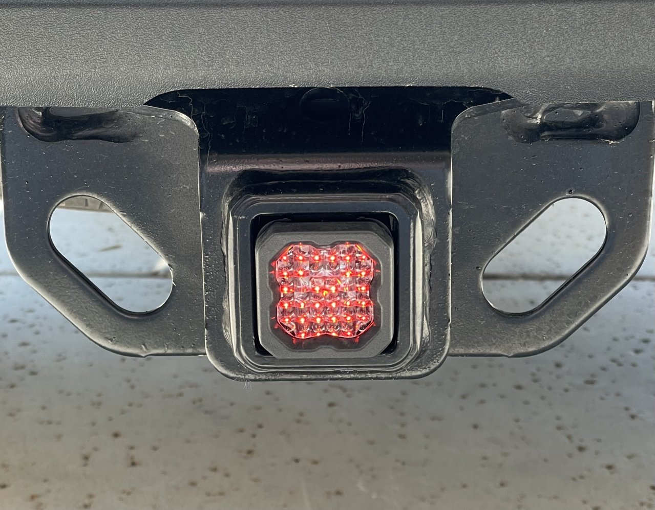

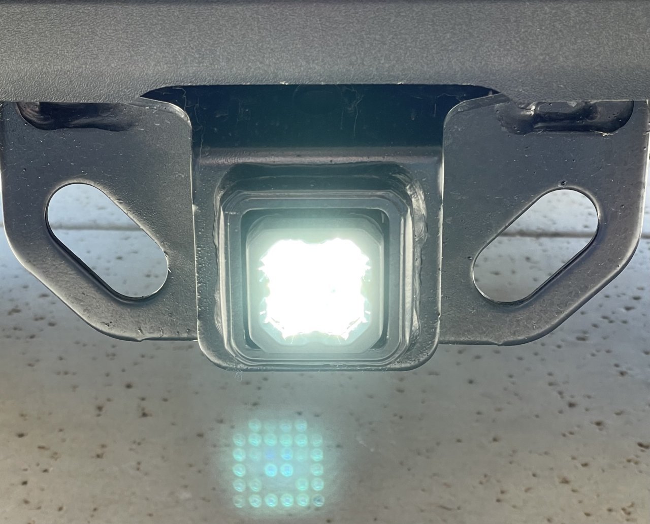

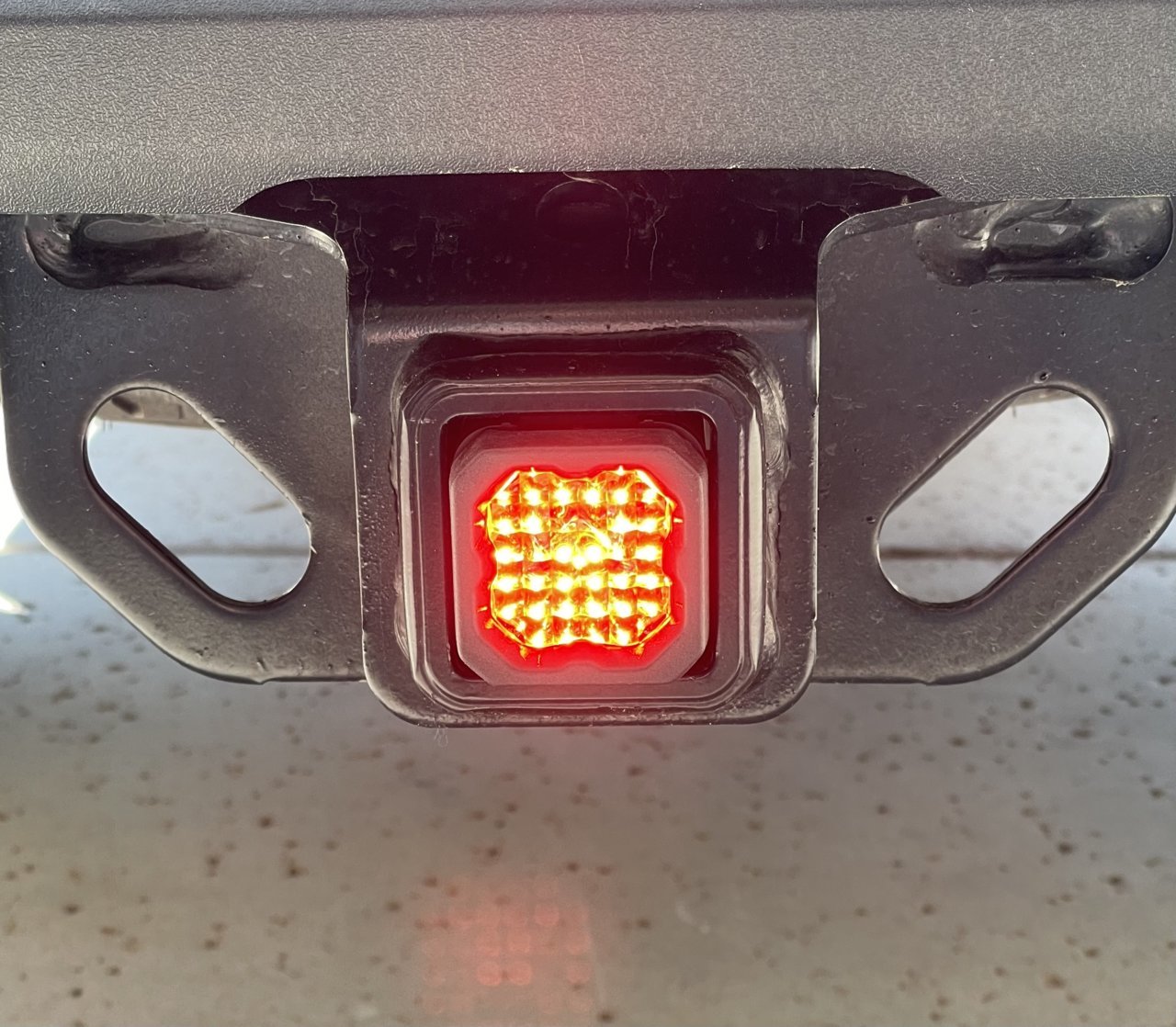

    Took some more images about 12:45, full AZ sunlight out.
    Running lights
    Brake light
    Reverse light

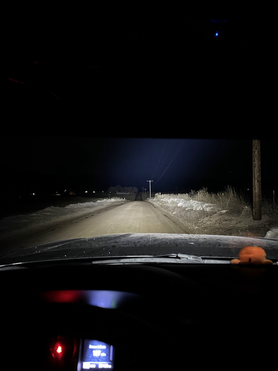

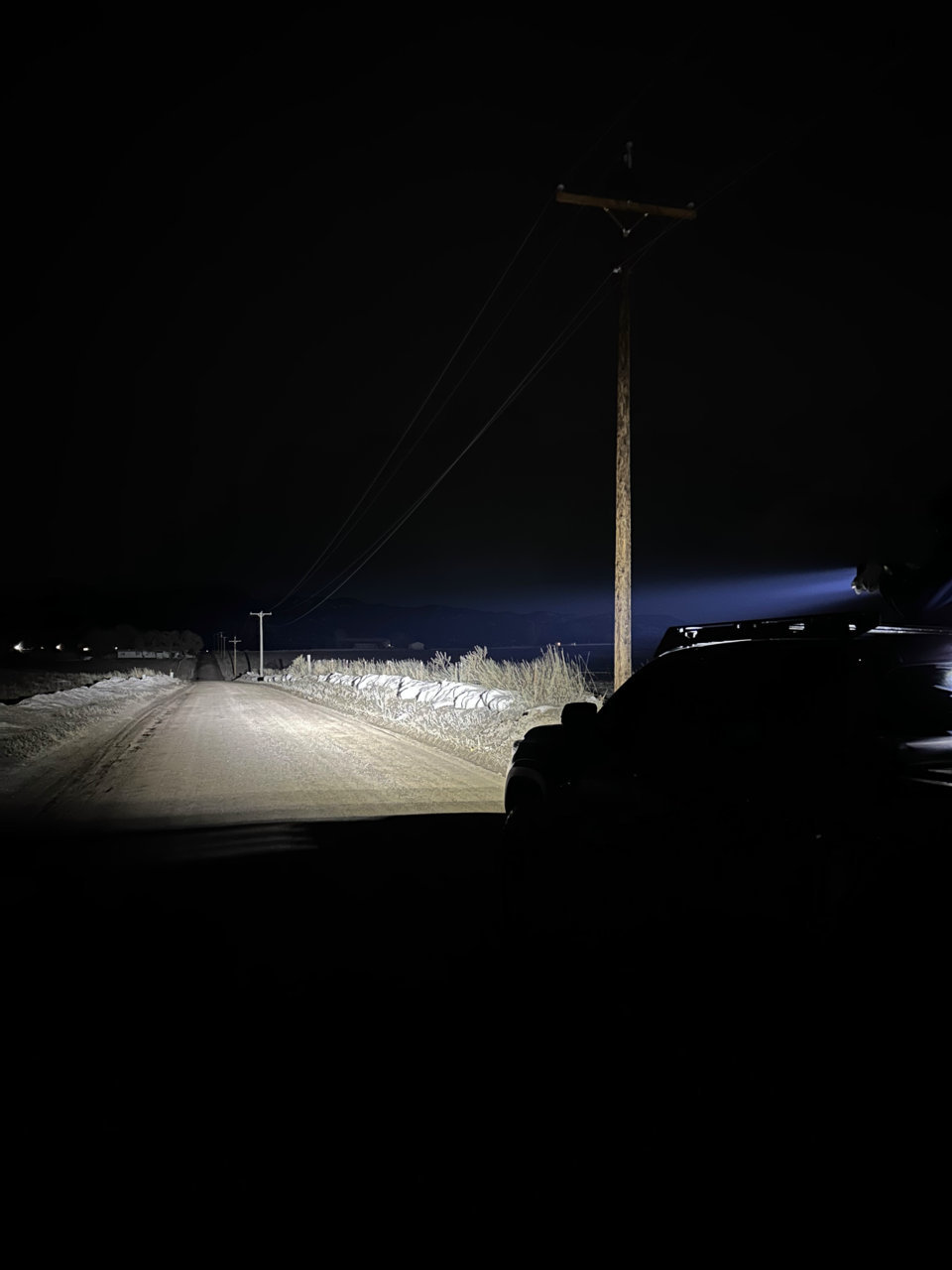

    We just recently spec'd out a customer's 7-pod on his Tacoma, and we went out into the field to test patterns because he was having the same questions. You'll have to look at whether or not you're going to go with Pro or Sport power level as well. The pros are quite a bit softer in terms of pattern so here's what we're doing for his setup (all pros). Flood-driving-spot-spot-spot-driving-flood. The backlights will all be tied together, but for main beam the floods will be on their own switch, and the other 5 together with each other. The bar wont be mounted perfectly straight so the driving pattern segments will be pointed out slightly to the sides for Bambi detection and overall fill.
    This photo isn't an excellent representation of what we're talking about, but it's be best I have from that night. The driving pattern in a pro power level is quite a bit wider than you would think, and since we're not incorporating any flood elements here there's little hood splash even when situated at the worst possible spot on the roof-line. Both photos are 2x SS5 pros in a driving pattern just held up by hand in the approximate mounting location.

    This is GREAT!
    It’s surprising mounted that far back on the roof there is still hood splash.

    So the second photo that is representative of the hood splash - I was literally sitting in the passengers seat open window resting the lights with the heatsinks directly on the upper windshield seal. Photo 1 and photo 2 were taken from different perspectives in terms of where the lights physically were in space when the photo was taken. I did try to aim them down the road the same though.
    That said, the second photo is more representative of what one should expect for light expressed onto the hood if you're using the more popular roof rack/mounting bracket solutions out there, and not setting them back intentionally to avoid the hood splash.
