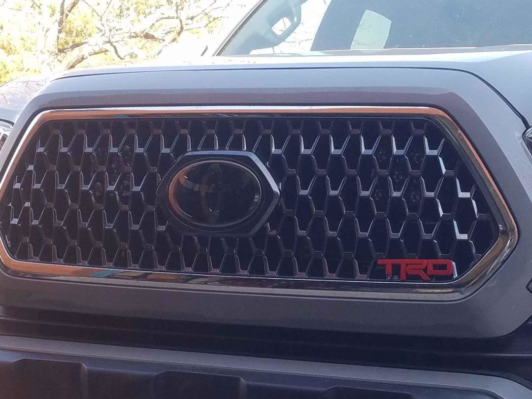

    You'll never get full output from behind the grill. The grill can kill up to 65% of a lights output

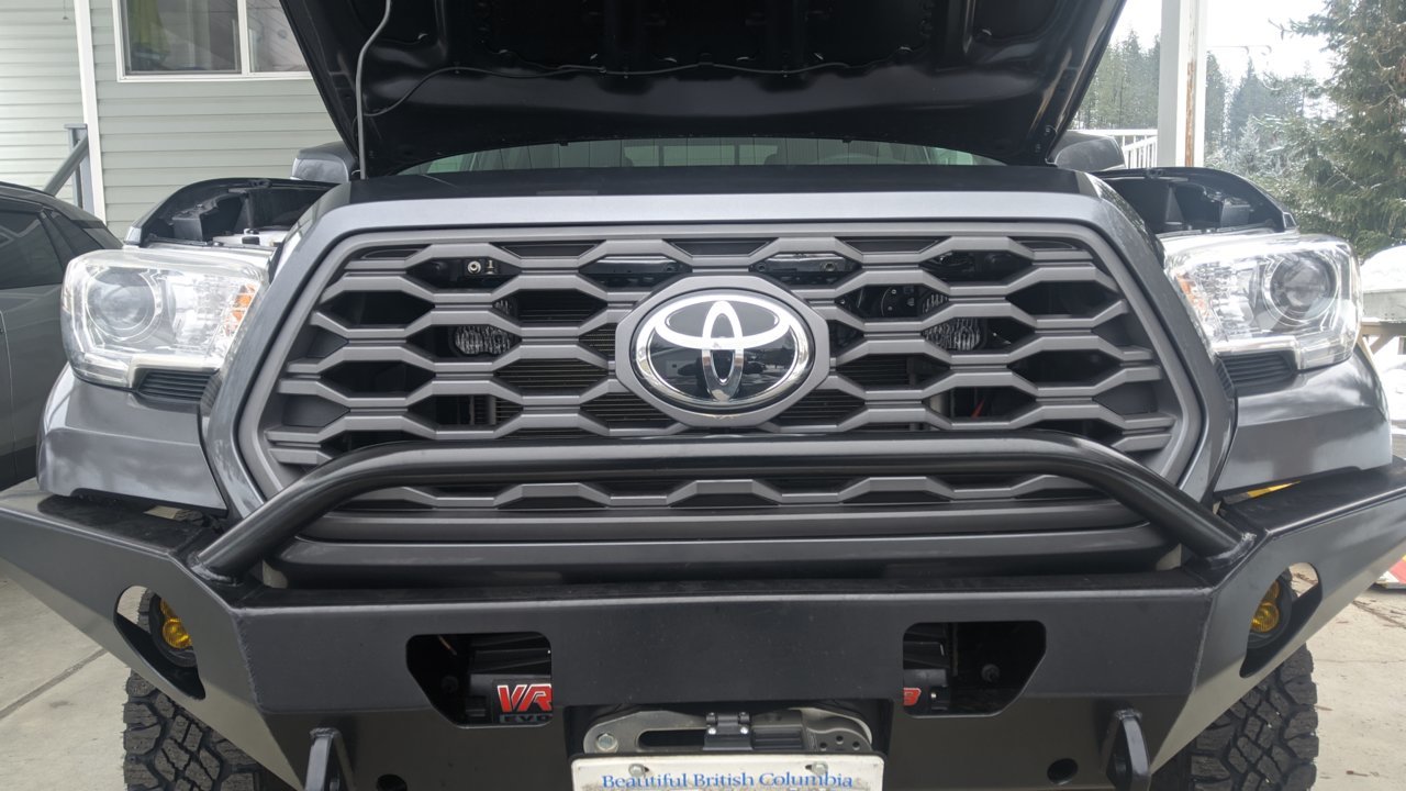

    I had a 30" Stage bar (driving pattern) behind the grill in my Tacoma and loved it. When I bought the 4Runner, I went with SS5 Pro's behind the grill. Yes, the Stage bar was great, but the SS5's (spot patten) are well past awesome! The bend in the road (beyond the hump) in the pic below is about a half mile away.

    This is why you must kill the grill.

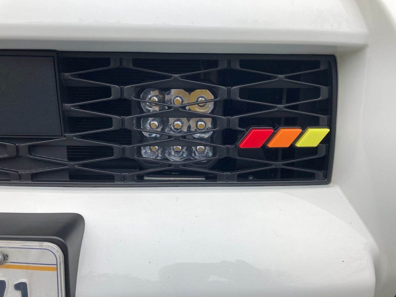

    Cutting took 15-20 minutes with a hacksaw and then cleaned up with a file. Two of the emitters on each light were partially blocked by the grill. Worst case scenario, if you later want to sell your truck without the lights a replacement grill insert is cheap. Here is a pic before cutting the grill.

    4Runners have a way less restrictive grill when it comes to lighting. The results I shared earlier were despite shining through this:

    Ohh good to know about the insert. I should have been more clear about before/after pictures... I meant of the output from the driver seat. How noticeable was the difference in the amount of light after you cut your grill?

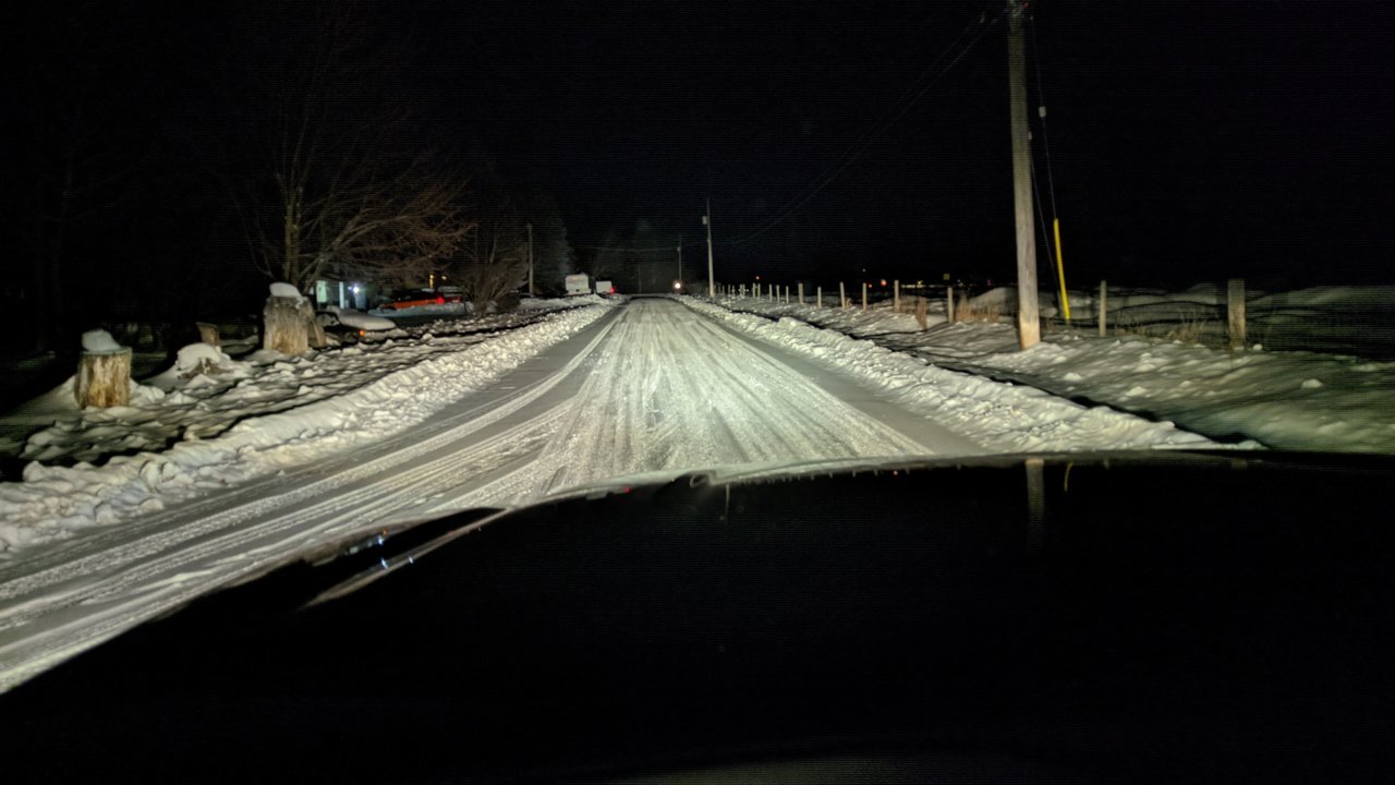

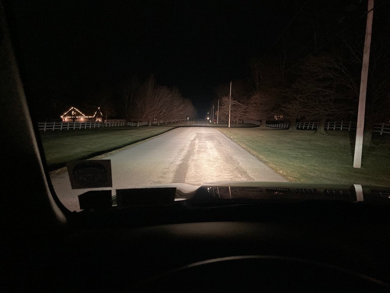

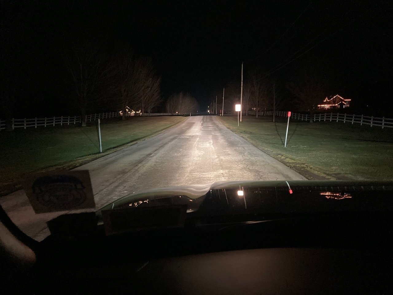

    I don't have any pictures of output with the same camera settings, but I do know it was noticable. I drove home late last night, a couple of hours on 2 lane deer infested highway. The aux high beams make it as though I'm driving at twilight.
    For what it is worth, you can see the a bit of the difference with the trees across the t intersection at the end of the road more visible after cutting. These pictures are taken about 8 months apart.
    Before
    After

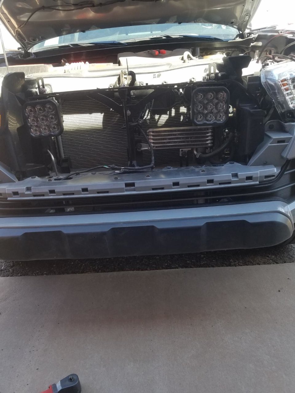

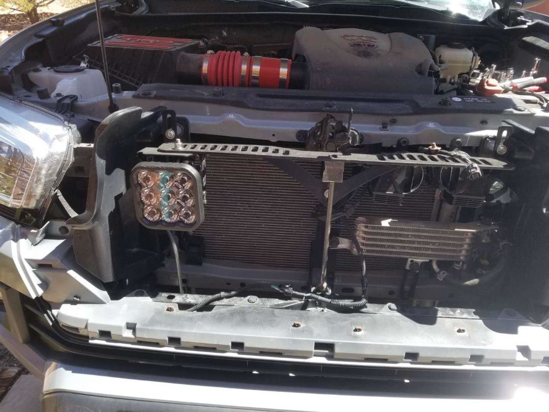

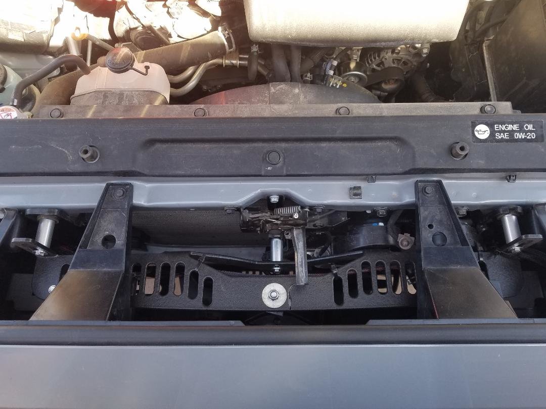

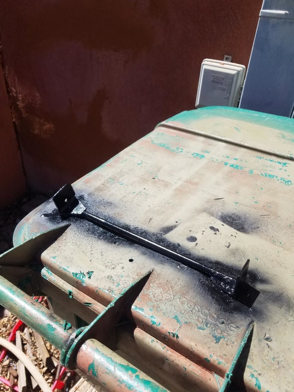

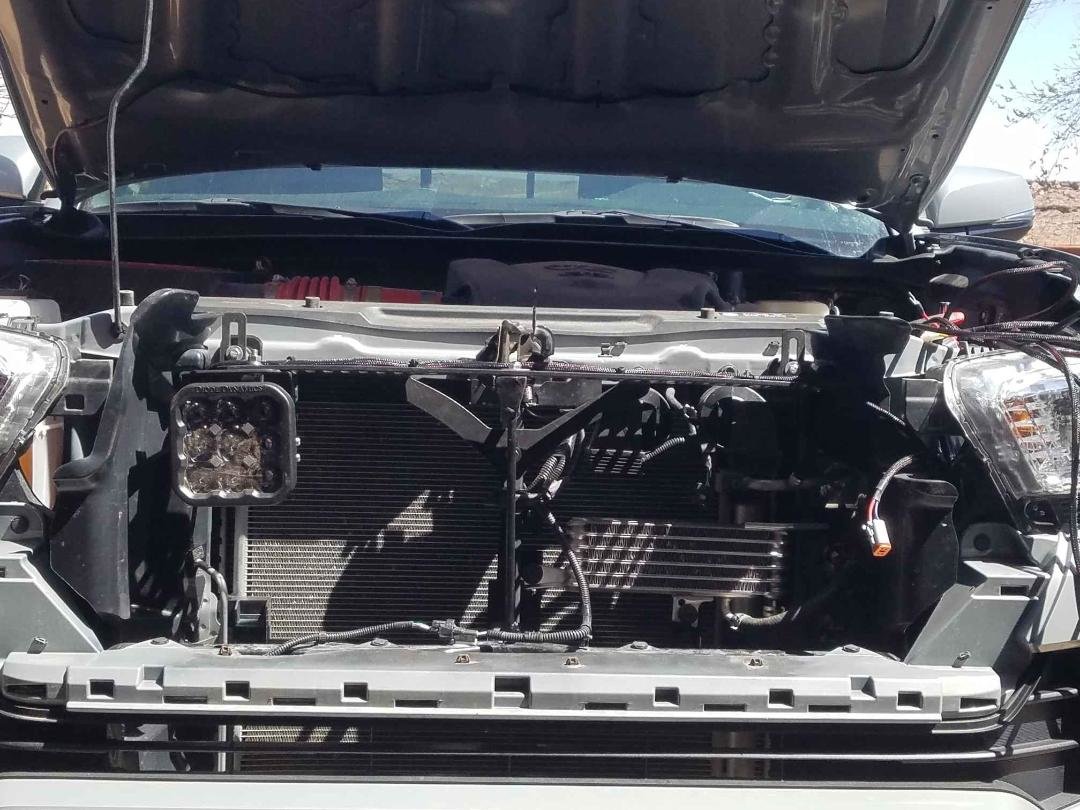

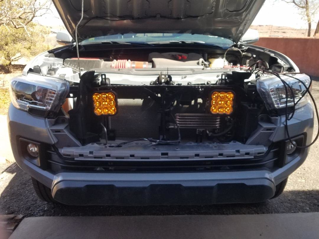

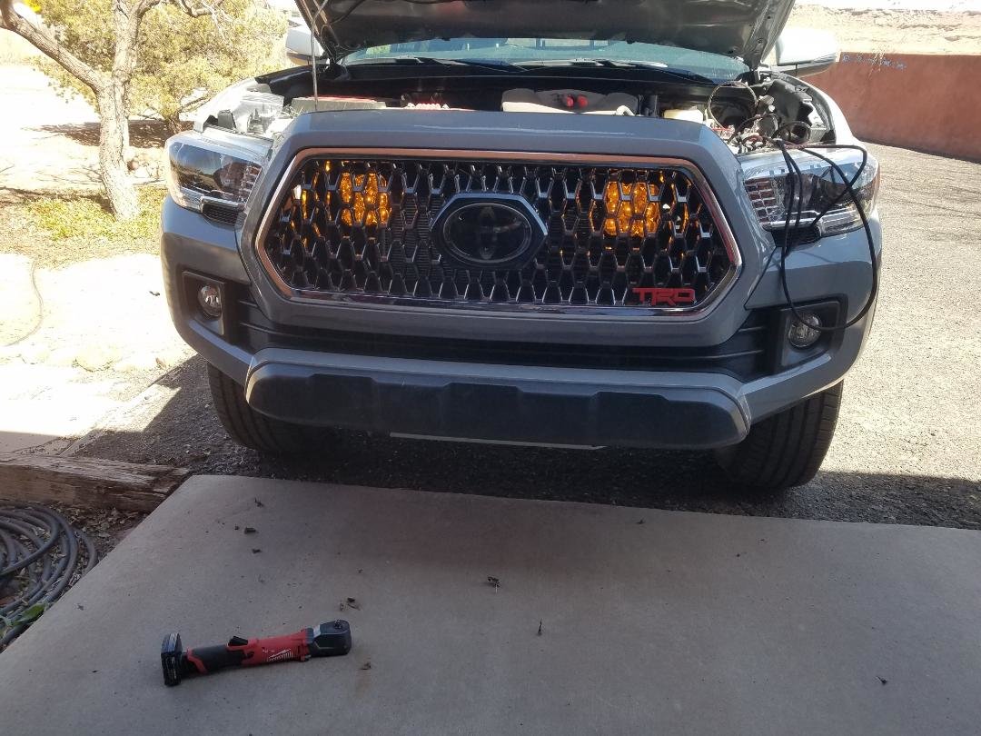

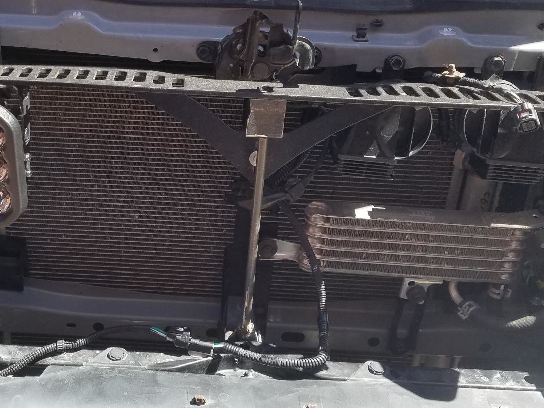

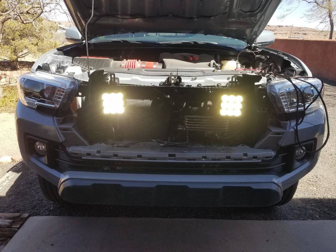

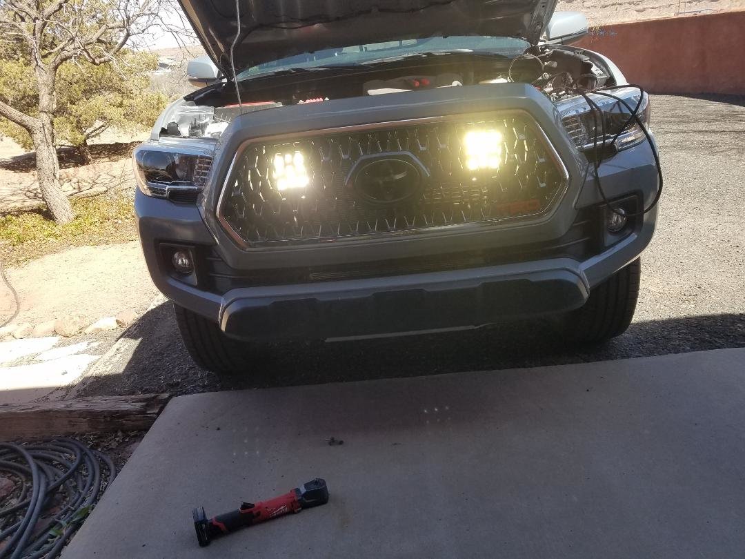

    Someone earlier ( I can not find it now to give them credit ) used spacers to cantilever a bamf grille mount. This way no moving the
    horns. So I took his list and did my own. I did use 1/4 I.D. spacers since they more closely match the metric bolt. I actuall mounted
    the bamf mount without taking off the grille. I was worried about the mount being cantilevered out and putting more stain on the core
    support etc. So I took same scape angle iron and some 3/8 dia road and made a forward support rod to avoid flexing. It is easy since
    there is a bolt and nut at the bottom support that works perfectly. Some black spray paint and a 1/4 and 5/16 hole and you are done.
    I mount DD SS5 spot and added a Nylok nut just to make sure. Here are some pictures. Hotshot offroad helped a bunch with the yellow
    light converted to white spot.

    That was me who came up with the spacer solution.
    Glad I was able to help out.
    Your central support bracket is a good idea, I might make one for my BAMF mount as well.
    In case anyone else wants to do this here is a link to my original post.
    https://www.tacomaworld.com/threads...ements-light-bar.222333/page-37#post-28231172

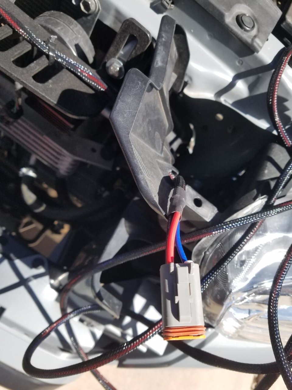

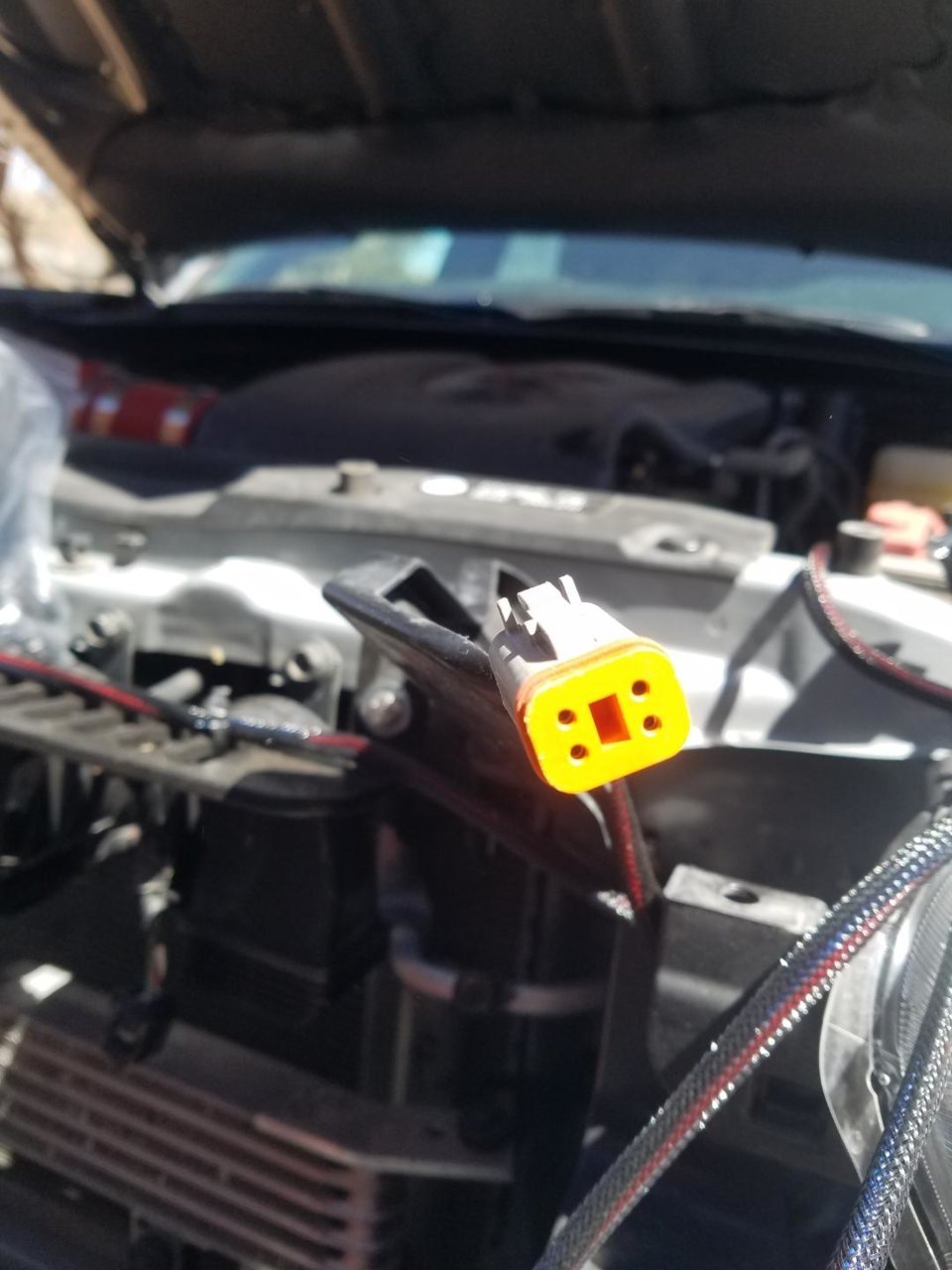

    sorry for the delay here are the connecters they use, but you can cut and replace with what you need. lots of
    lengththumbnail (8).jpg thumbnail (7).jpg thumbnail (7).jpg to get the wire to where ever you need.

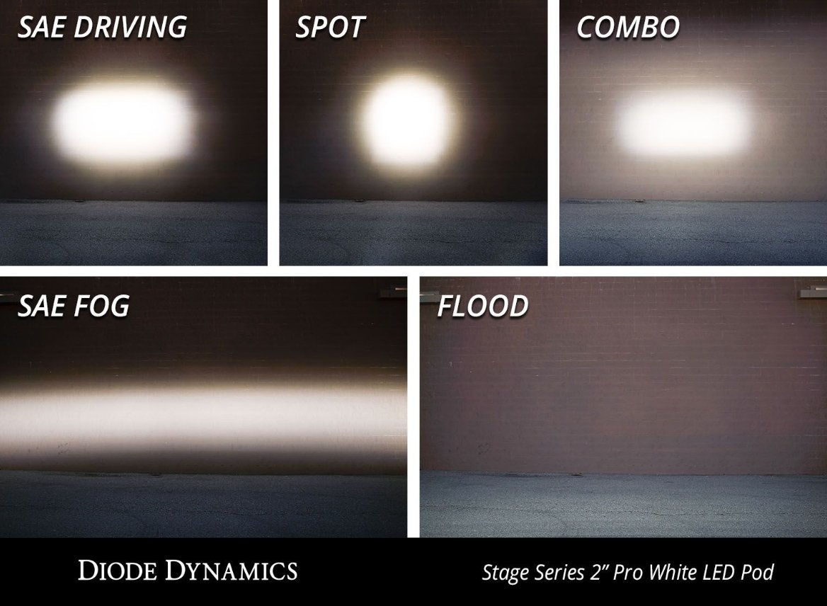

    SSC2 Pro - SAE Driving or Combo? Does anyone have comparison photos or experience between the 2 lens options?
    I have a pair of SSC2 Pro's with SAE fog lenses that I am looking at repurposing as auxiliary high beams for my motorcycle. I'm between the SAE Driving and the Combo. I am leaning towards the Combo lens since it has more light spread than the Driving pattern. My though is that the Combo would be better for critter spotting on the open road, better light transition when leaning into a turn and is already a massive improvement over the current high beam already. The SAE Driving does have almost double the output (590 lux @ 10m) compared to the Combo (270lux @ 10m) according to DD's website. While absolute range is nice to have, would it be better for my intended purpose? If it's a dark empty unknown highway, I won't be going any faster than 70mph anyways. I try not to do extended rides at night just for safety reasons, but sometimes I can't help it so it's better to be prepared.

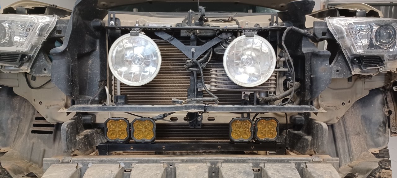

    @Too Stroked, do you wish you had those Cibies mounted higher or more accessible for cleaning? It seems likely I'll be buying a 4runner and will be mounting ~6" driving lights. I like the mount that this guy made, but behind the grille or in the ditch light position seem interesting.

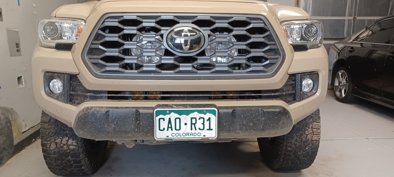

    Im running the hella 700ff with 100 watt bulbs as my aux high beams. They work great for how cheap they are. I prefer all halogen for the matching color temp since they blend together perfectly.
