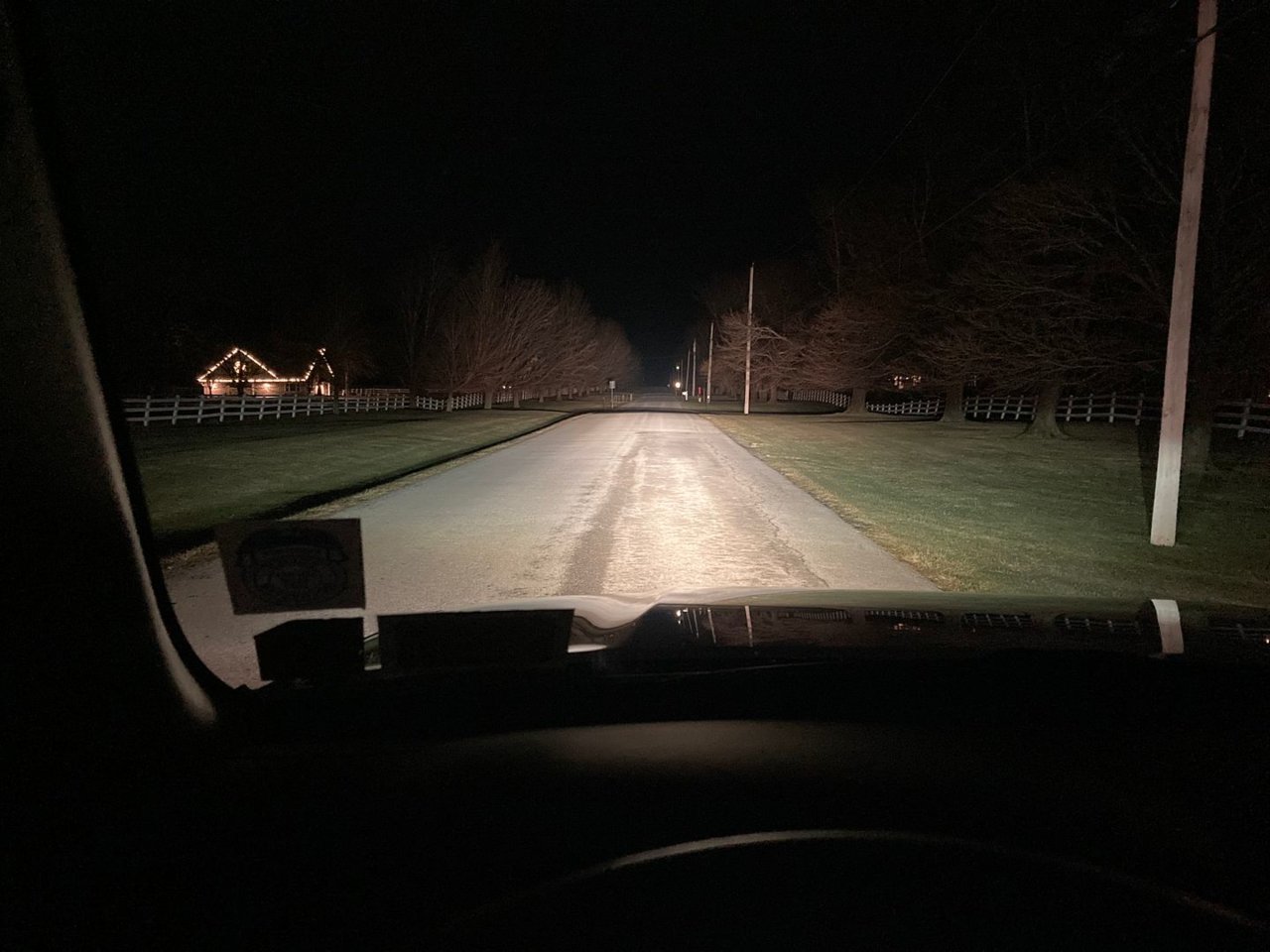

  10. Jun 11, 2023 at 4:23 AM
    #710
    Too Stroked
    Too Stroked Well-Known Member
    Jan 24, 2017
    #208501
    3,913
    Tom
    South shore of Lake Ontario
    2021 4Runner SR5 Premium
    They might. They actually have a fairly wide "spot" pattern. Of course, since I have them wired to come on with my high beams, you get some of the factory high beam pattern in this pic. The reach is all SS5 though. The road falls off slightly about 1/2 mile away.

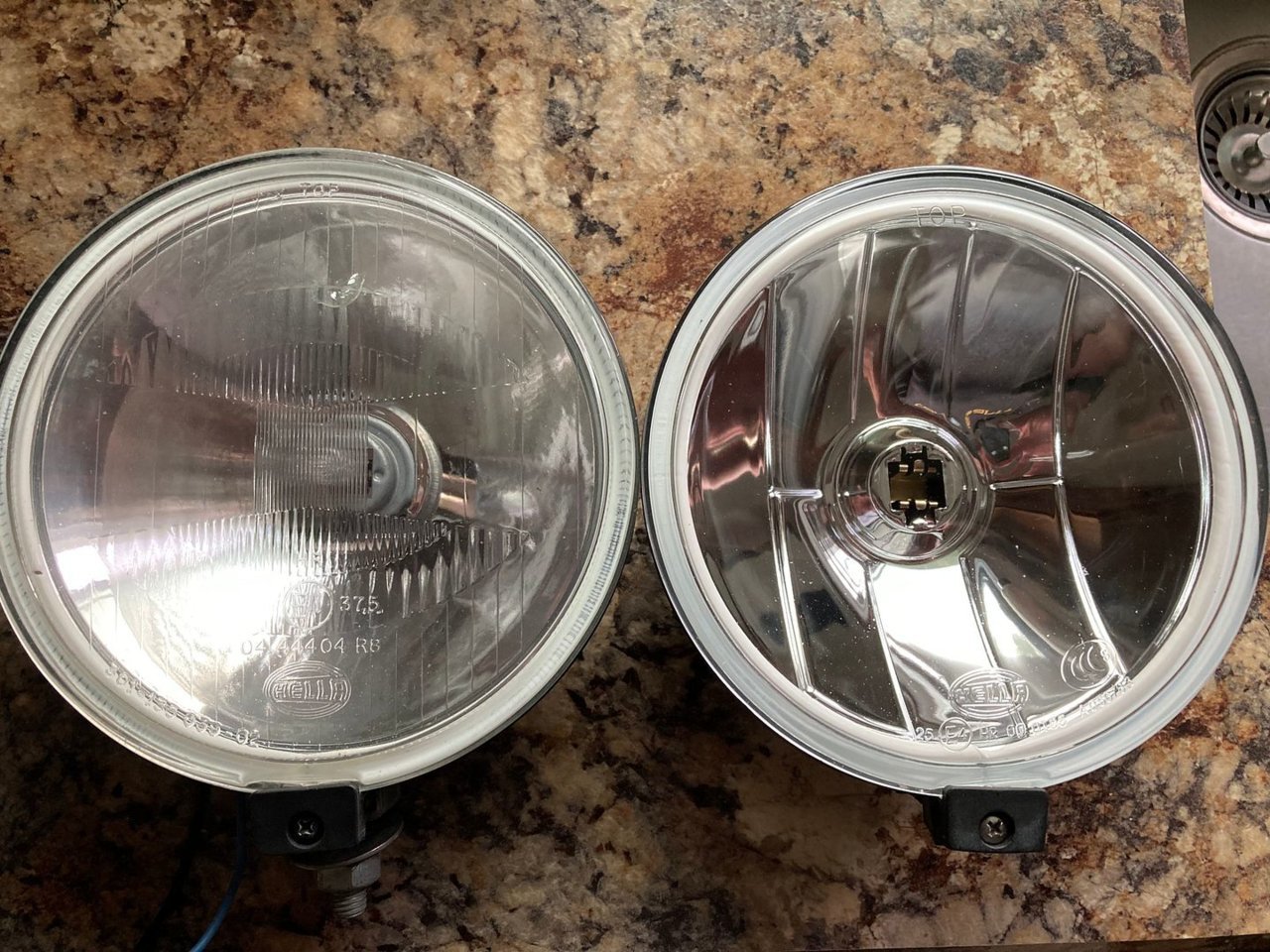

  11. Jun 13, 2023 at 9:02 AM
    #711
    Too Stroked
    Jan 24, 2017
    #208501
    3,913
    Tom
    Ask and ye shall receive. A pair of Hella 500 driving pattern lights - one regular and one FF - are winging their way to @crashnburn80 for testing. I can tell you from personal experience that the output of the FF version is pathetic compared to the "regular" version though.
