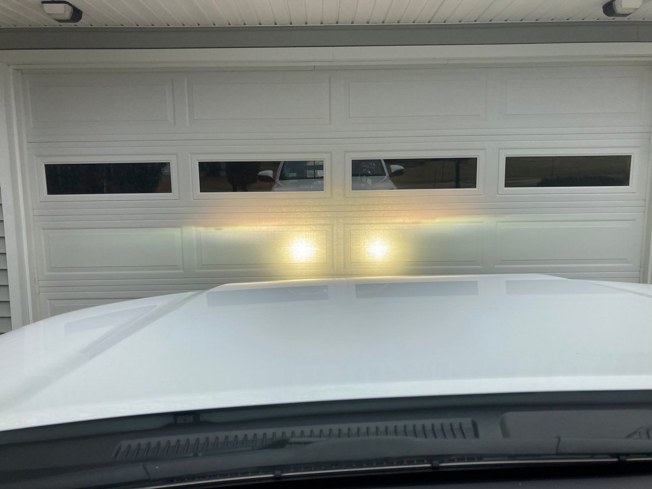

    Here's what a set of Diode Dynamics SS5 Pro lights that came with the selective yellow fog lenses look like with clear spot pattern lenses. Perfect color.

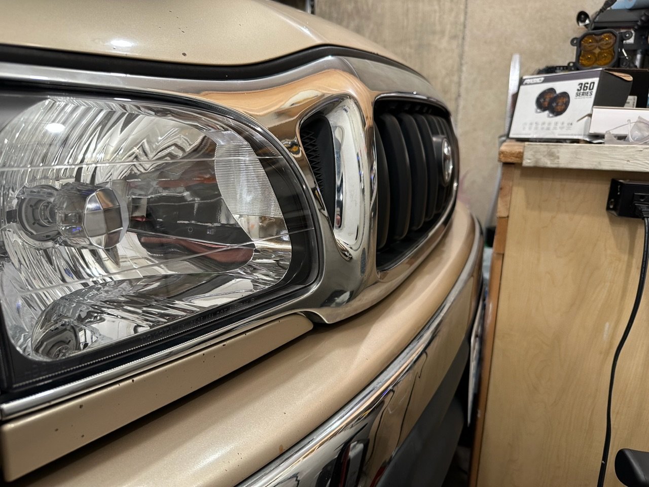

    One of the things I like about the Pro6 is they look semi-period correct with 6” round reflectors. However this headlight upgrade with 100w Superbright Osrams definitely covers more than enough distance for any speed the 1st gen is covering.
    Then there is the Tacomas parking space.
    No room for front lights, unless behind the grill. (And no the truck isn’t touching the bench). For this specific build it is more restorative on a 20+ year old truck and only very minor mods. Want to keep it classic looking and true to the original form, so a custom grill with a behind the the grill mount is out.
