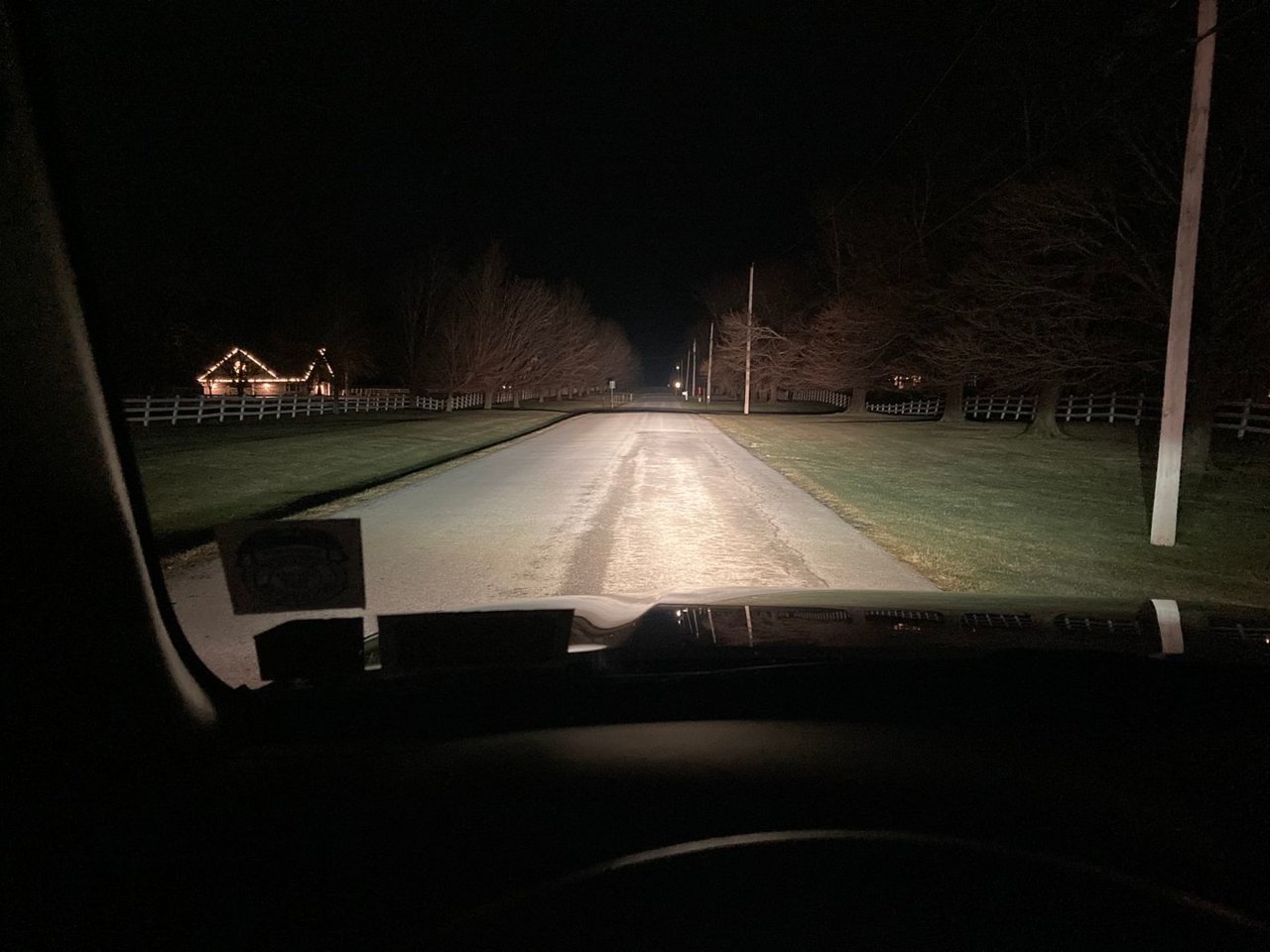

    Here's what the results look like on an unlit country road near our house. The road falls away and turn 90 degrees right just over a half mile down the road. As you'll see, the pattern is pretty darn nice. Please note that this pic does include my upgraded high beams, but the vast majority of the effect is the awesome SS5's.
    I will add that I have the SS5's wired to come on every time I hit the high beams - and that's just the way I like it. I had the option of adding an enable / disable switch, but when I want distance lighting, I want distance lighting. Do the SS5's provide too much light? You be the judge.
