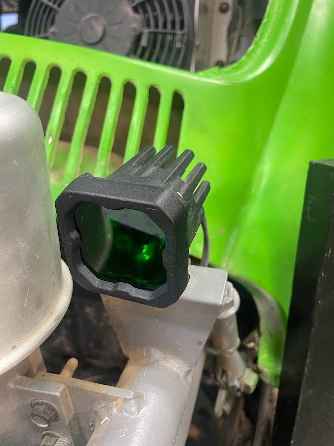

    ahh went to quick over that part. as yea, thats just ambers with a amber backlight (which is kinda awesome too)
    for us, we machined out the covers to accept different color inserts depending on where we race.

    That's a good point that it is interesting to see a yellow main beam, I missed that too assuming it was just the yellow lens with amber backlight. On the video it appears that the main beam is a Yellow LED in place of the white LED. I wonder what the output intensity is like (just spit balling different lens options) and the actual color temperature? Could it be close to a selective yellow with a clear lens or possibly something that could become selective yellow without as much filtration loss through the lens as the 4000k LED's?? Hmm.... Certainly interesting. If it's a Yellow LED, I'm wondering what's possibly next along those lines??
    EDIT: That's a pretty cool setup you have there! I like how you machined that down so a colored lens could be inserted. What do you find best for lens color in those environments?

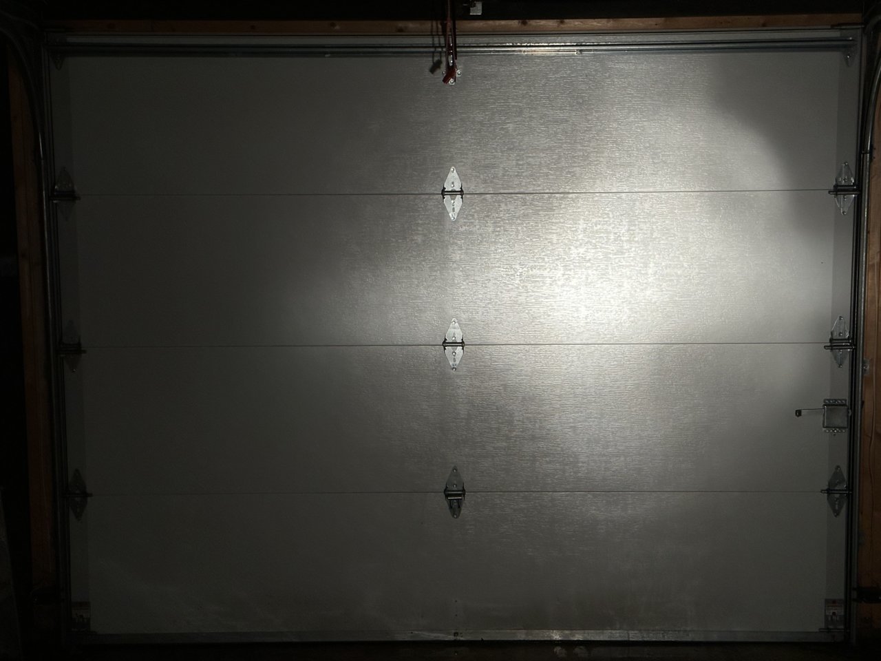

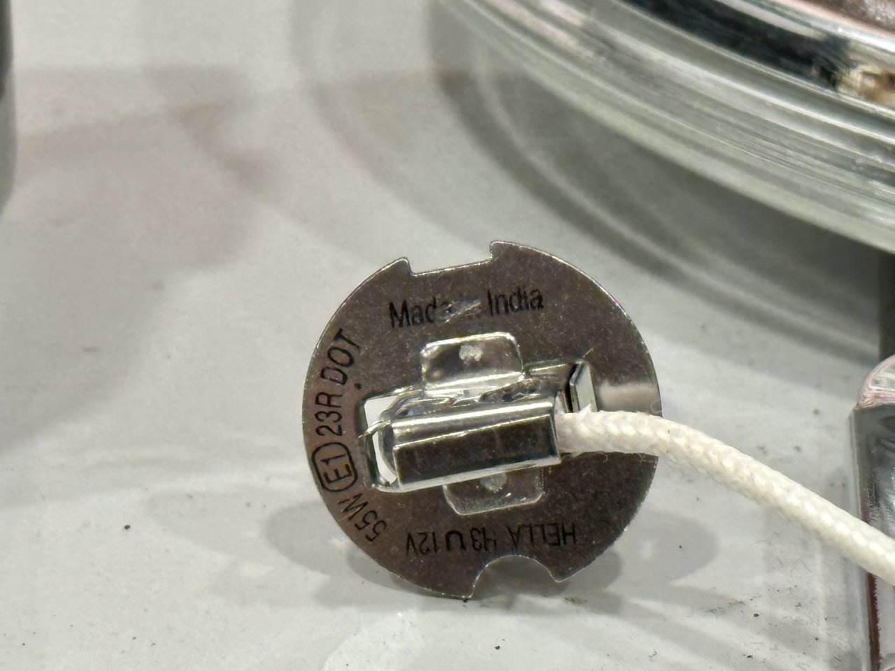

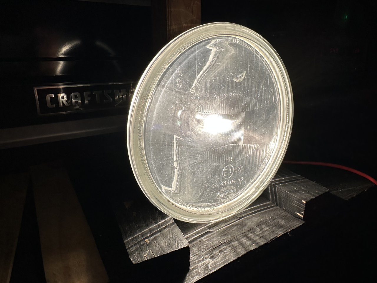

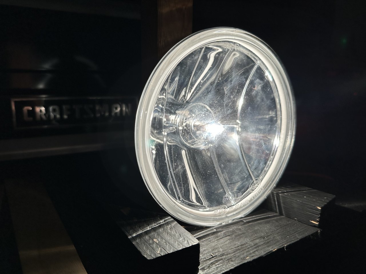

    Hella 500 vs 500FF vs 700FF.
    The Hella halogen lamps are a popular inexpensive driving lamp available in the smaller 500 lamp size with either traditional optics using fluted lenses or free form optics utilizing the reflector only and clear lenses without additional fluting optics. The 700s are a larger lamp size of the same product family.

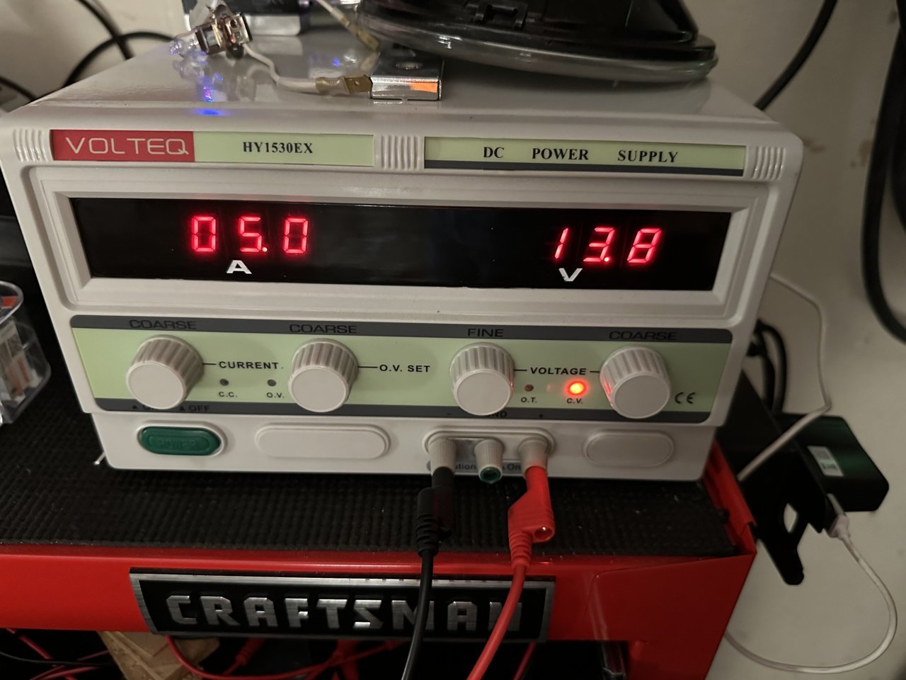

    For the initial round of testing, the included "55w" Hella H3 is used on all lamps.
    Except this isn't a 55w bulb. My accurate linear power supplies had trouble supplying the lamps with this bulb, tripping at max power which is 70w. These 55w Hella India bulbs were pulling 5.1A at 13.8v, or 70.4w. So I had to swap to my high power switched power supply units. That might seem exciting, but Hella doesn't have the best reputation for over wattage bulbs, in fact they are often lower performing than stock wattage performance bulbs from better manufactures. But regardless, I pressed on using the default bulb as the baseline.

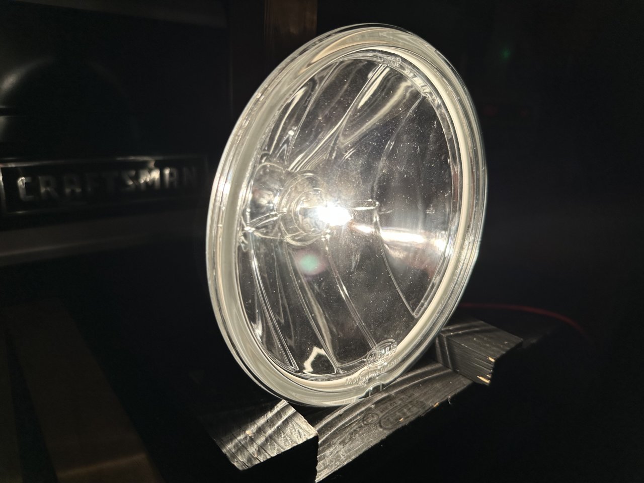

    First the Hella 500s (using fluted lens optics)
    What you'll notice is these lamps have a very nice pattern distribution and a wide pattern width compared to later images.
    Hella 500

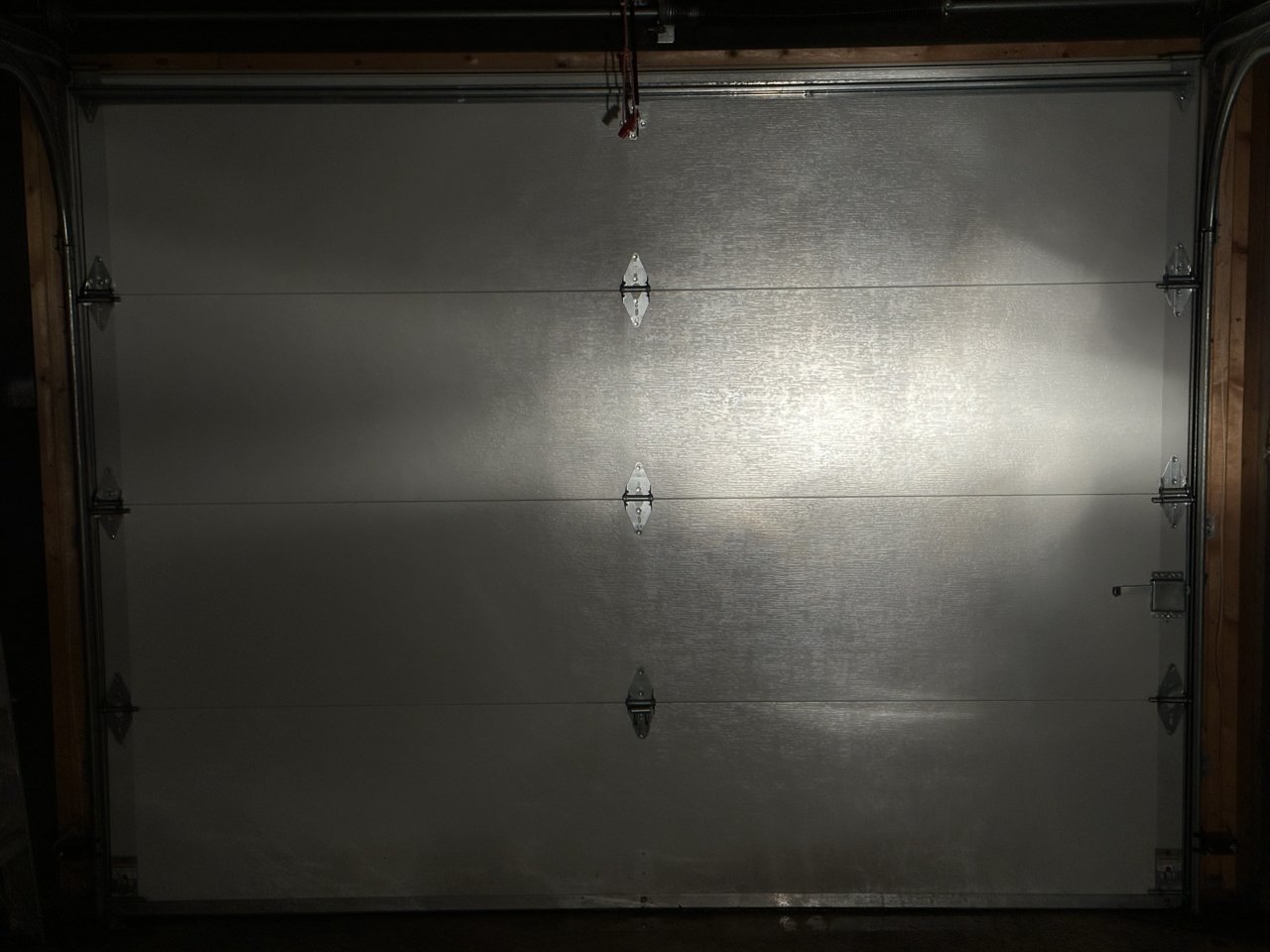

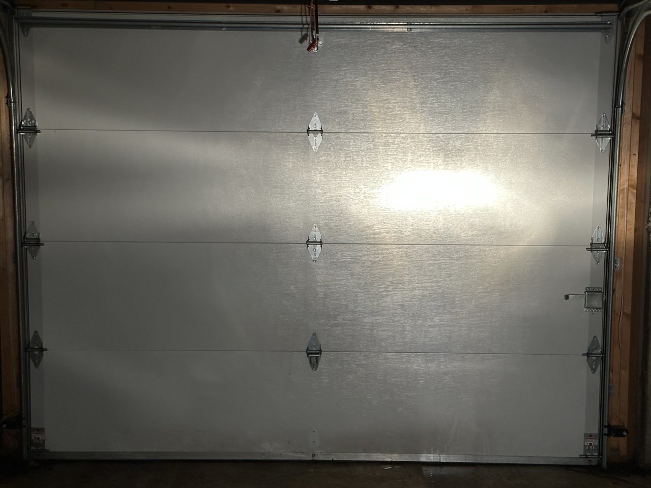

    The Hella 500FF (free form optics)
    The pattern is much more serrated and non-uniform. However it does a reasonable job of concentrating the majority of the output in the horizontal area where it will be most effective without wasting excess light spill vertically. Focusing more light where it is needed without wasting excess in unnecessary areas leads to higher output intensity for a given source.
    Hella 500FF
    So how do the Hella 500 and 500FF compare?
    The Hella 500 does a better job at delivering a smooth pattern, but the 500FF delivers in peak intensity and prioritizing directing the light where it will be most effective.
    So if the 500FF is good, one would think the 700FF would be even better.

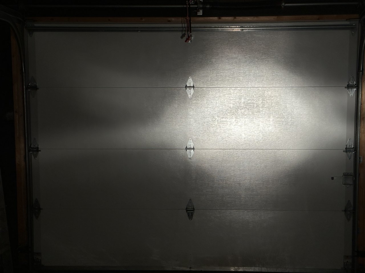

    Hella 700FF
    Impressive area coverage with much more vertical coverage than the 500FF.
    Hella 700FF

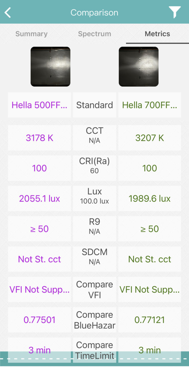

    So how do the Hella 500FFs compare to the 700FF?
    The 500FFs put down higher peak intensity numbers, which is surprising initially because larger reflectors are more efficient than smaller ones with all other things being equal. Except they are not equal in this case. You can see the 700 pattern prioritizes a very large circular pattern with lots of vertical coverage whereas the 500FF is more focused on concentrating the light output into an oblong horizontal pattern where it will be most useful, and by concentrating the light output it can drive higher output intensity values which will project further.
    Between the 3 with stock bulbs, I'd personally lean toward the 500FF based on this data on what I'd want out of a driving lamp. Now I will also test with upgraded bulbs and report the results, which should really tell which lamps have the best optics since the Hella bulbs seem suspect at best.

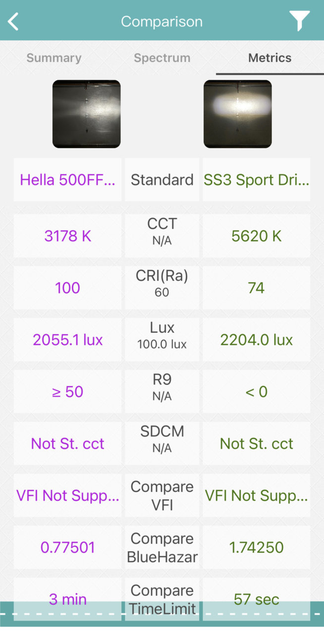

    For some fun comparisons on how these compare to other lamps in this thread using the sub-par Hella bulbs.

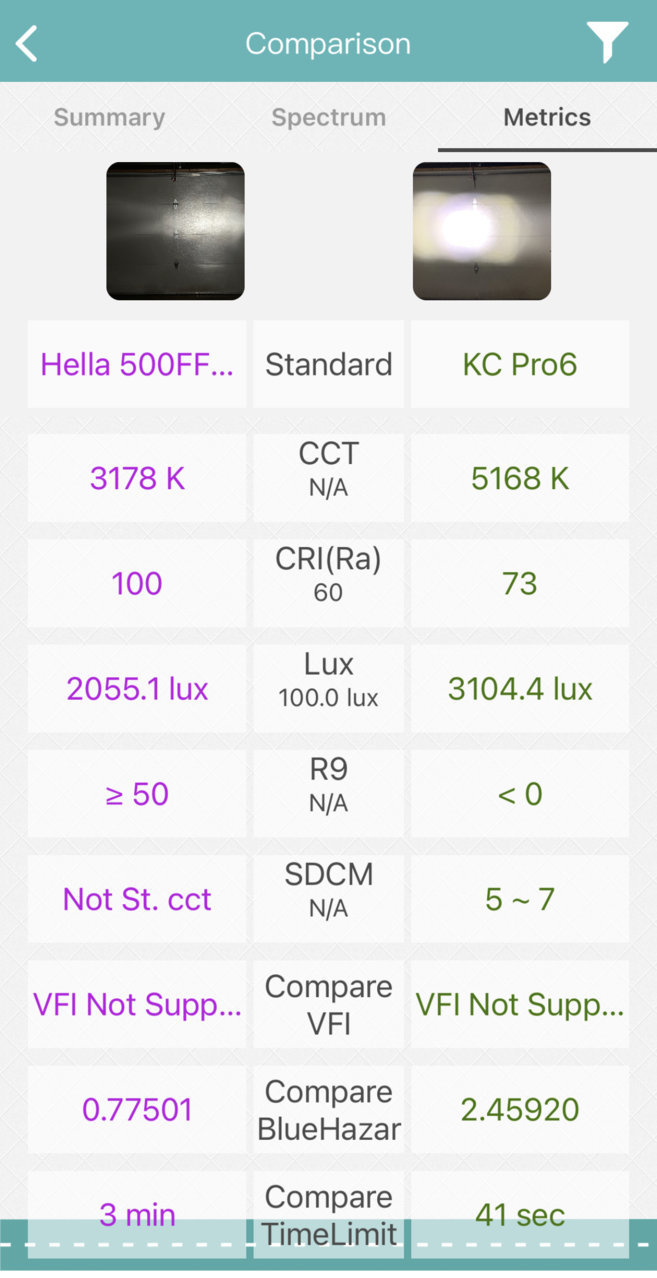

    Hella 500FF vs DD SS3 Sport SAE driving
    The Hella 500FF come impressively close to the peak output of the highly advanced Diode Dynamics SS3s using TIR optics, within 7%. DD has a larger patten area, but the Hellas are a fraction of the price. I bet some of the performance bulbs for the Hellas to be tested later exceed the performance metrics from Diode Dynamics SS3 sports.
    Hella 500FF vs KC Pro6
    If looking for that traditional appearing round light, the KC Pro6 is still hard to beat while also being one of the most efficient lights on the market.

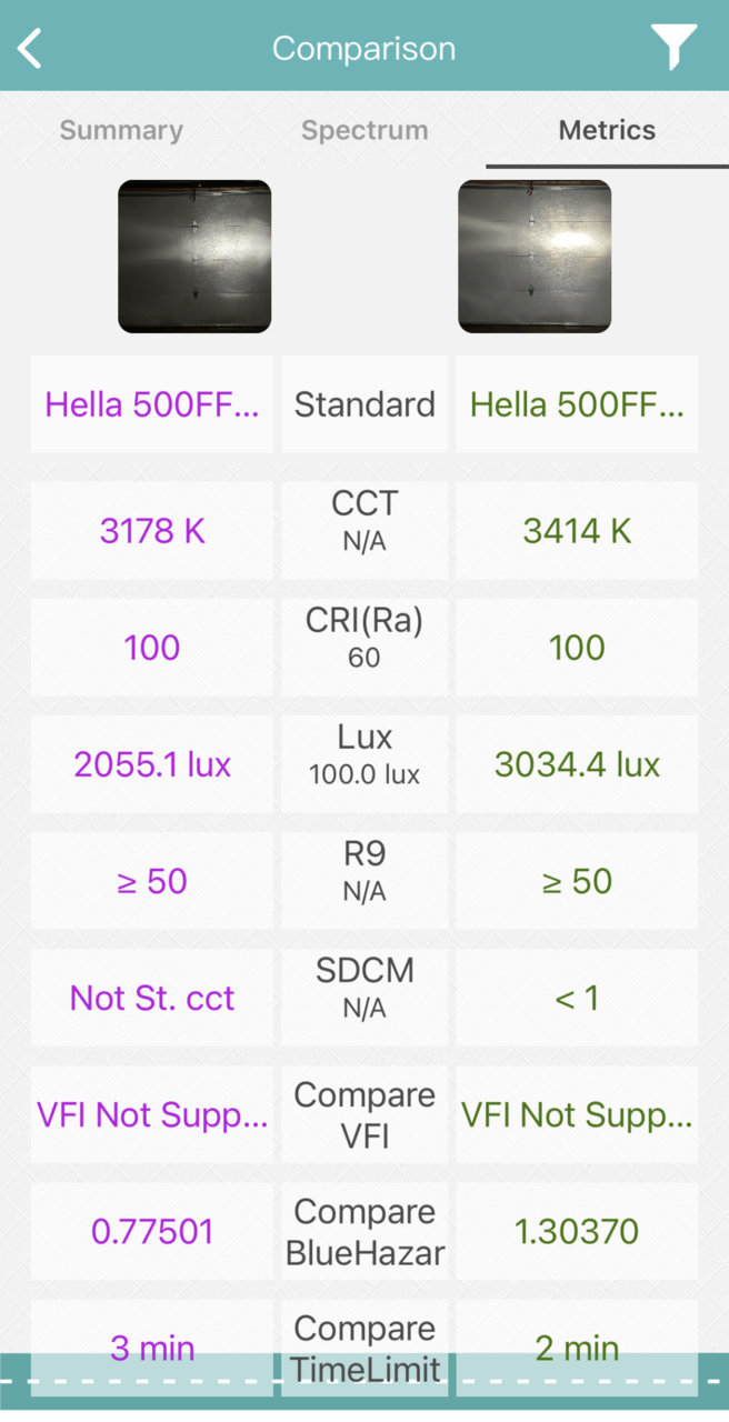

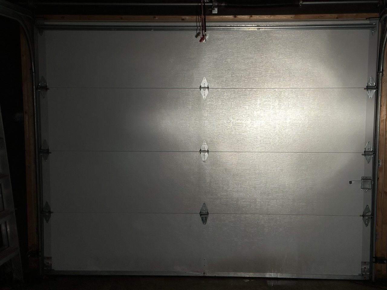

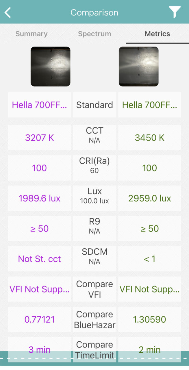

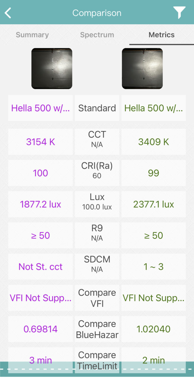

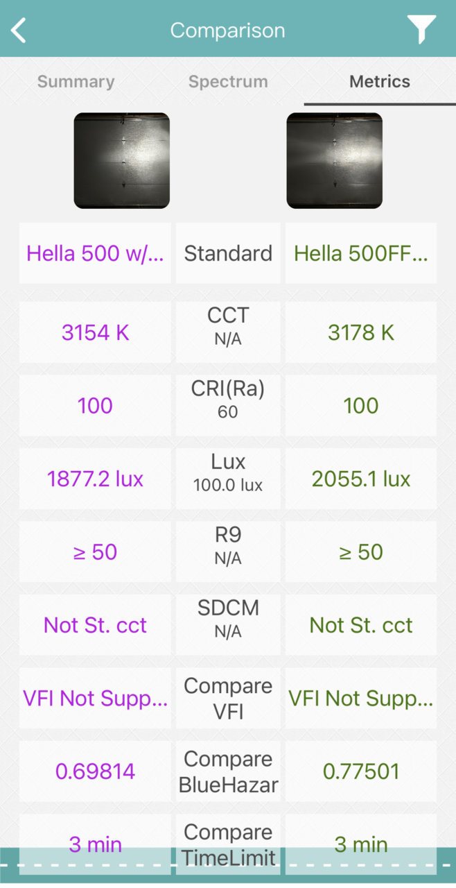

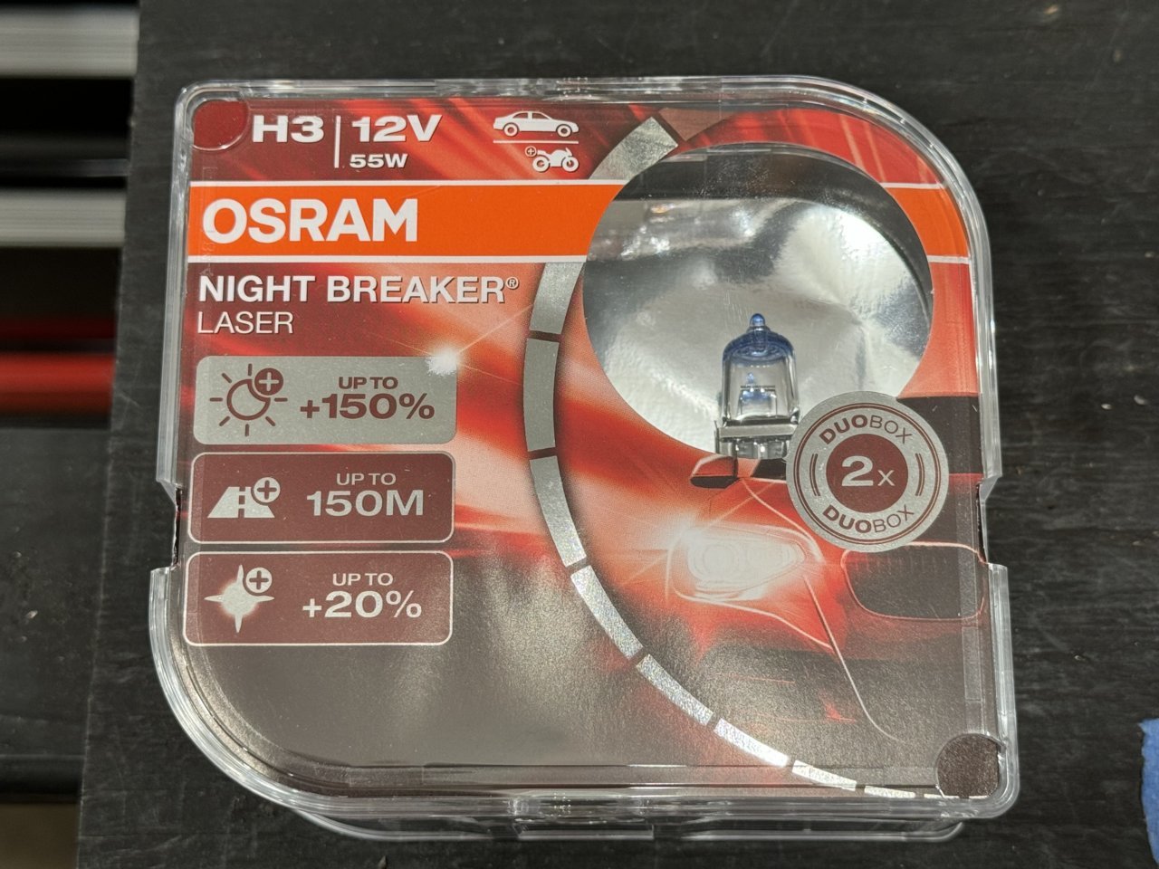

    Hella 500 vs 500FF vs 700FF with upgraded bulbs.
    The Hella 500/700 lamp series use H3 bulbs. At the time of this test, the highest efficiency rated H3 bulb on the market is the Osram Night Breaker Laser +150. So for stock wattage (55w) performance bulb testing in the Hella lamps, these were the bulbs selected.
    It is worth noting that the Osram Night Breaker Lasers pull slightly less power than the standard Hella bulbs. The Osrams pull 69w, vs the Hellas 70.4w.
    Hella 500 with Osram +150
    Hella 500 w/ Hella bulbs vs Osrma +150
    The Osram +150s give about a +27% performance improvement while consuming just slightly less power and a slightly whiter color temperature.
    Hella 500FF with Osram +150
    Hella 500FF w/ Hella bulbs vs Osrma +150
    Wow. The stock wattage performance Osrams provide about a +47% improvement with the free form optics on the 500FFs.

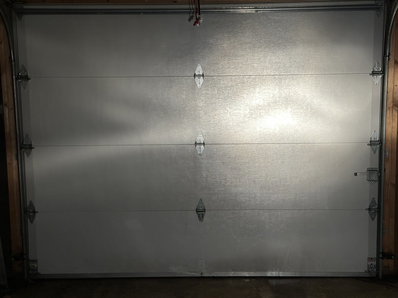

    Hella 700FF with Osram +150
    Hella 700FF w/ Hella bulbs vs Osrma +150
    Wow, again. The stock wattage performance Osrams provide about a +49% improvement with the free form optics on the 700FFs.
    I think what is most interesting here is how the free form optics have almost 2x the performance improvement of the 500 fluted optics. This makes sense as the focus enhancements will be more diluted if using spreader optics on the outer lens vs using the reflector alone.

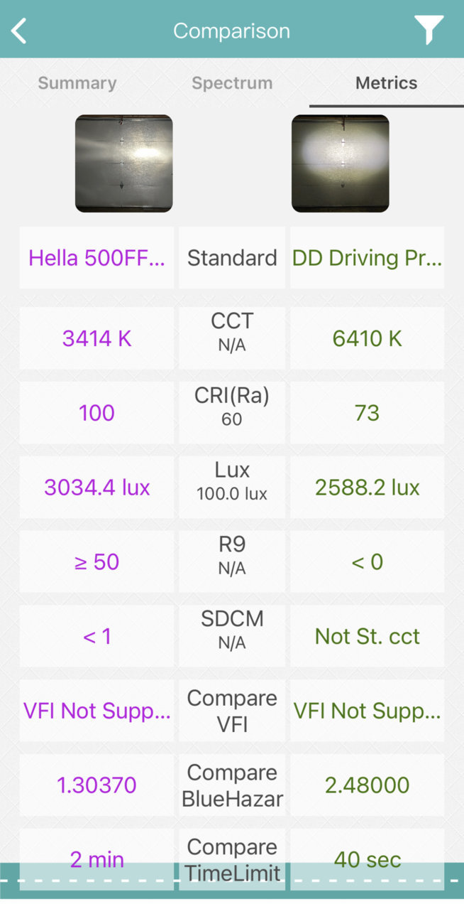

    Recall how I speculated a bulb upgrade would beat out the DD SS3 Sport driving intensity? They beat out the SS3 Sports... and the Pros.
    Hella 500FF w/ Osram +150 vs DD SS3 Pro Driving
    Hella 500FFs with Osram +150s are +17% higher output intensity than the Diode Dyamics SS3 Pro driving lights. Obviously the Pro has a more uniform circular pattern. But a pair of 500FFs with Osrams +150s are about $90 combined vs $300 for the SS3 Pros. You don't need pricey LEDs to have good lighting. No, the Hellas stand no chance against the SS3 Max.

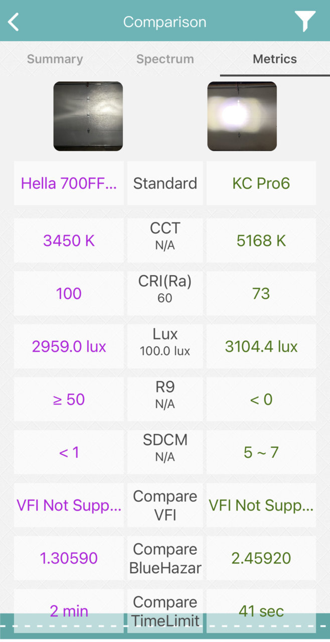

    Hella 700FF w/ Osram +150 vs KC Pro6 Driving
    I used the Hella 700FFs for this comparison since their larger pattern area is closer to that of the KC Pro6 than the 500s. The 700FF with Osram +150s is within less than 5% peak output of the KC Pro6. Again like the 500s, the KC have a larger more uniform pattern area. The KC Pro6 costs about $540/pr. The Hella 700FFs with Osram +150s is just over $90/pr. Again, good lighting options exist outside of the expensive LED lamp options.
    Next up is the high wattage Osram SuperBrights.
