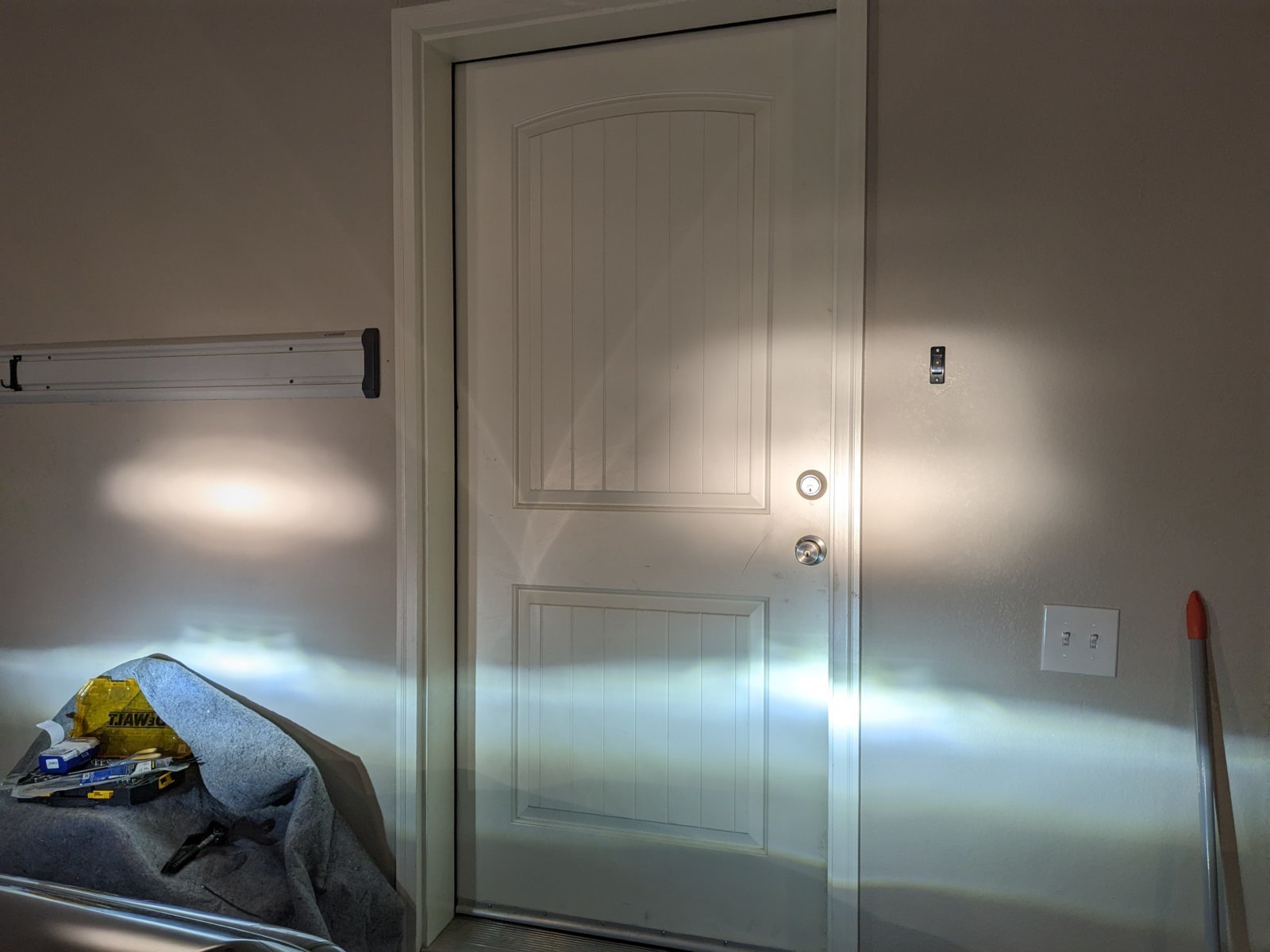

    I ended up mounting the Daylighters by my A-pillars, not ideal from a hood splash perspective, but they don't seem to vibrate much at all. If (when) I buy a bumper I'll mount them level with my headlights.
    One oddity I noticed is that the two lights have different patterns. I assume it's a bulb issue. PXL_20240309_055304054.jpg

    Those are very large lamps for that location. I'd swap the bulbs right to left to check the optics.

    They are, if I'd known I was going to mount them here because it was such a pain to mount them at headlight height I would have gone with something smaller. That said, they work well and look good so I can't complain.
    I swapped the bulb for a brand new 100W Osram and the beam pattern is the same, so I assume it's the reflector. The lenses look identical.

    Hmm, maybe the reflector isn’t seated correctly in the housing. I’d reach out to KC for a replacement if it bothers you.

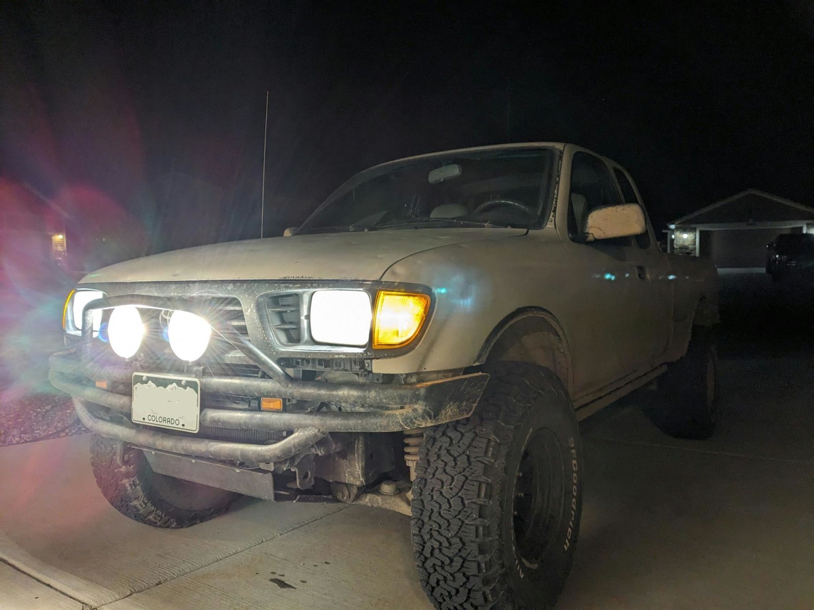

    Seems like I've got light outside of the pattern where I want it, so I've reached out, I'll see what they say.
    Rewired and cleaned the Hella 500FFs that came with the Tacoma. A previous owner had wired them up with about 10' of 18 gauge, so I swapped the bulbs for the 100W Osrams and rewired them with the right length of 12 gauge for enormous performance gains.

    10' of 18ga? Way to turn those 100watters into poor performing sub-50's. Not to mention a fire hazard.

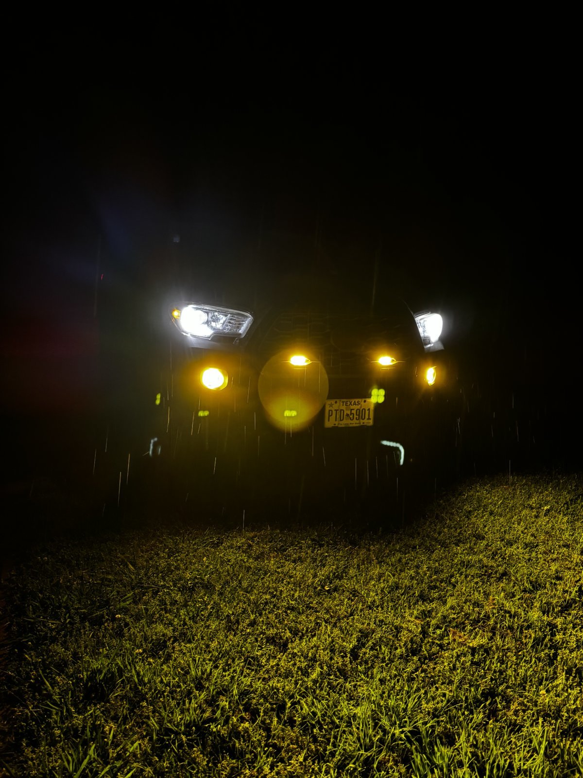

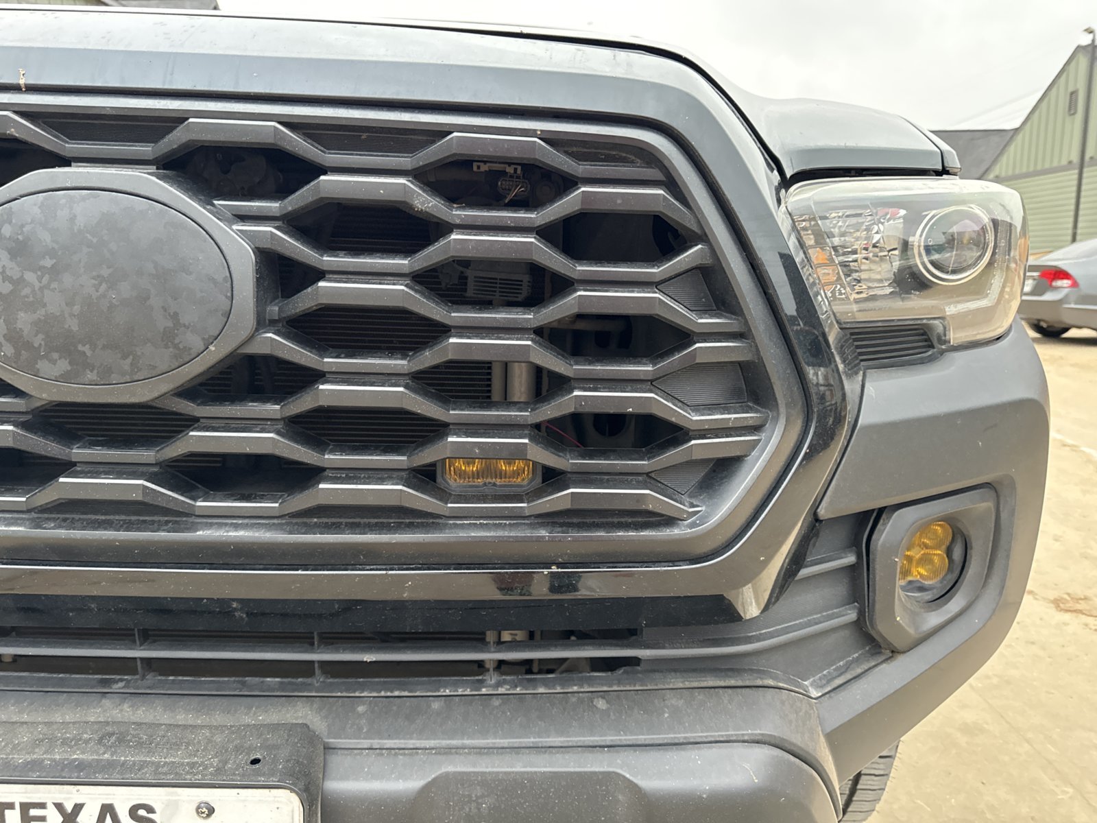

    ss3 fit nicely in grille.

    That's SSc2 in the grill

    Yes correct I put the wrong number lol:rofl:

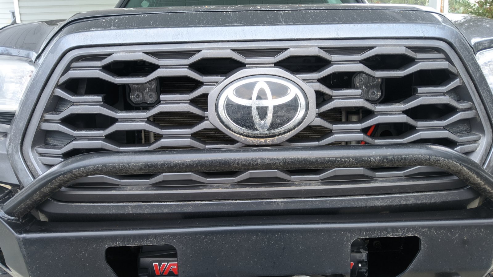

    I have SSc3 behind the grill

    Nice. How did you go about cutting your grille?
    I have some too. I had them in front of my old grille. But I swapped the grille and didn’t put them back on. :boom:
