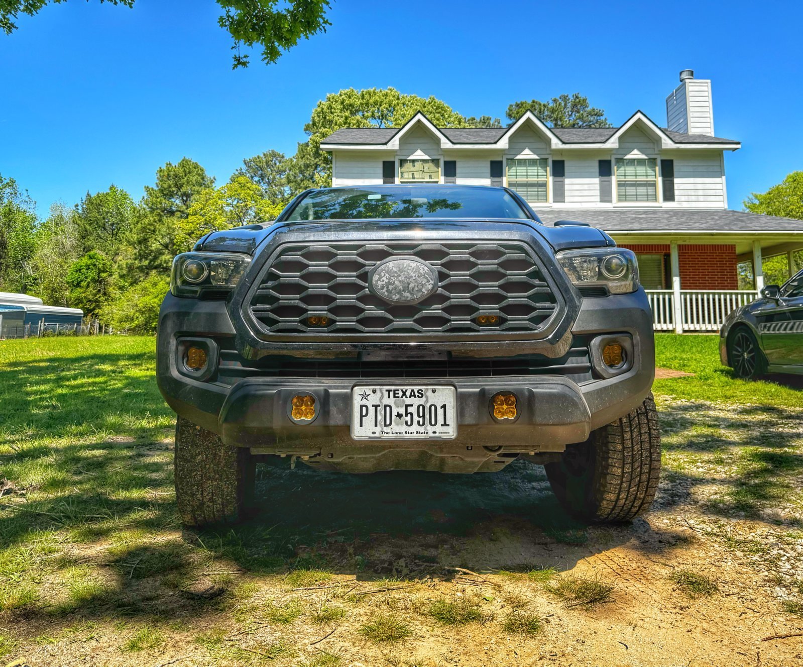

    Went another route and installed them on the bumper cover for now. Now I just need to connect/wire them. :annoyed:

    Clean install, aiming may be a bit trickier. If you can aim them, it could be worth considering swapping the fogs and driving lights. Fog lights you want low, and driving lights higher near the headlights, your current setup is reversed from ideal.

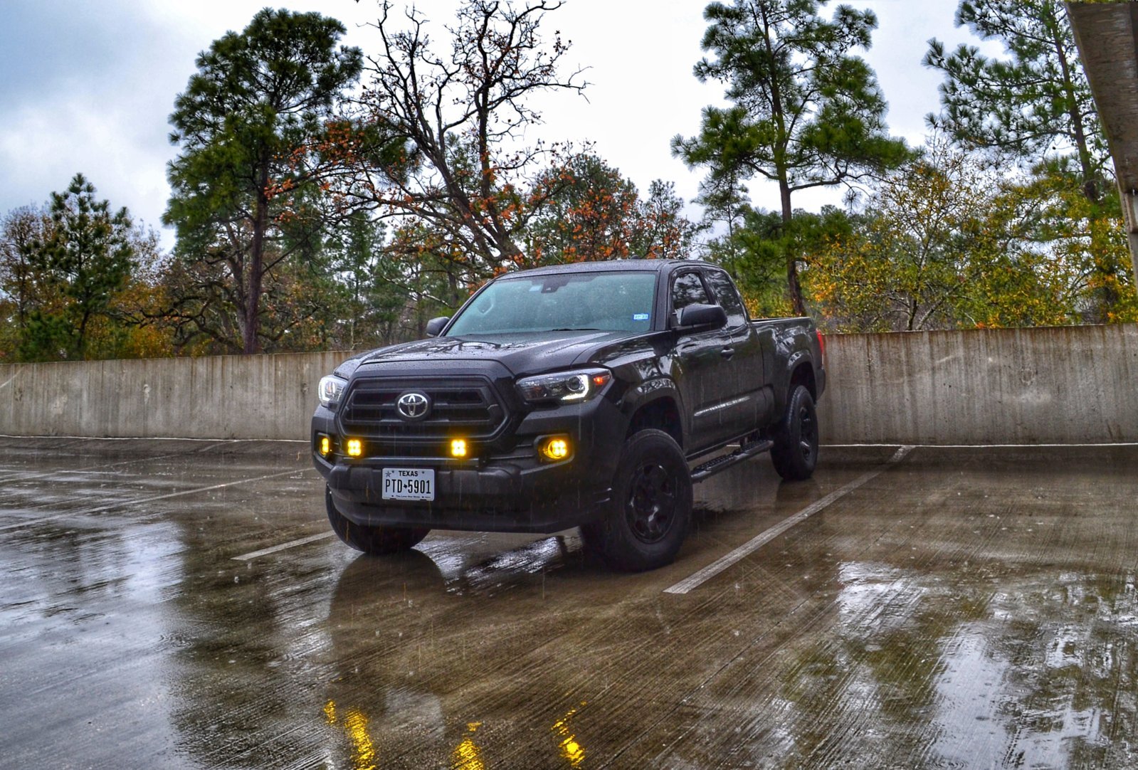

    I also have DD SSc3 fogs, the ones I have behind my grill are wired to my high beams.

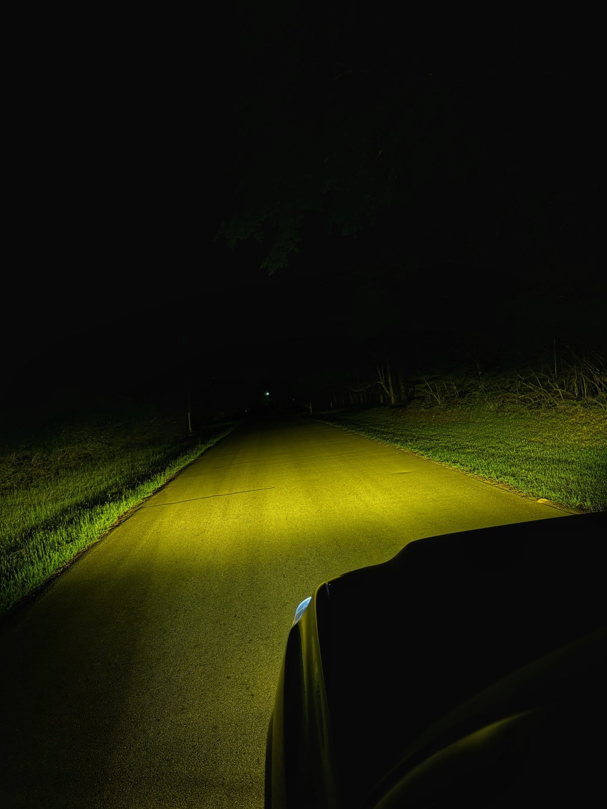

    Big difference. I like! :thumbsup::yay:

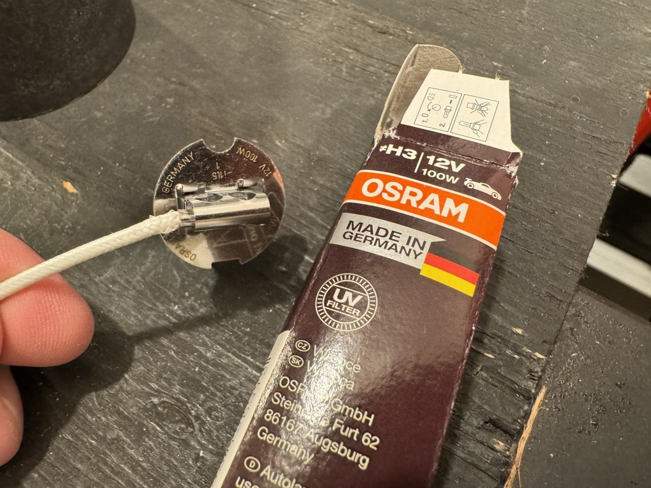

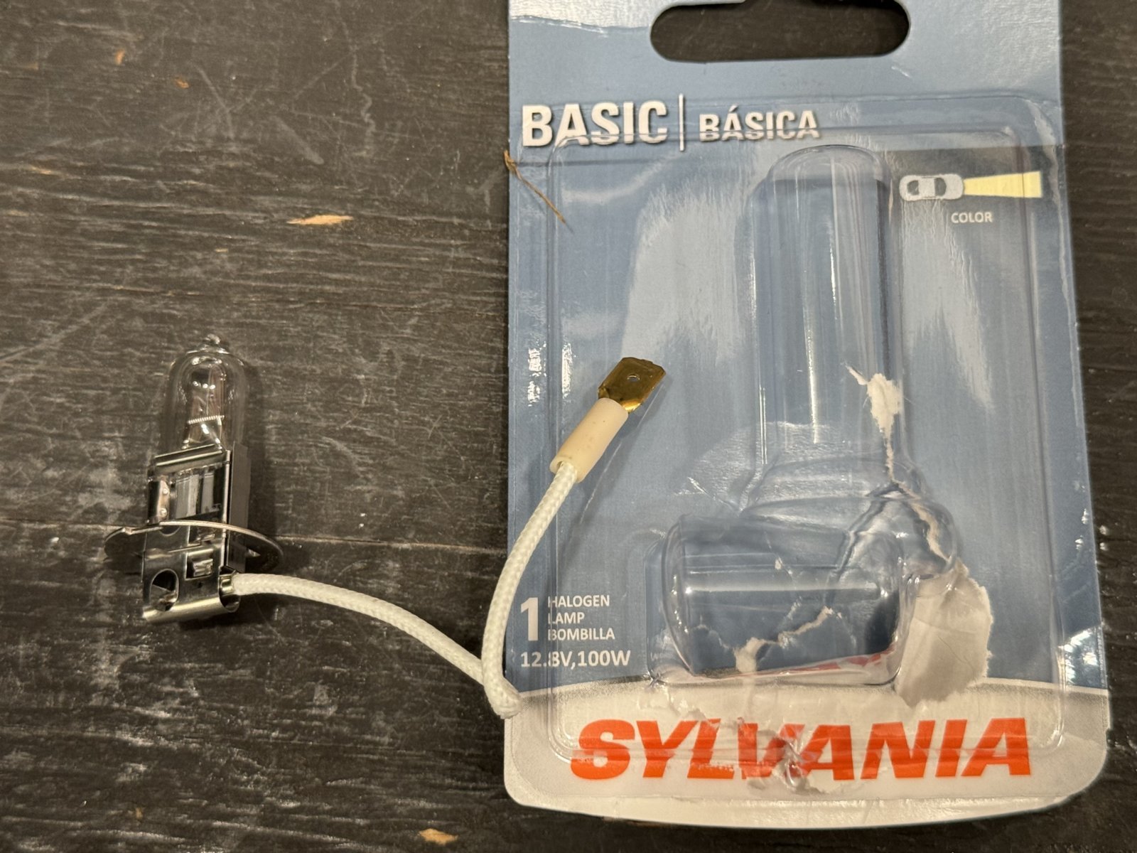

    @enilson inquired about how Sylvania's 100w H3 stands up to the Osram Superbright H3. Both bulbs are manufactured by Osram in Germany, so this posed an interesting question. The Sylvania branded bulbs are significantly cheaper, could it be the same bulb sold under different labels, or could they be a better buy?
    Sylvania 100w H3
    Osram Superbright 100w H3

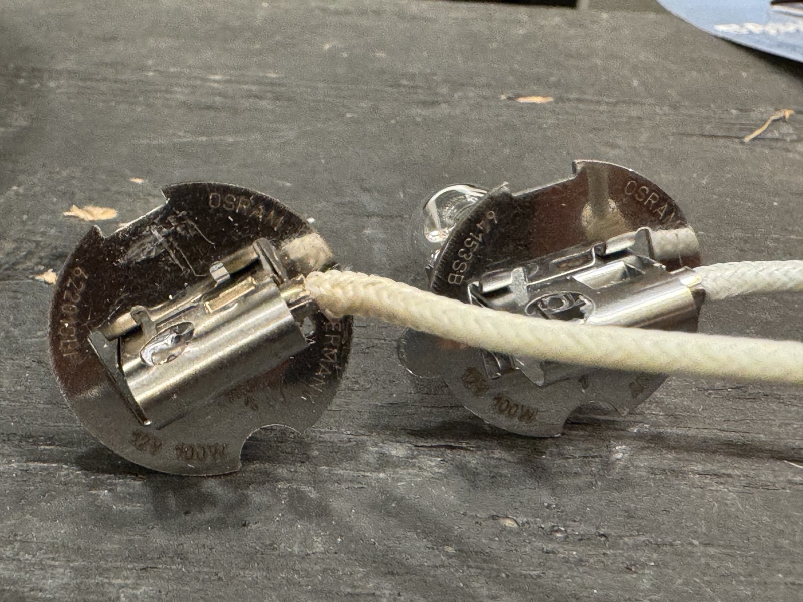

    Comparing the bulbs, the bases are different. These are not the same bulbs sold under different labels.
    Superbrights left vs Sylvania right
    Note the Sylvania bulbs on the right have a protruding round extension on the base in the 9-o'clock position, whereas the Superbrights do not.

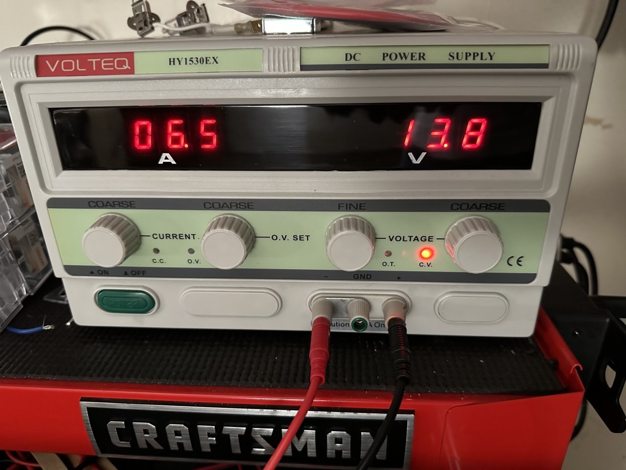

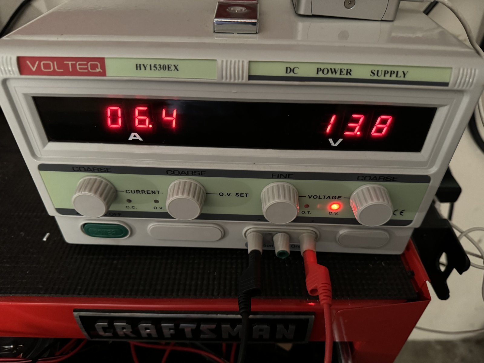

    Checking power consumption.
    Superbrights 100w, 89.7w actual
    Sylvania 100w, 88.3w actual

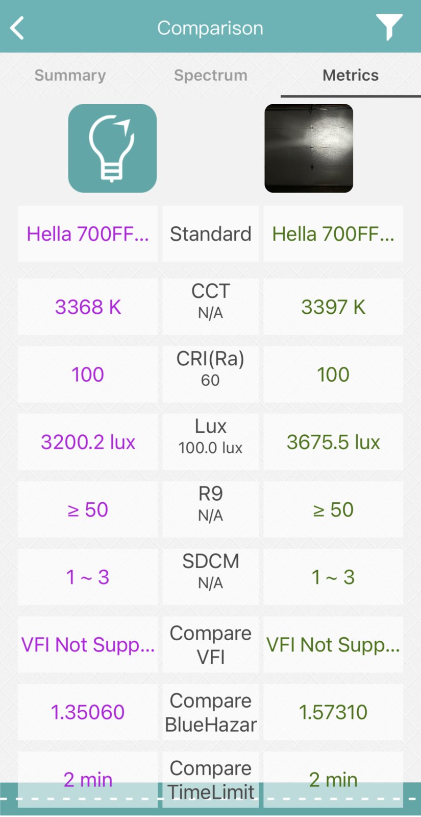

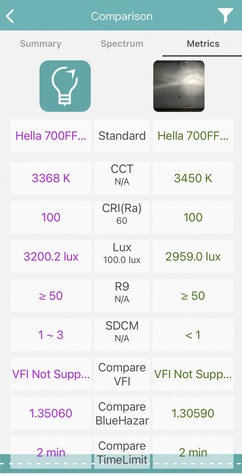

    Measured output intensity
    Sylvania 100w vs SuperBright 100w
    The Superbrights are about 15% higher in output intensity than the Sylvania 100w bulbs. The Sylvanias are quite a bit cheaper, running about $6/bulb vs the Superbrights at about $15/bulb. Where the value proposition lies is up to the end user of course. For myself, I'd spend the extra $18 for the 15% output intensity increase.
    Sylvania 100w vs Osram +150 55w
    Though the high wattage Sylvanias fall short of the Superbrights, they outperform the best stock wattage efficiency performance H3s from Osram, providing a value alternative.
    For absolute best performance recommendations remain the Osram Superbright H3s for high wattage and Osram +150 H3 for stock wattage.
    Special thanks to @enilson for sending the Sylvania 100w H3s in for comparison testing.

    Awesome, thanks for testing! I find the results pretty interesting given that they're both manufactured by Osram in Germany. I'll likely opt for the Superbrights as well.

    Agreed. I was thinking they’d possibly be the same bulb or have similar performance, but that wasn’t the case.

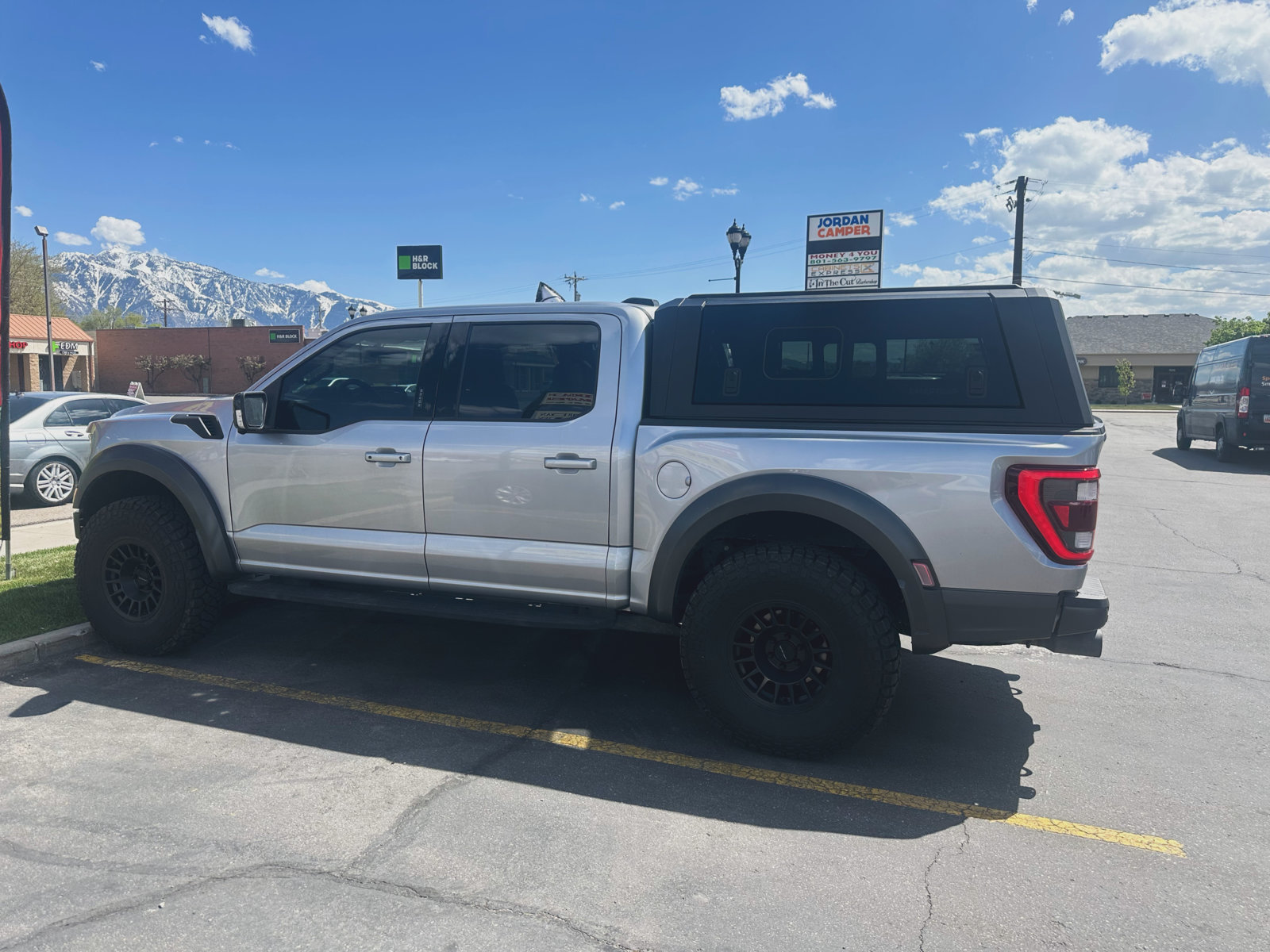

    @crashnburn80
    it’s your old buddy here and lighting nerd….
    Sold my Tacoma and I have a raptor 37pp
    I live in Utah and wanted to get something solid for the snow and for driving in mountains here/going out into the desert.
    what would you recommend? The diode dynamics team has a couple options that look cool.
    They have an ss5 kit for the front that while it’s ugly looks pretty sweet
