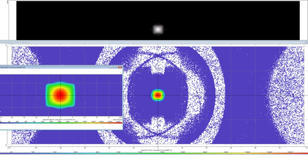

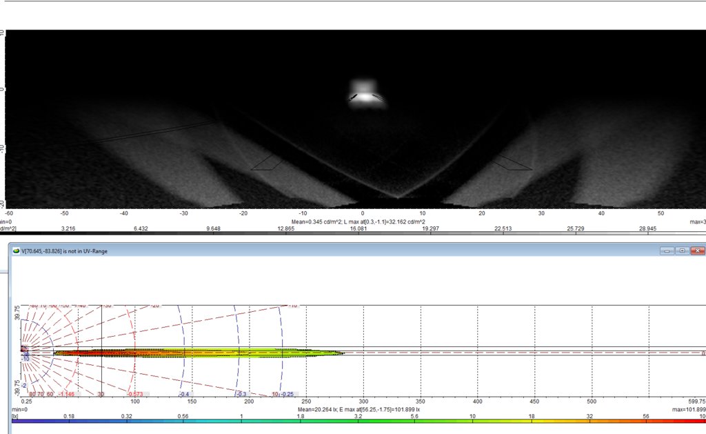

    here, some estimation with similar sized TIR optics pairing with Kyocera 1000lm model. This is purely based on if you can solidly align optical focus in ideal condition without any thermal loss.
    Left bottom, that's 1 Banger Spot beam in same gird scale size comparison. Very small soft edge rectangular hyper spot is expected
    10 lux range about 280m (pair) at straight aim. This beam is still very tight
    This size only allow to cover very small area of far distance zone.
    Above is based on if you make your own optimized heatsink for max 2.5A drive.

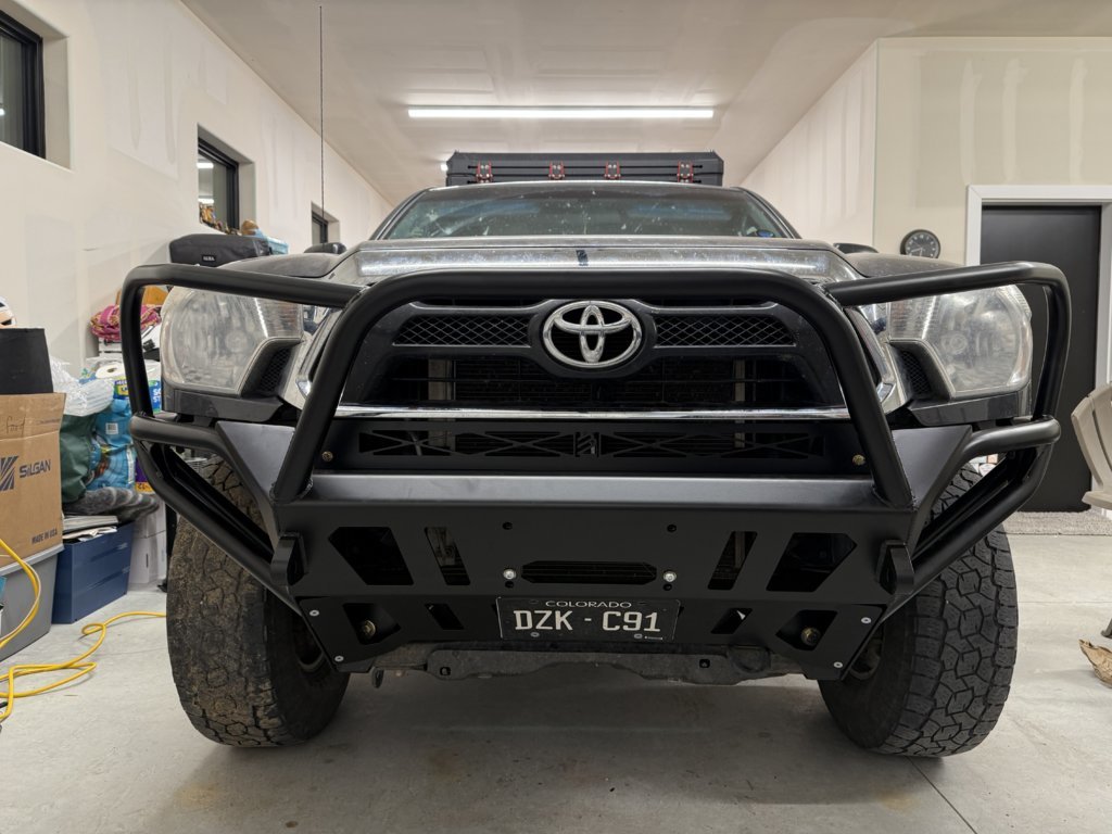

    I have a 2nd Gen 2014 with upgraded headlight harness and am running the Osrams, it’s a massive improvement over stock. But I need better.
    I commute over high CO mountain passes in the dark. I need better visibility for winter storms with blowing snow, animal avoidance, etc. I recently added a hybrid front bumper which provides ample mounting options.
    What SAE compliant aux high-beam and fog set up would you suggest?
    Thanks for everyone’s contributions to these threads, it’s really helpful for folks like me who regularly drive in conditions where light performance may literally save your life.

    Welcome!
    For fogs, assuming you want a 3x3" cube form factor, I'd recommend the Diode Dynamics selective yellow SS3 Pro or Max lights, as tested in the SAE Fog thread. If you have room for something bigger, the Hella 500 fogs perform well also. All of these lights run hot enough to melt snow.
    For driving lights, I'd recommend a high performing halogen light with the 100W Osram super bright bulbs recommended in this thread. KC Daylighters, Hella 500FFs and Hella 700FFs would all fit the bill. I like the wider beam pattern of the KCs, but that's personal preference.

    I'm already running the 100W Osrams. I like the Diode Dynamics products. Thinking the SS3 Max SAE Fogs, selective yellow mounted down low, and the Stage Series 30" Light Bar, White, Driving Lenses, mounted mid grill and linked to high-beams might do the job. Only one way to find out I guess.

    SS3 max fogs in selective yellow (not white) will be a big improvement for the blowing snow conditions you describe. An LED white (6000k) driving light bar will be completely worthless and worse than nothing at all. You’ll get massive backscatter from the snow. High beam patterns like driving will do poor in snow in general. Also if the lamp doesn’t run hot enough it may become snow packed and totally worthless anyway. So for snow you’ll want halogen driving lamps for heat, possibly with some yellow correction, or some very hot running LED driving lamps in selective yellow. Generally speaking though, low beams plus fogs is the best you’re going to do in snow conditions. You shouldn’t be out driving your low beams in snowy conditions, and if you need to use fogs you should be driving even slower. I’d start by adding the DD SS3 Max selective yellow fogs and see what you think. A driving light bar can extend visibility, but is only effective in decent weather.
