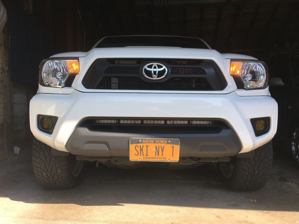

    That's exactly the combination I ran on my 2014 Tacoma and I loved it. (The Ultimate Headlight Upgrade with the good OSRAM bulbs, DD SS3 Max fogs and a DD 30" Stage LED bar with all Driving lenses.)
    Crash is 100% correct in that you won't want to run the high beams and light bar in the snow though.

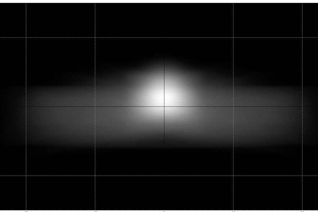

    It's highly effective as high beam on road usage. 2Banger HXB combo lens actually provide beyond J581 high beam capability It actually pass as UB2 ( headlamp integration, standalone or bi-function high beam addition usage) It does not have massive flood but width spread is concentrated in proportion to natural enhance upper range visibility and ample width.
    I am not tacoma owner, but I am using to test ( I design those)
    My config is HXB Spot on one side, HXB Combo on other side. I think HXB spot is bit too loose for me. I likely will suggest NCS Spot and HXB Combo combination.
    I have MLED2.0 for my main beam, set spot on driver side, combo on passenger side. To me, it gave me most comfortable high beam assist function.

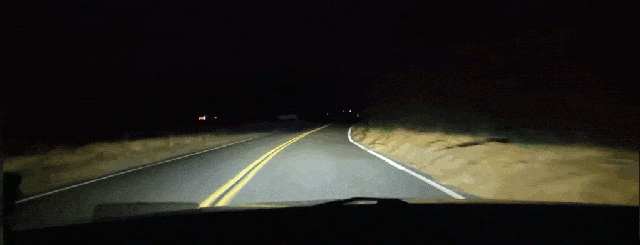

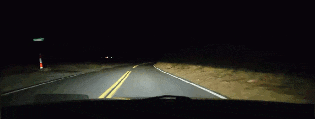

    Sorry for low res, below are screen shots from driver perspective video
    This is Low beam + AUX high (2Banger 1x HXB spot 1 x HXB Combo) to show coverage addition ( I didn't take photo or video AUX high portion only, but hope you can see coverage)
    spot beam is aimed bit high relative to combo beam center.
    Even 2Banger HXB spot beam, beam is too large for spot ( because I am using as range boost combined with main beam)
    With usage of main headlamp high beam, it supplement range very well for its compact size.
    I didn't think many interested in 2Banger, but I will gather more pictures if anyone interested in.

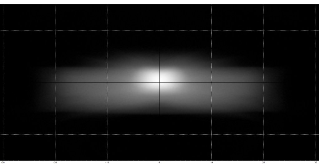

    Here is combo lens distribution
    Here is This is 1 x Spot 1 x Combo combined beam this is essentially beam pattern of my AUX high set up

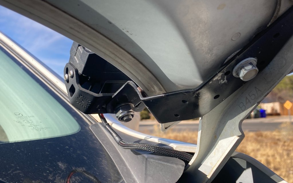

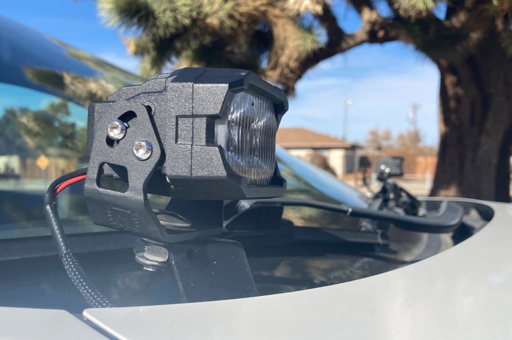

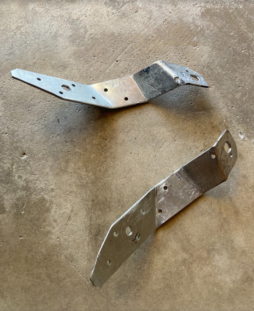

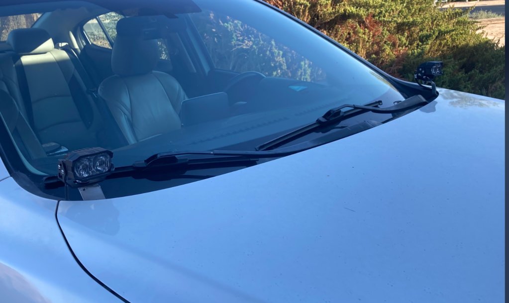

    Some homedepot trip, hammer and vise, bit of blacksmith skills was required. Driver side, wiper clearance probably is the hardest fabrication point I think.
    upload_2024-12-13_12-30-48.pngupload_2024-12-13_12-33-52.pngupload_2024-12-13_12-47-39.png
    i had to make it so close to gain wiper clearance, felt cushion used just in case. BTW, pod mounted height is slightly higher ( about 5mm) on driver side, for that wiper clearance challenge reason.
    Driver perspective is like this
    I wanted to position bit outer, but bending those plate manually to desired shape was hard. I am OK with it. Very compact. Certainly will look different with Tacoma, my car is 15 Mazda3.

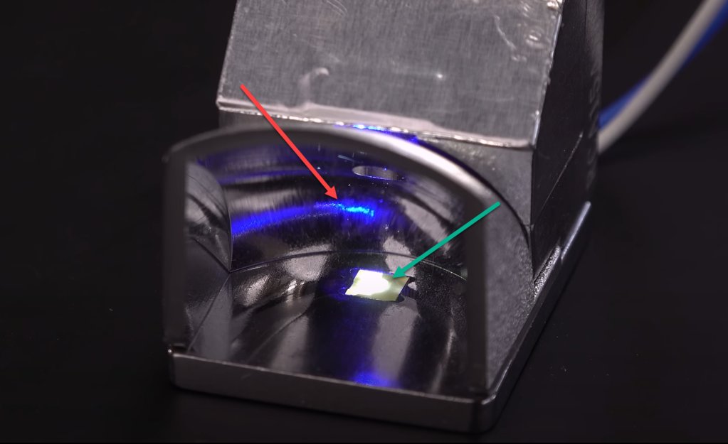

    I am bit worried about that unit safety, and long distance remote phosphor design hugely compromise with emission position tolerance.
    Unconverted laser scatter is one of concern. then, emission position on phosphor is questionable. Beam dump ( unconverted laser capture structure) is not designed in this model.
    Mirror receiving very tight optical density, if this mirror even slight misaligned, laser dump can fail, major hazard
    I can't tell quality of that lamp, but from it looks, bit questionable and I think biggest issue is cooling.
    Laser and phosphor both require strong cooling, if data is logged at 25C condition, at ideal operating temp of 60C, 20% flux down. If it goes to 110C, 70% flux down.
    Module look compact, but it will need massive heatsink to keep laser temp low enough realistic output likely is 1/3 is my prediction.
    I just don't feel comfortable using reflective phosphor without beam dump safety design.
    I would use safety feature integrated solution like Kyocera one, or Giga White by Nichia.

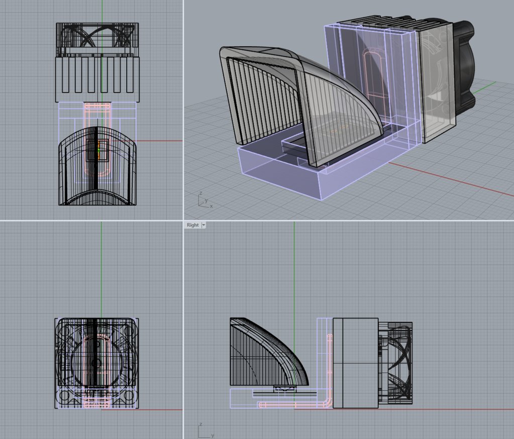

    I made similar sized mock up, using protected reflective phosphor model. Pair this one with pretty hardcore fan (9000rpm) and heat pipe, max it handle likely is only 10W of heat power.
    To enjoy higher output, heatsink must be even bigger ( grid major line is 5mm, minor line is 1mm btw)
    To give minimally useful spot size, something like this is plausible, but I would say, 150,000Cd super tight spot beam is expected final output upper hope (reasonably with front headlamp lens on or protective front lens on)
    Compact size is attractive, but even with robust cooling, optical efficiency is pretty low and cost also is much higher than LED. Not saying it is useless, but his type of hyper focused spot beam is very hard to use in my opinion.
