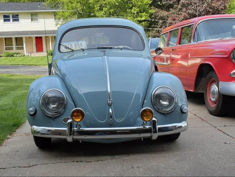

    I wish KC would consider a driving G4, I'd get a set for my bug. I'll probably end up using the set of SS3s I have in the garage, but there's something that looks way better about round reflectors on classic cars.
    (not mine, and these are fog lights)

    You could always try to find a set of the 5-3/4" LED cibies.
    Don't order then from the Amazon store for valeo though. They shipped me three sets of dorman door handles instead.

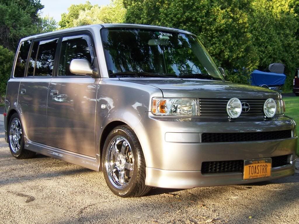

    I have the exact same problem with my 2006 Scion xB daily driver. I have a perfectly good set of Diode Dynamics SS3 Pro LED pods with either clear driving or selective yellow fog lenses sitting in my stash. On the xB, I have a perfectly good set of Hella 500 halogen driving beams with 100 watt bulbs. The SS3's would absolutely blow away the Hellas with either lens. But, they just wouldn't go with the look of the car. Bummer.

    Excellent plate.
    You could get a set of the round bezels for the SS3's
