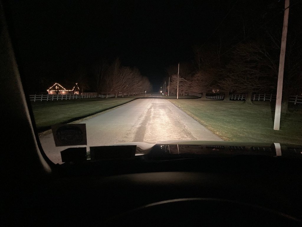

    Having a set of SS3 Max Selective Yellow fogs and a set of SS5 Pro Spot beams, I might be able to help you. The first question you have to ask and answer is "What do you want these "driving lights" to do? Are you looking for longer reach with some width to the beam pattern? If so, the SS3 or SS5 in a Driving beam optic would both work well with the SS5 having more power. Are you looking for pure distance? If so, the Spot optic would be best.
    For reference purposes, here's the view from the driver's seat of my 4Runner with the SS5 Pro Spot beams and my high beams both on. There's a solid half mile of light in front of me.

    With my SS5's. I started with selective yellow Fog lenses, but ordered a set of clear Driving lenses because I wanted a slightly warmer color temperature. I didn't like the width of the Driving pattern (too wide), so I swapped in a set of clear Spots. The high beams give me all of the peripheral lighting I need and the SS5's give me the distance I wanted.
    You mentioned Cibie lights. I actually started with a set of Cibie Oscar driving lights that I had from a previous vehicle. Even with the best 100 watt H1 bulbs money could buy, they didn't hold a candle to the SS5's.
