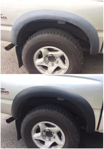

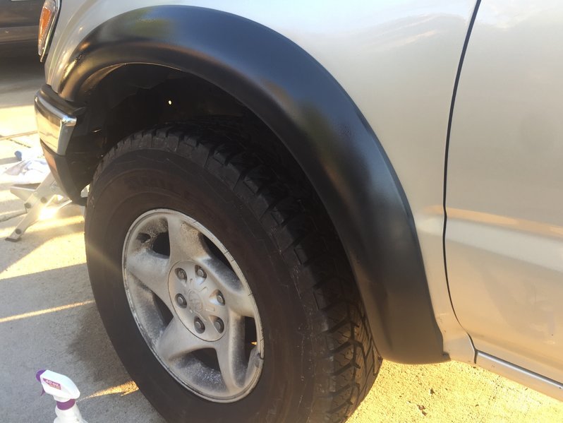

    Today during lunch I got out the company heat gun and went to town.
    Magic fender flare fade restorer
    Works like this:
    Did all 4 in 30 mins, then another 30 for the two bumper trim pieces.

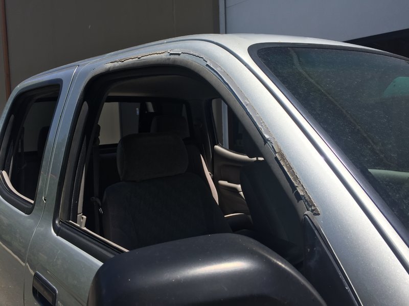

    The heat gun made quick work of the foam tape left over from some old deflectors

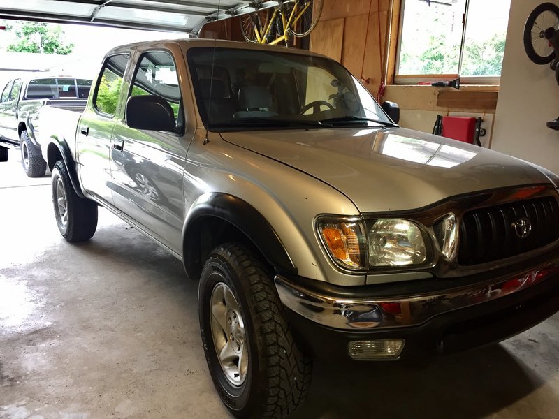

    Then when I got home tonight I got to work scrubbing it

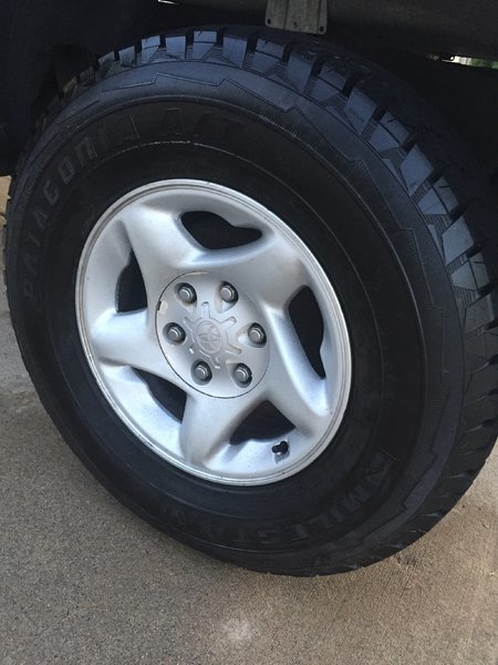

    The wheels hadn't been cleaned in ages

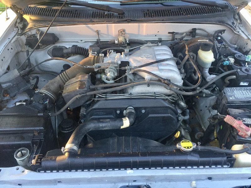

    Engine bay tidied up nice

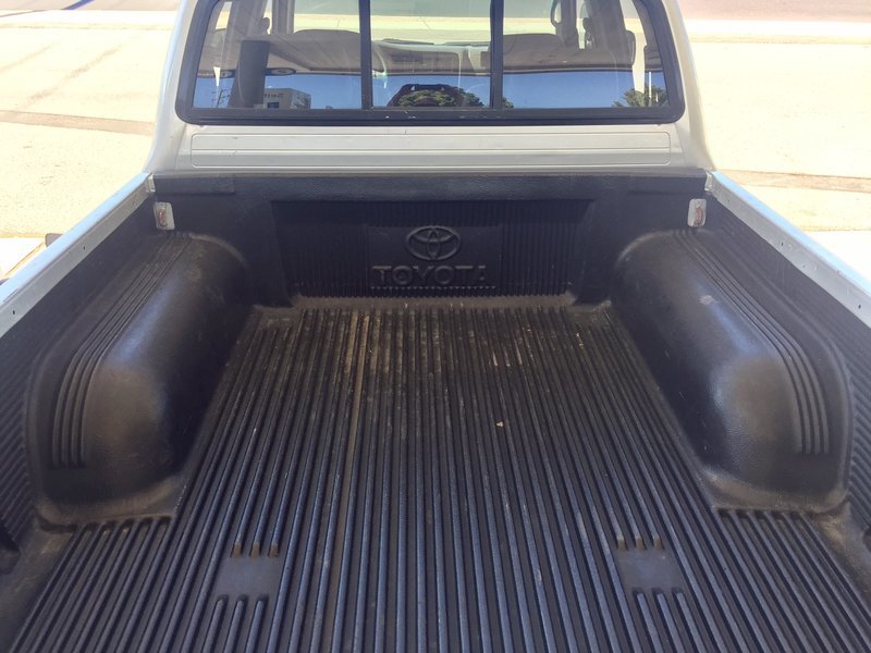

    Spent awhile working through the layers of dirt caked in the bed.
    Once dry, I shot 3 clear coats over the heat-gun-restored plastic for some UV-resistant longevity

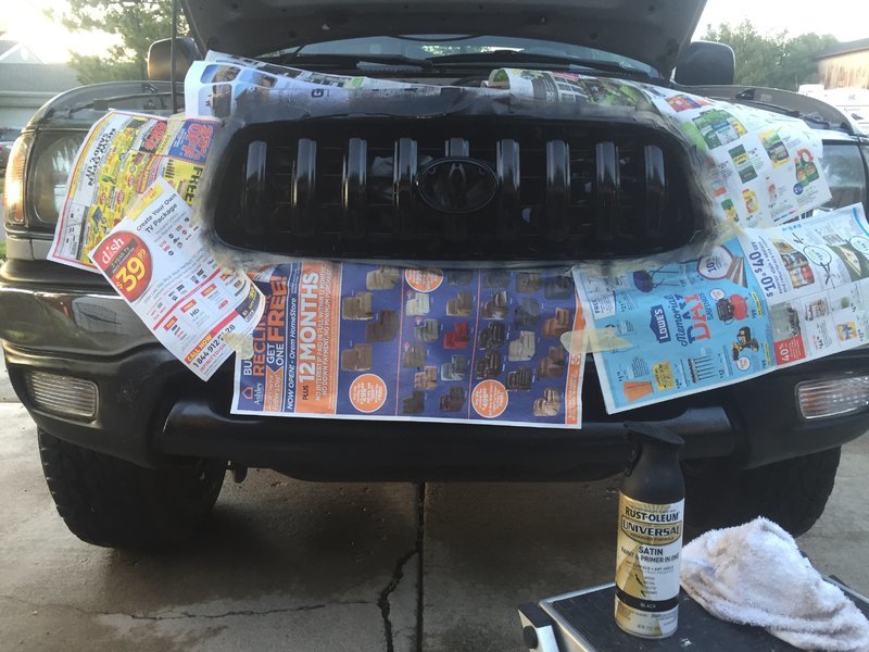

    The grill was ratty looking. That won't do.
    Some questionable body work had been done on the front bumper cover / grill surround. That took awhile but it's all good now.
    Tidied up the interior, fixed a few little things there too.
    It's looking good. 1st gens are so fun to drive around, such a different beast than 2nd gens.

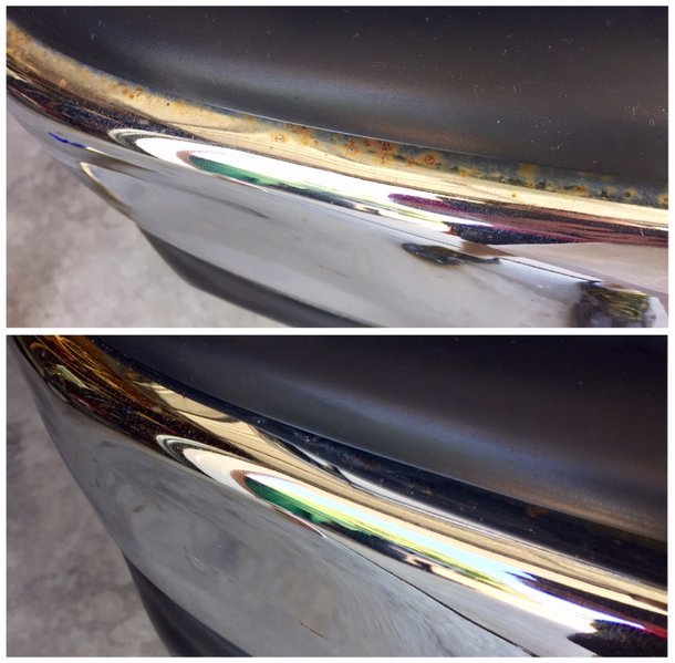

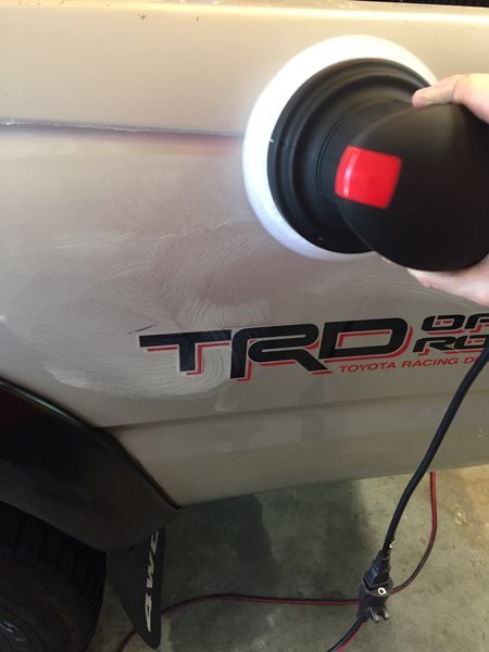

    you CAN polish a trd
    Bar Keepers Friend works wonders on chrome. Those inevitable rust spots cower in fear of BKF and disappear with minimal effort. Love that stuff.

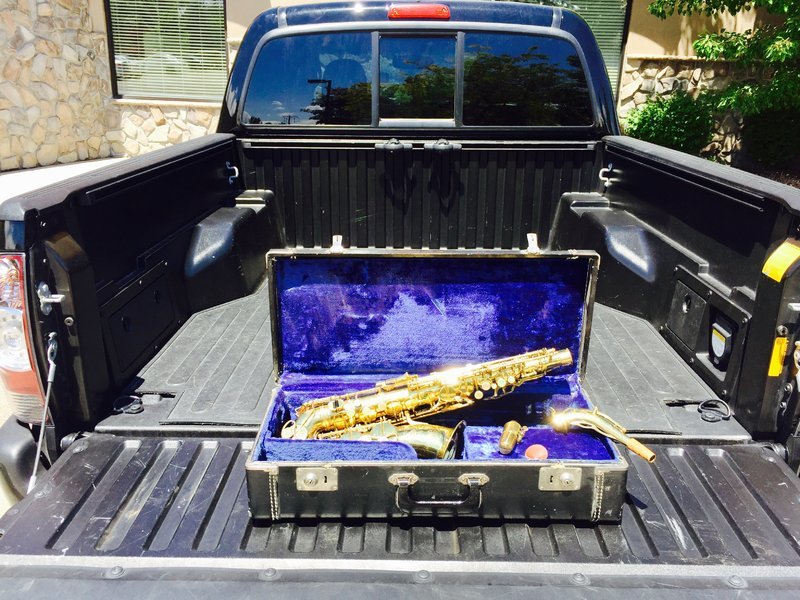

    Enjoyed a nice drive across town during lunch to pick up a rare brand of alto sax from the 1960s:

    Mark 6?

    I wish. Still trying find a good one of those. This one's a Couesnon, needs a little work but got it for a good enough price.

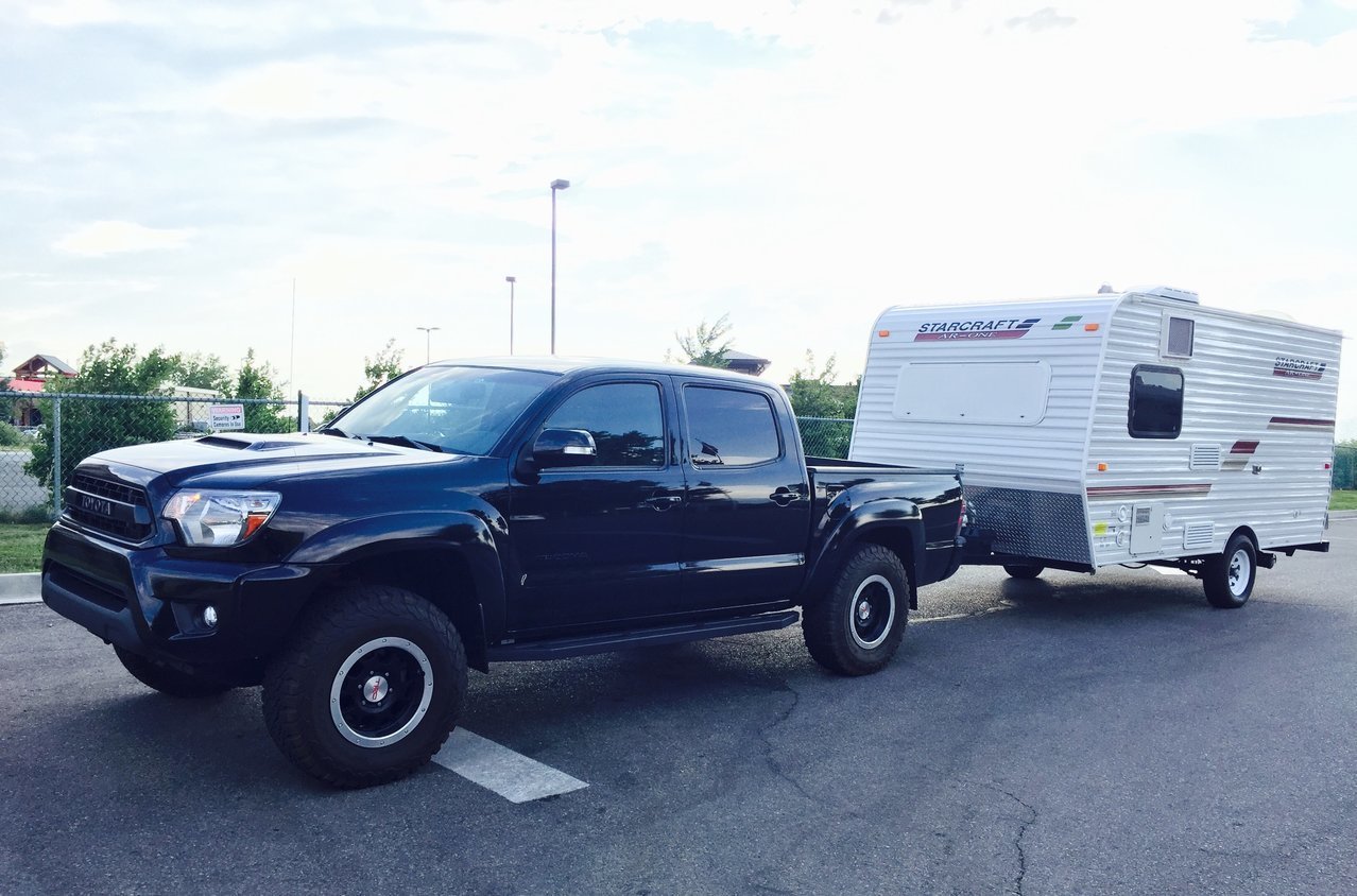

    Roughing it in the great outdoors with the kiddos this weekend

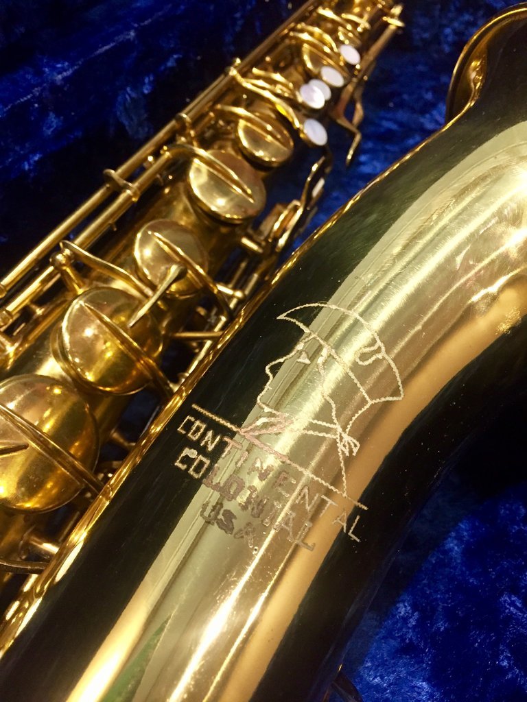

    Small road trip in the Taco to pick up a tenor sax last night: 1950s "Continental Colonial" complete with a soldier engraved on it. It's in good shape and will be a fun project.

    The heat gun thing on 1st gen fenders is more of a used car dealer trick (aka make it look passable until it's sold). The better way to do it is mask off the truck & spray the fenders with Rustoleum Universal black satin. No need for a clear coat on top of that, and it lasts for years.
