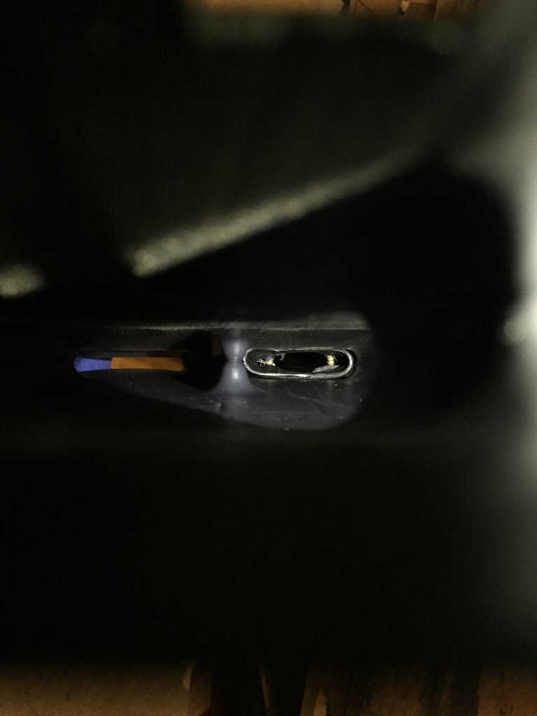

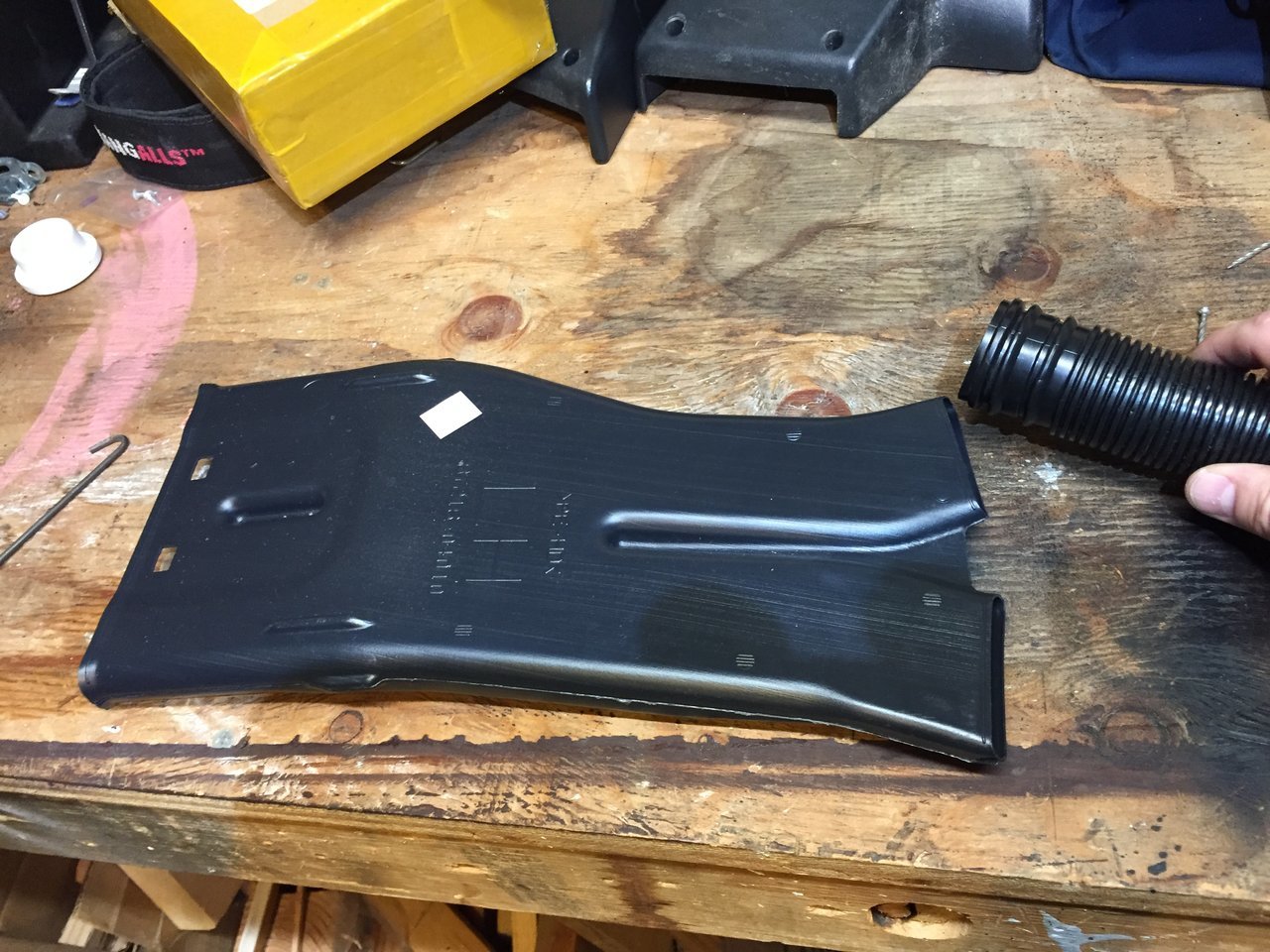

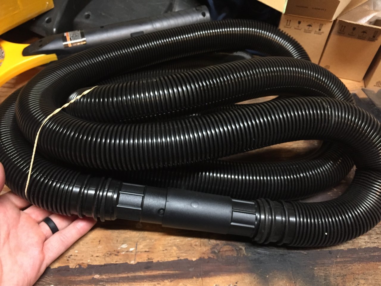

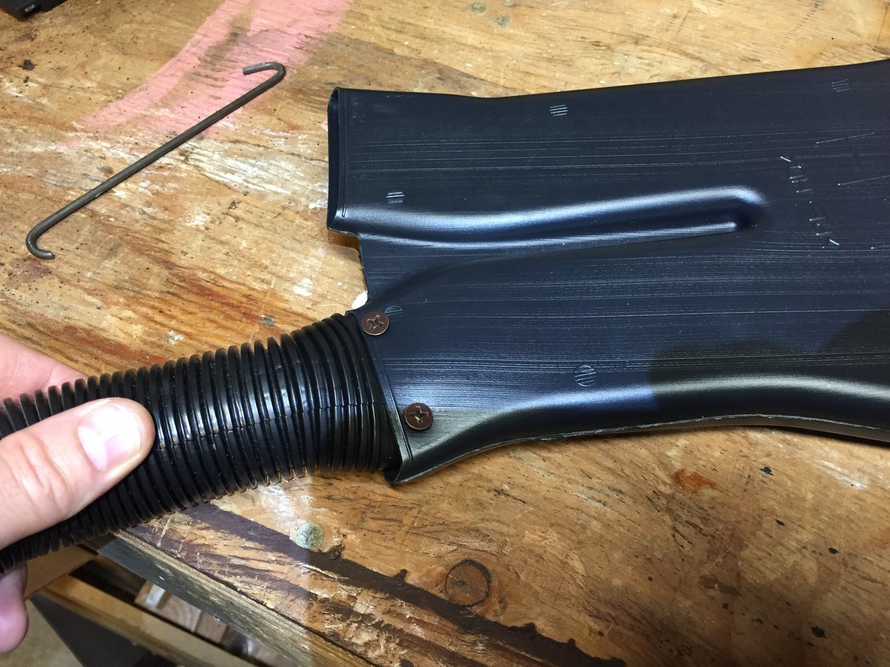

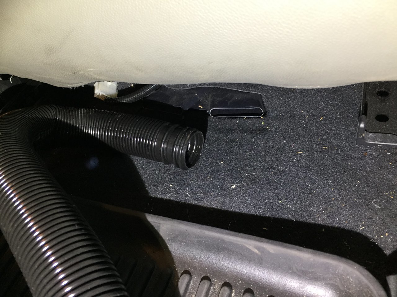

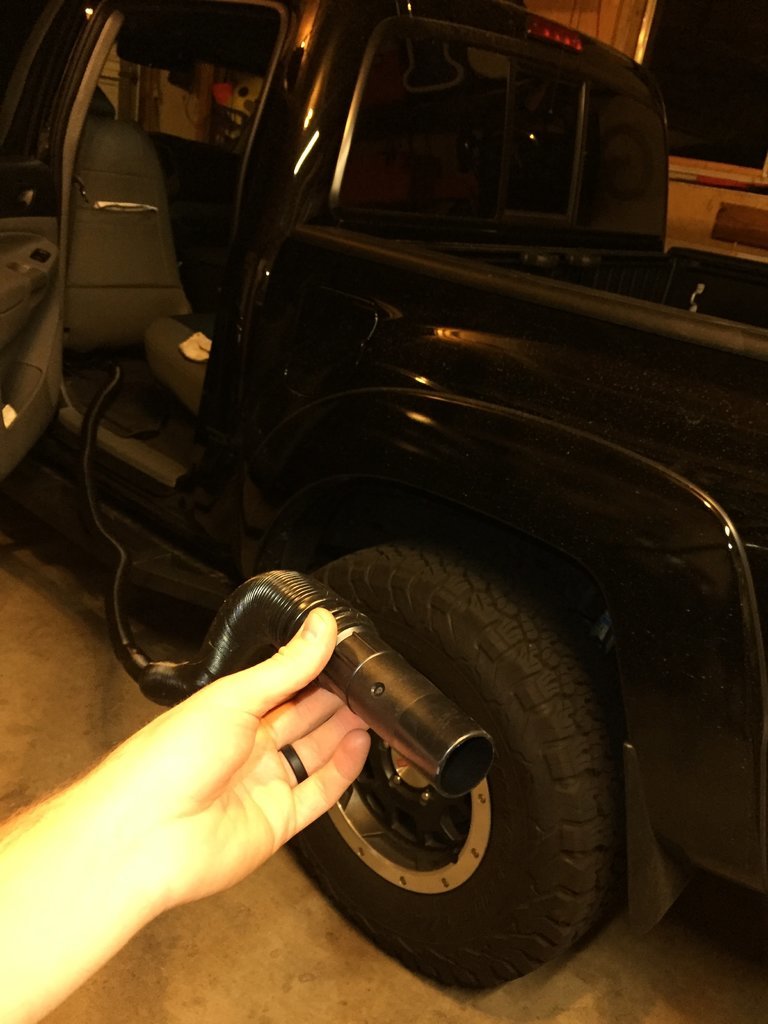

    Progress on the butt cooler. I found some random vacuum hose lying around & it turned out to be perfect. Mounted it to the air vent under the seat and I'm getting airflow 10 feet back - definitely should work. Just need to mount it under the seat now.
    IMG_5270.jpg IMG_5271.jpg IMG_5276.jpg IMG_5277.jpg IMG_5279.jpg IMG_5280.jpg
    Waited many moons likes this.
  19. Sep 14, 2017 at 11:41 PM
    #79
    RyanL
    RyanL [OP] Well-Known Member
    Feb 20, 2012
    #73265
    3,479
    Indiana
    15 TRD Pro, supercharged, BP-51s, etc
    After some trial and error I figured out a simple and effective way to make this work.
    The fan blade sits right on top of the white mesh filter, so anything that touches it will stop the fan. That ruled out an enclosed setup. The version pictured directs the air right at the fan but leaves it disconnected with about a 1" gap. That way there's no worry about sliding the seat back and forth or someone in the back seat accidentally kicking the new pipes.
    Here's the total list of parts required:
    5" of 1.5" diameter shop vac hose
    5" of 1" diameter PVC pipe
    a 1" PVC elbow
    4 screws
    Pretty simple installation as shown in photos above. I can do a full writeup if anyone needs but I'd be surprised if 2 people were ever helped by this.
    Anyway, it's super effective. Here's before, with standard Katzkin Degreez vented seats:
    Outside temp was about 80 degrees so it's a bit cooler and the air movement does make a difference.
    But now here's the actual cooled seat with my A/C air blowing through:
    ^ that's the stuff right there. About 20 degrees cooler.

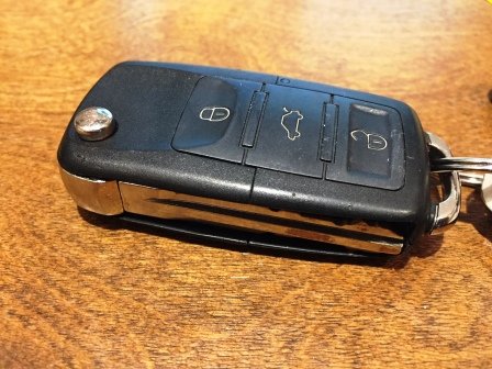

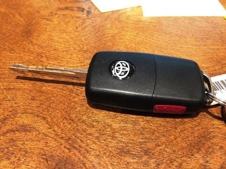

    One of the best changes I made to the truck early on: the all-in-one remote flip key
    It got old fast carrying around the standard key + separate remote fob (I'm a pocket minimalist) and this reduces the bulk.
    I'd forgotten about the fact that it's not OEM till the kid at Discount Tire got all sorts of excited about it (he also drives a Taco). He called it an "Audi key."
