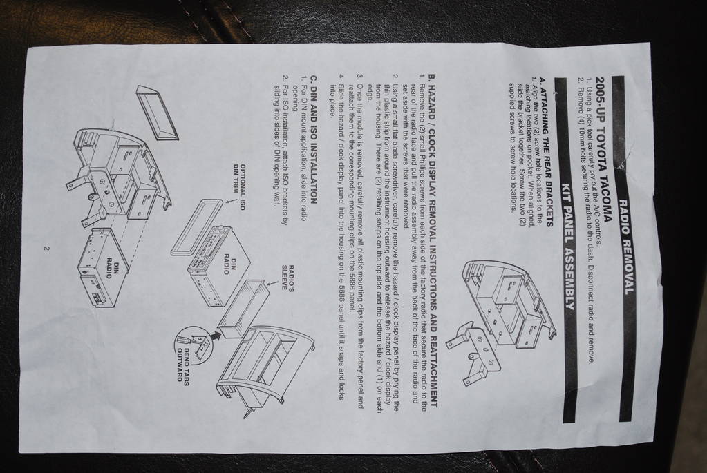

    I think mine did too. I don't remember 100% since it's been so long, but I know I read it somewhere as a "Note:" "Caution" type thing.
    Edit: Ok I just went and found the documentation/boxes/packaging from my install (yes, I keep all that kinda shit), and the Scosche kit I had came with one small sheet of install instructions. It does say to replace the mounting tabs, but not in a place you'd really expect. Although it wasn't a "Note:" "Caution" situation it's there nonetheless.
    Pic of instructions: http://www.tacomaworld.com/gallery/data/500/DSC_03992.JPG
    Side note...My kit was the single din kit, and I'd assume it's the same for double. Then again we know where assuming gets us sometimes.

    Well, it came with a piece of paper with some very sketchy diagrams, and a note that said to remove the yellow clips from the OEM unit and put them on the dash kit. So I guess you could call that instructions....

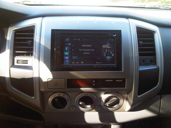

    That looks very nice., I really like you truck as well. Sell me your wheels. haha
