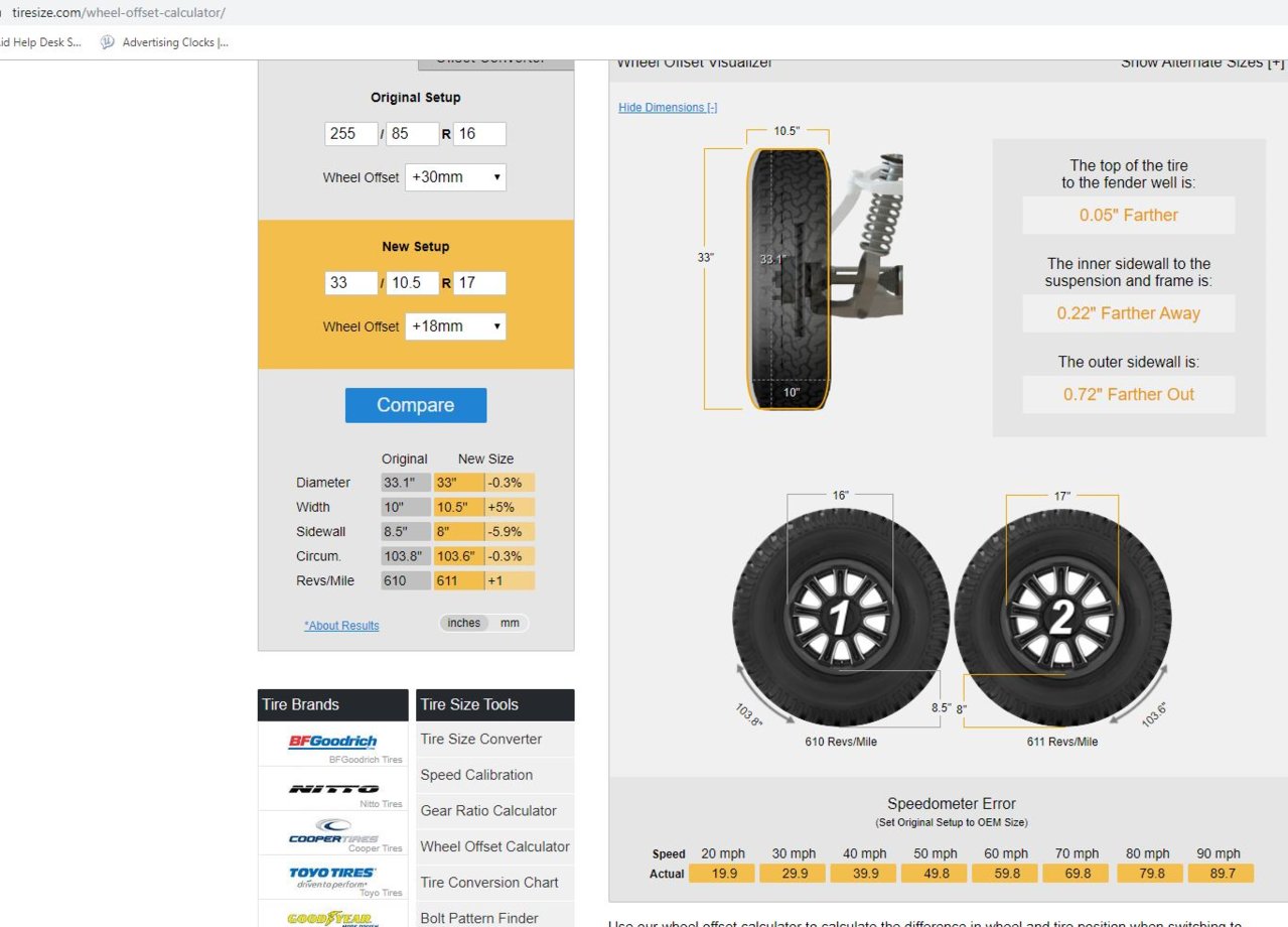

    I am trying to choose some 17" wheels for skinny 33 10.5 17" tires. I have about 2 1/2 inch lift.

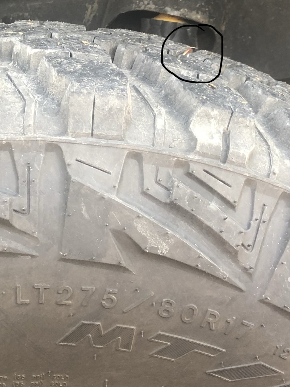

    47E4CD4F-1526-4264-855E-243DA9C501BD.jpg You guys are arguing about tread depth on some used tires and I’m over here like do 275/80/17s make my penny look small?

    Well I think I found my own answer with this awesome tool at tiresize.com. Looks like a perfect fit!

    Keep in mind, spacing out from stock offset (your +30mm) will cause rubbing

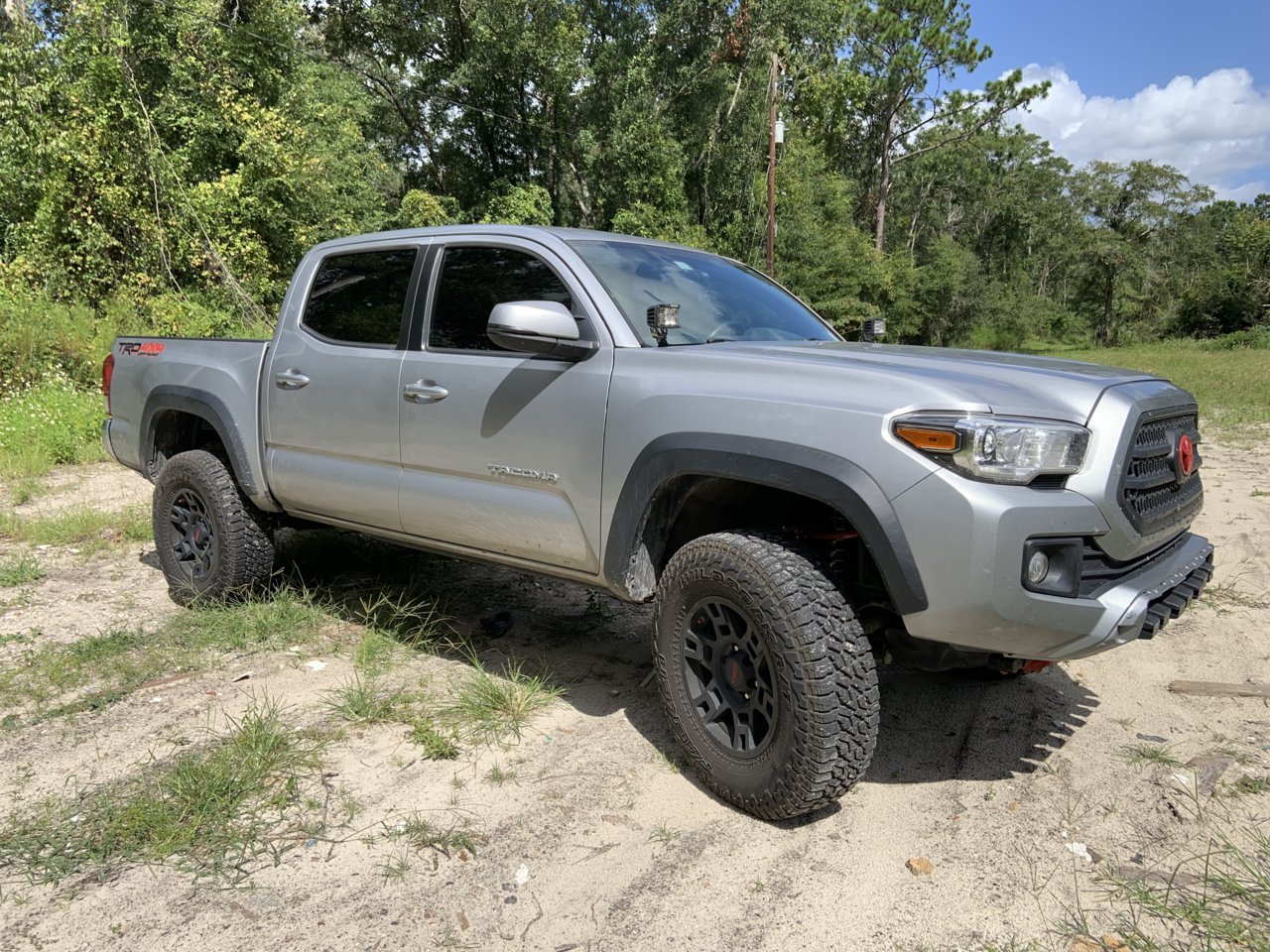

    Sorry for the late response. I did have some minor rubbing on the plastic when turning in reverse due to the offset of the wheels. My suspension is no longer stock and I love the look of the tires even more now that it sits up higher. I took them offroad in Ocala, FL this weekend and they did great in the sugar sand and mud.

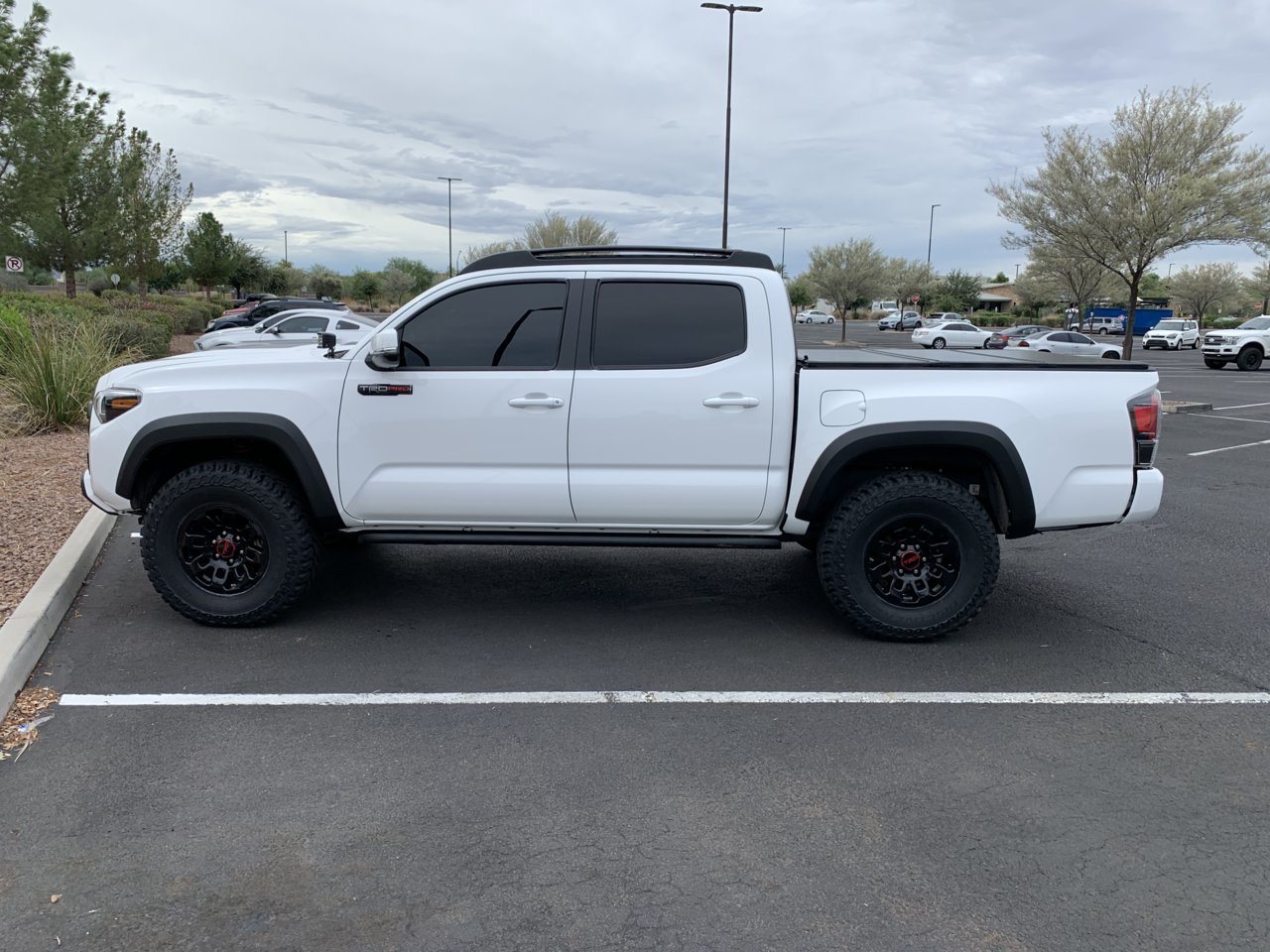

    Awesome thread! Finally Broke down and got a set myself. Couldn't be happier.
